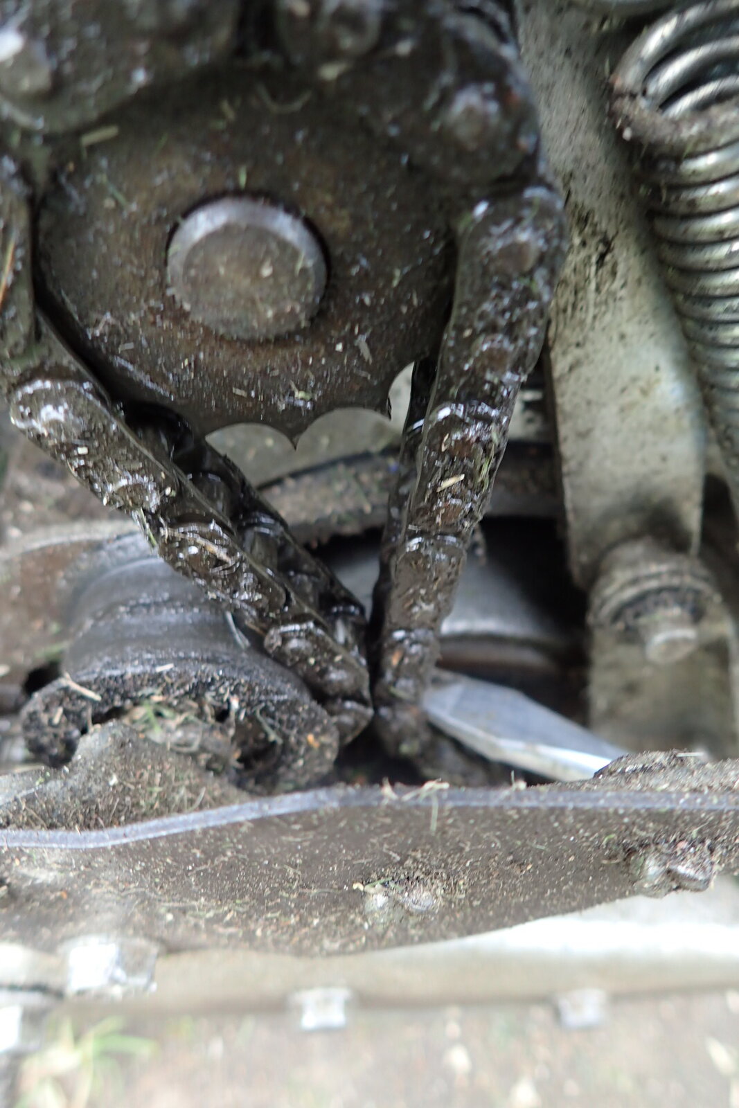

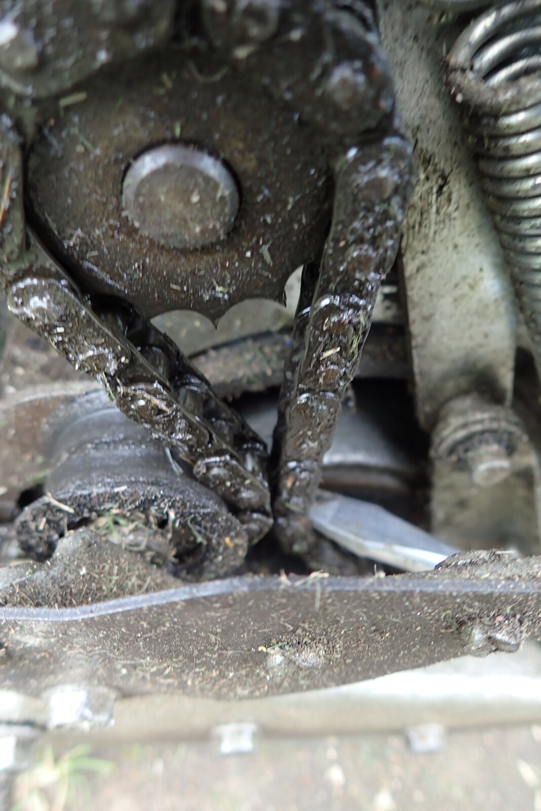

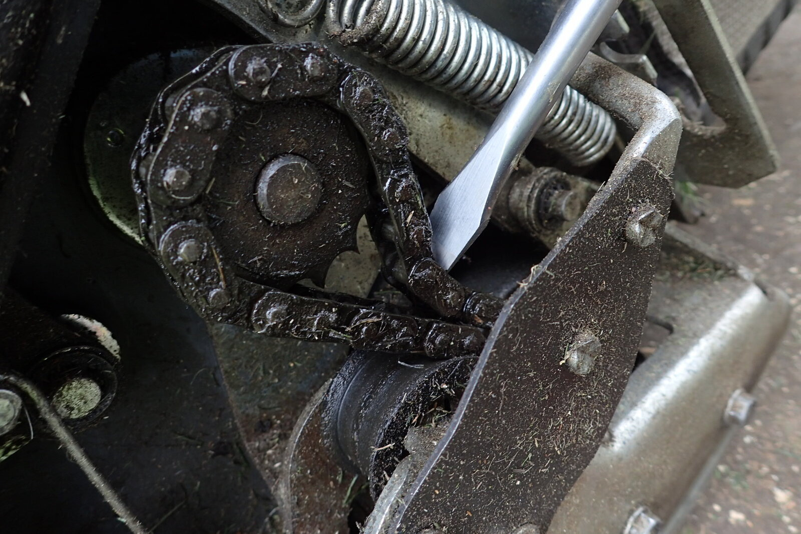

This has happen three times now, cutting my lawn.
Putting the chain back on the two drive sprockets top and bottom chain goes round two black rollers held in tension with long spring.
Tension seems OK nice and tight, would there be drive sprockets or rollers that are worn coursing the chain to throw off ??
The same happen MAY 2021, then I just refitted the same chain and spring been no bother till now 2 years later.
Could it be the tension spring needs replacing or Chain ?
Pictures of chain Push chain in to show slack is this normal ?
Tension spring refitted and is under tension.
Nipped spring ends and finished lawn chain stayed in place.

Both sprockets are desperately worn, and the chain will have suffered too!

Unfortunately I think the odds are well stacked against you here.......it's rare that I've seen sprocket teeth so badly worn!
I would doubt if there would be enough slack to pop a link out of the chain, but it's worth a try I guess.
Perhaps there is a broken machine available somewhere - ebay perhaps - but a repair with new parts isn't really viable, which is a great shame.

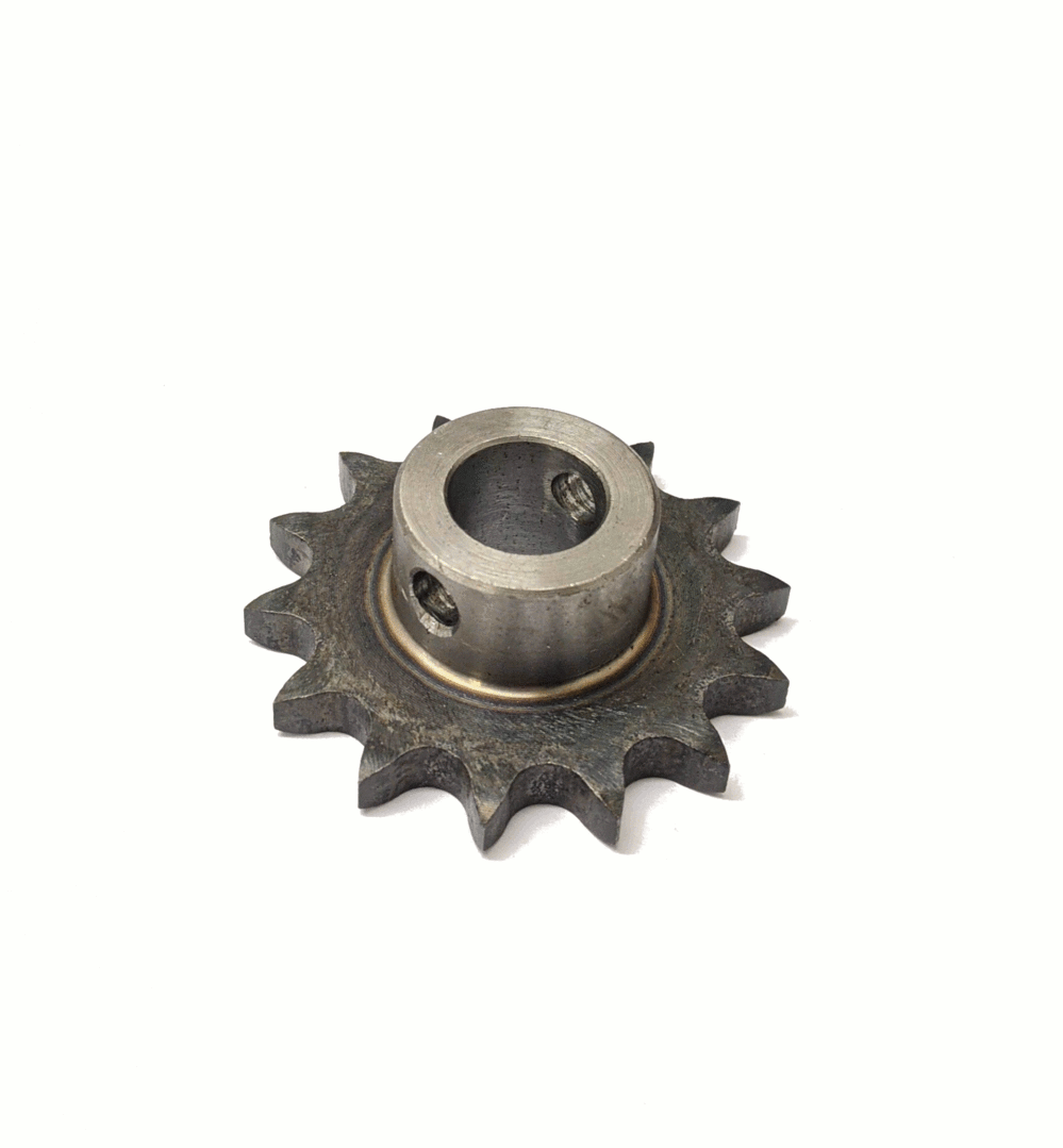

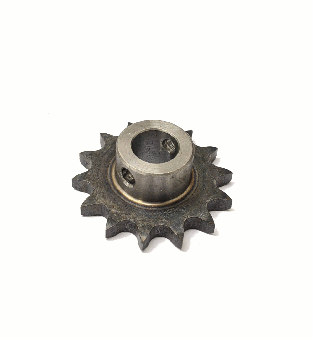

Roller Sprocket How to fit ? is there a threaded screw fitting ?
I'm pretty sure that the sprockets are held onto the shaft with a device called a 'roll pin' which can be drifted out with a parallel punch and hammer.
As with everything on this particular machine, access is difficult....I've never had the need to replace this sprocket so I can't comment - sorry, but it could be visible if the machine is completely upside down.
