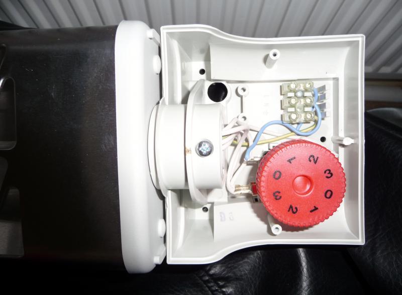

Just got a Honeywell 1.8Kw Bathroom Heater. Pictures of this attached.
I have never installed one of these and it says that I need to install/hardwire into a 13amp spur.
Now...as per the pic..this has 2 blue wires and the earth. If I wanted to connect a cable with a plug on the end, which wires go into which 2 blue neutral wires..in other words..where does the live from the plug go into which blue wire??

sorry I don't know. I would have had a look at the instrs. As it has an earth it may matter, especially as it looks to have a switch. Blue is sometimes used for low voltage controls but presumably not here.
sometimes there is N and L moulded into the casing or a diagram inside the cover

I'm assuming the wiring inside the fan hasn't been altered, as is as it should be.
The connector block shows you where the mains wiring goes to by the writing L, N and the Earth symbol.
For a bathroom, you would be better off fitting an unswitched fused spur for the heater.
Or, better still perhaps, a switched fused spur outside the bathroom, controlling a flex outlet.
As mentioned, make sure this is all in the safe zones.
