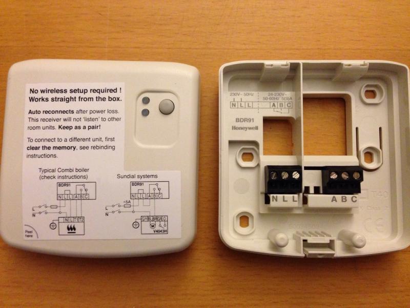

Am planning to fit a wireless thermostat to my combi boiler.
Model is a Honeywell cm927.
Receiver part
Boiler connections
Was planning on running two lengths of cable between the boiler and receiver.
This seems to save disturbing the FCU, that's already wired in to L,E and N on the boiler.
Using cable one, was planning to take L and N by joining at the boiler connection and connecting to the (left hand) L and N in the receiver. On the receiver diagram it seems to show two little lines just against these two.
Remove the yellow wire link from between boiler-1 and boiler-2 connections.
For cable two for the switching connections, connect boiler-2 to A in the receiver and boiler-1 to B in the receiver.
Hope this description makes sense.
Feedback appreciated if this acceptable.
