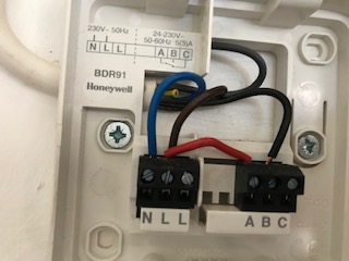

Just a follow on from the above I’ve been looking at the wiring arrangements for a possible DIY change-out of the receiver CM927/BDR91 to the T4R.
I’ve provided an image of the existing wiring also a copy of the wiring for the possible replacement.
Anyone know if these are ‘like for like’ terminal change outs?
Thanks Benny.

On the pursuit for a replacement for my existing CM927/BDR91, I have looked at the Honeywell T4R (£95) but also found a Wolseley Center device (Product code 340017) (£71), which appears to be a Honeywell device badged for Wolseley.
The former comes with a one year warranty while the Center alternative has two. There is also a suggestion that the Center device can be ‘paired’ with the existing relay unit. Anyone know if this is the case, also, any views on the reliability of this alternative?
