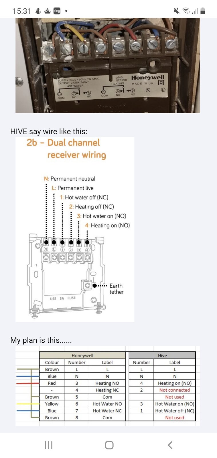

Good afternoon,
I had a honeywell st699 which I've just swapped out for a Hive.
My issue is that the heating doesn't seem to want to work unless the hot water is scheduled for the same time??
I've used the same wiring diagram as attached.
Any help would be much appreciated.
What have you done with the wires that went to 6 and 7

what did you do with the old room thermostat ? you have to link it out

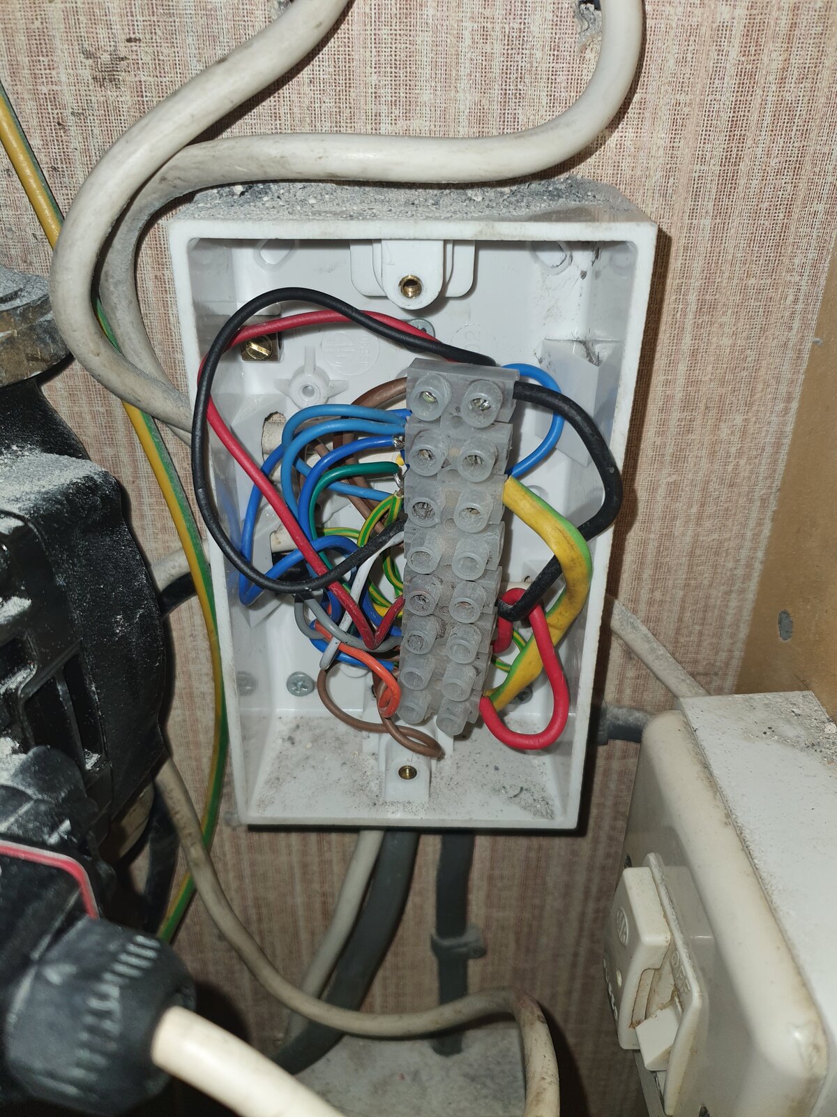

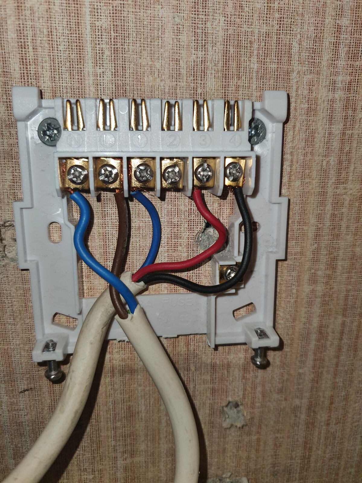

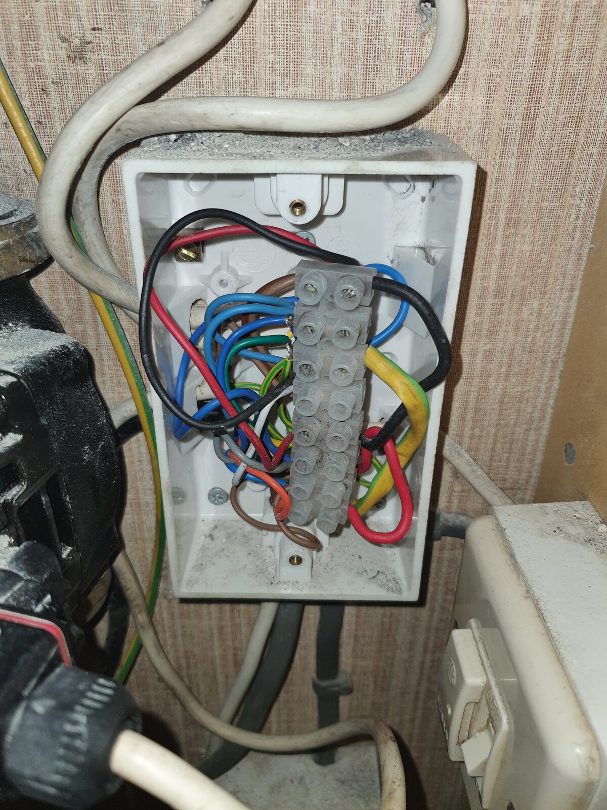

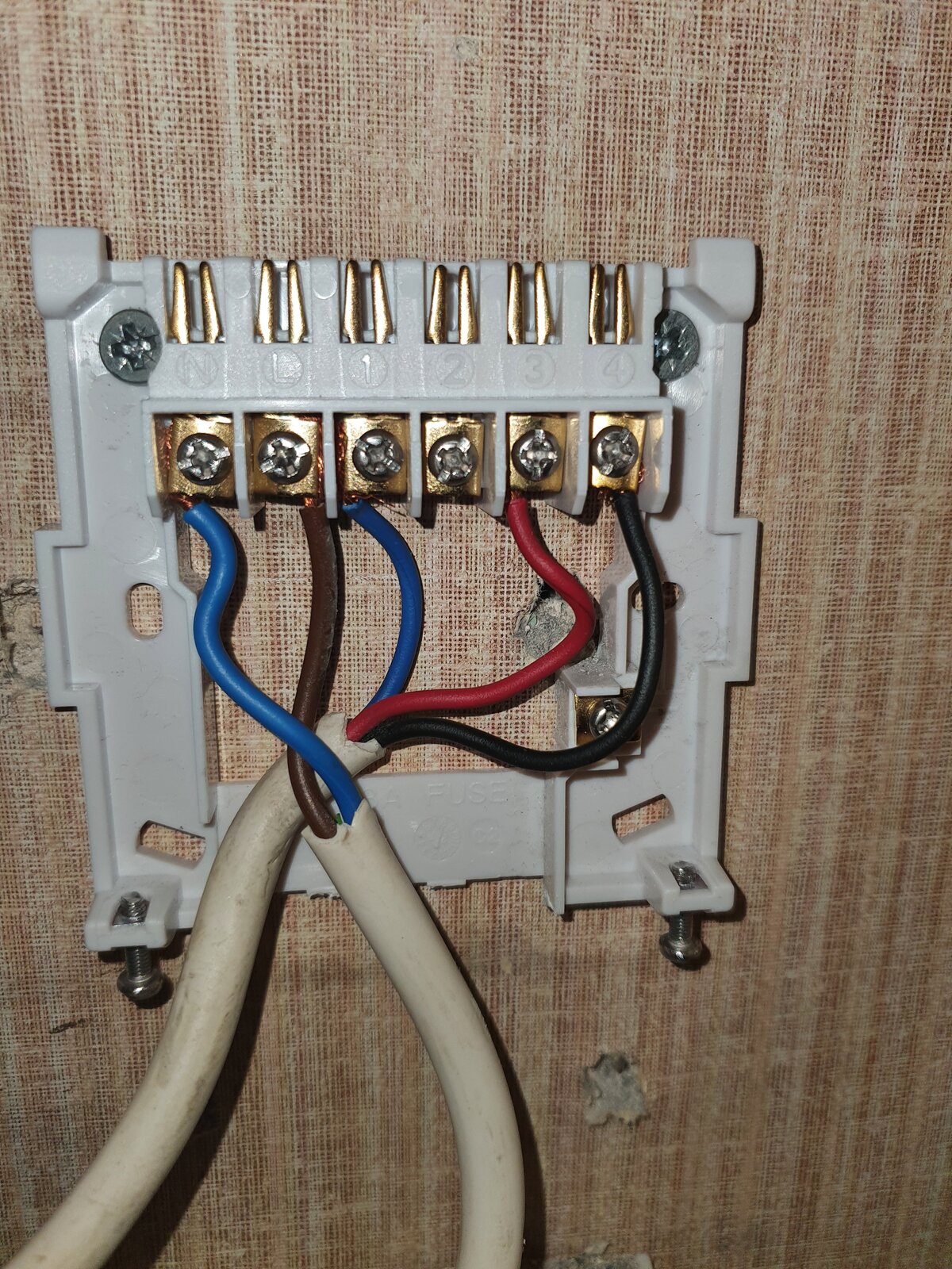

by doing this the heating shouldnt come on , you have done something wrong, do you have a wiring center ? post a pic of inside that, and totally forget wire colours they mean absolutely nothing in a heating system

Post a photo of the Hive wiring as well
Hi, I'll post both pics, but the wring centre is messy at best so I've listed the connections below to hopefully help. The connections are listed from top to bottom in the photo. I.e. the top terminal in the wring centre is 1 and the bottom is 8.
1:
Brown to Hive Live
Brown from Live switched fused spur (3Amp)
Black...runs under floor I,m assuming to Boiler?
2:
Neutral from supply
Blue to Neutral terminal Hive
Blue from Pump
Blue from switched valve
3:
Earth from Supply
Earth to boiler?
Earth to Pump
Earth to switched valve
4:
Black to terminal 4 Hive
White to valve
5: unused
6:
Red to terminal 3 Hive
green/yellow to HW cylinder stat
7:
Blue to terminal 1 Hive
Grey to valve
Brown to HW cylinder stat
8:
Brown to Pump
Orange to valve
Blue HW cylinder stat
RED TO BOILER
Hopefully this makes sense
