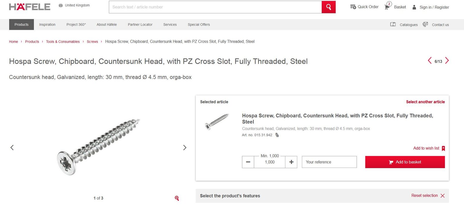

I read that hospa are the go to for kitchen units/ chipboard but i am finding it tricky to find them so what alternatives can i consider I am looking for 30x4.5
Not found Google yet then?
Perhaps I should of been clearer. I should of said local.
By that I mean screwfix toolstation b&Q ect. Looking on ebay and amazon strugling there too for the size I need 4 or 4.5 x30. And on either there are hardly anyone selling. screwure.JPG
Even the link you gave to the hafele site do not have the size - so I looked in normal steel as your link was stainless steel and yes I can buy them but min 1,000 screws I don,t mind 200 but 1,000 and I have to sign up to get prices. -- Struggling you see.scure.JPG

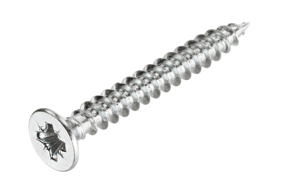

I'll disagree with you on that point - Hospas are the go to in the kitchen trade simply because they can be driven straight into MFC withgout pre-piloting but with minimal damage, unlike cheap screws. They also come in BZP finish as standard. So no, any old screw isn't as good and many screws burr up or burst the melamine coating on carcasses.
The best alternative in terms of performance is probably the Reisser cutter (although they aren't quite as good IMHO), but with the caveat that getting those in BZP finish often isn't that easy, either. You can generally pick-up smaller quantities of Hospa screws from sellers on eBay, but as they are normally a kitchen trade supply, unless you have a kitchen component supplier locally who is willing to supply to non-trade, you will most likely be out of luck. In my experience Hospas aren't something a builders merchants or ironmongers stock, although I do have one trade ironmonger in Manchester who can get them to order next day (however, in trade box sizes)

Which is partly why kitchen fitters tend to use Hospas...
