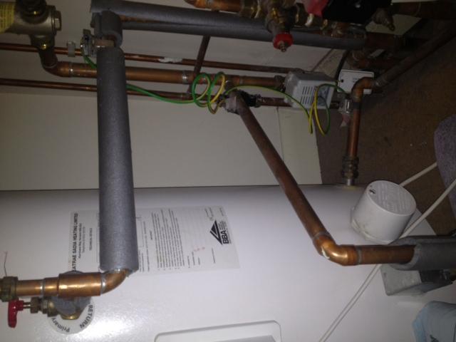

There are two 2 way valves, one on the bottom of the Cylinder (Honeywell) and one labelled as central heating valve.
when we turn the CH and HW off, the Central heating valve actuator moves but the Honeywell one at the bottom of the cylinder doesn't.
Could it be this one, should this valve move when turning the CH and HW on and off?

Here's the layout in the airing cupboard, you can see the Honeywell valve at the bottom of the tank behind the pipe, the Drayton Valve is the white one, it seems to open and close okay but the Honeywell one doesn't move.
Thanks.
Forget about whether you can see the valve moving(The Honeywell valve lever usually does not move) More likely to be the white valve that has the sticking micro switch. I only say that because Honeywells are more reliable. Its simple to test if you have a multimeter.
