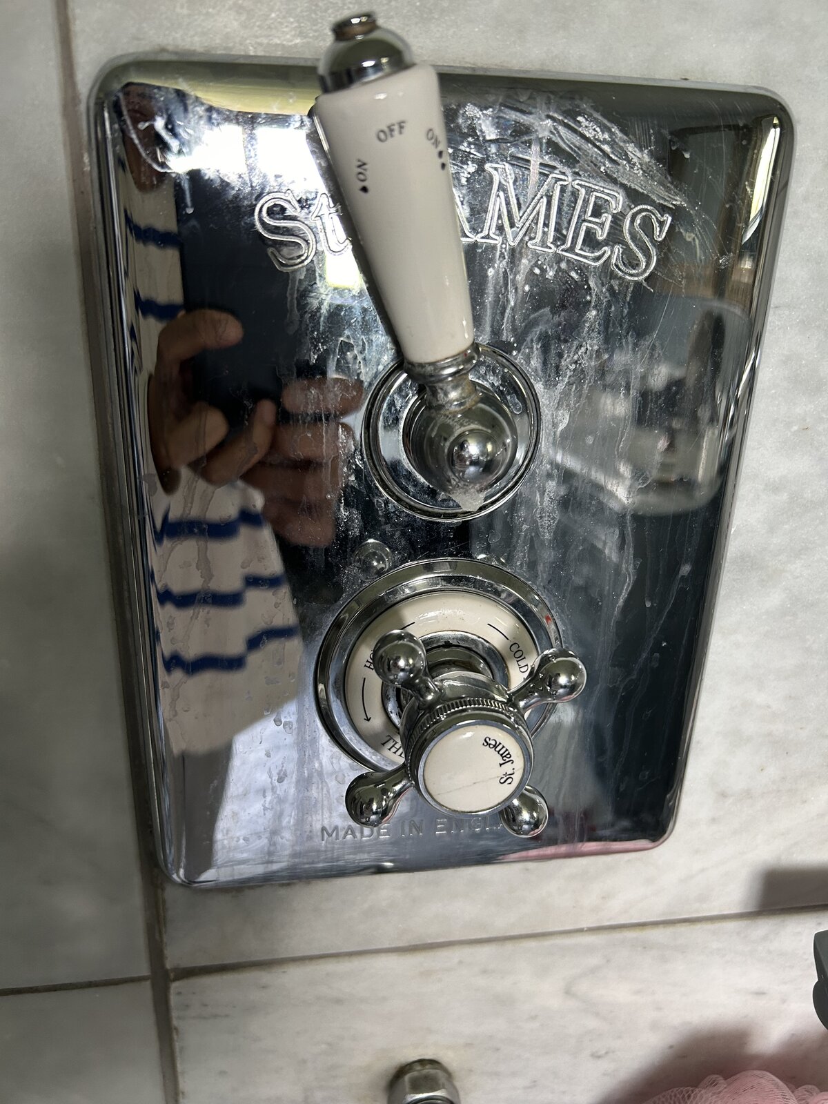

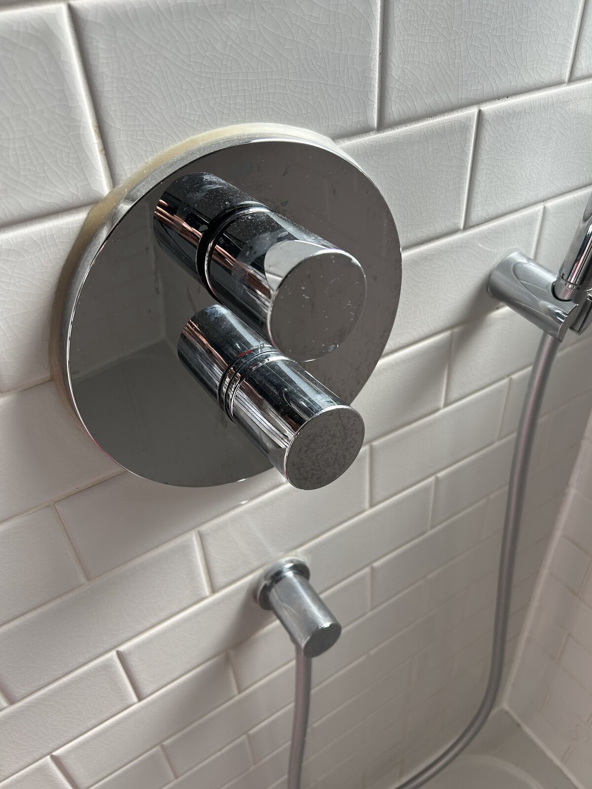

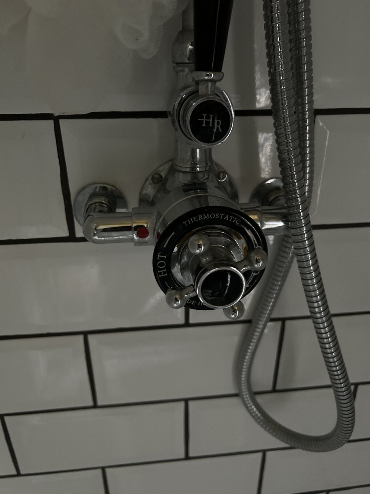

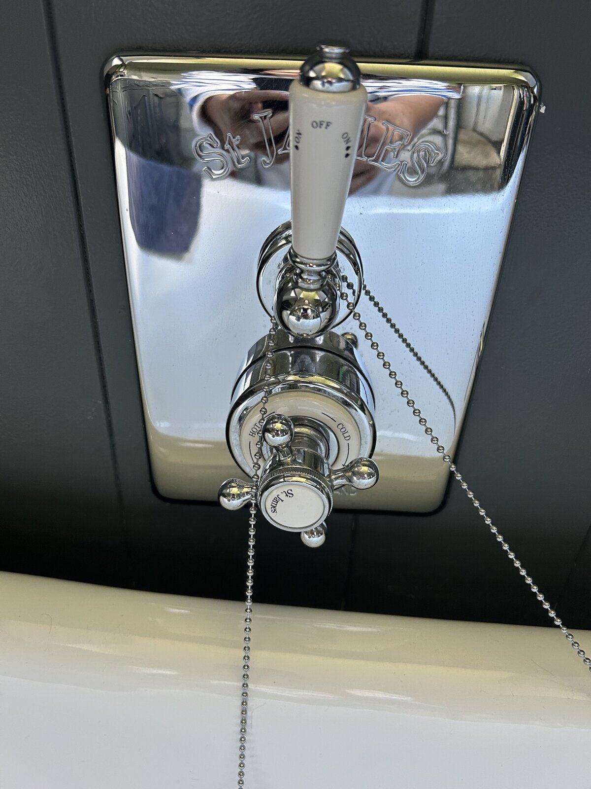

IMG_5800.jpegIMG_5799.jpegIMG_5798.jpegIMG_5797.jpegOkay so you think it's definitely a shower mixer not any basin mixers? I'm adding some pics as we have concealed mixers on two showers and a shower mixer on the bath as well - no pipes are accessible as they are all behind tiles or panelling. I think one shower has the exposed valve?
Start with the easy exposed one. Run shower till body is hot, usually on left hand side.
Run a not so hot tap. Cold water flowing through the shower will rapidly cool the LHS of this shower.
If it is not this one then you will have to repeat by pulling the faceplate forward on the concealed valves and getting a finger in behind to feel the connections. I would do them one at a time starting with the one nearest to the problem area.
That putting your ear to temperature control knob while tap is running is worth a try.
