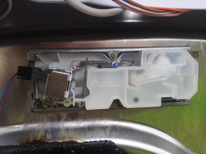

Anyone know how this machine knows the level of the rinse aid?
Exposed the rear assembly by removing the front door panel but no sensor present like you would expect. Just the tablet drawer actuator, 2 wire connection, which is used to activate both the tablet drawer and the rinse aid plunger.
The machine does have a rinse aid low indicator.
I had explored the possibility that the whole dispenser assembly had been replaced with the wrong/different part, however the lack of any spare wiring and nowhere for any additional wiring connections on the pcb's to connect to lead me to believe it is the original genuine assembly.
There are no boards located anywhere near the assembly so not integrated onto a board.
This really has me puzzled.
