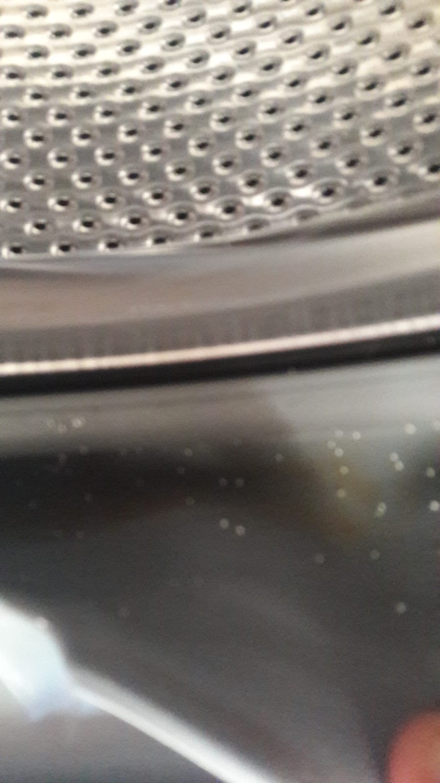

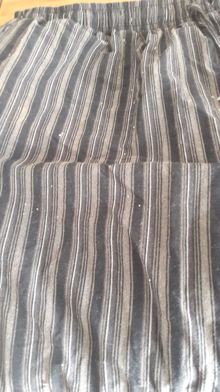

Hi all,
Got a strange problem here. Having just done a whites wash fine, I used the same powder to do a darks wash and, after the cycle was finished, I ended up with tiny white deposits on the clothes.
The little white deposits are also in the washer itself, particularly on the rubber seal
I then tried a 'fast wash' - the particles remained - then a normal (2 hour) wash but the white particles remained.
The washing machine has a 'cleaning action' button so I tried this with no load in the machine to see if I could get red of the white particles but this was unsuccessful too.
My feeling is that the particles must be 'undissolved' washing powder but, given that I used the very same powder for the whites wash immediately before, I'm kinda stumped.
Anyone got any idea what's going on here?
Thanks, Chris.

MYSTERY SOLVED!
Thanks for all the advice guys but my girlfriend has just found the answer.
A pillow (used mainly by the cat) had developed a tear and the little white deposits were nothing more than PILLOW STUFFING!
A clear case of making the poor assumption that the deposits were washing powder.
Thanks once again John and Johnny,
