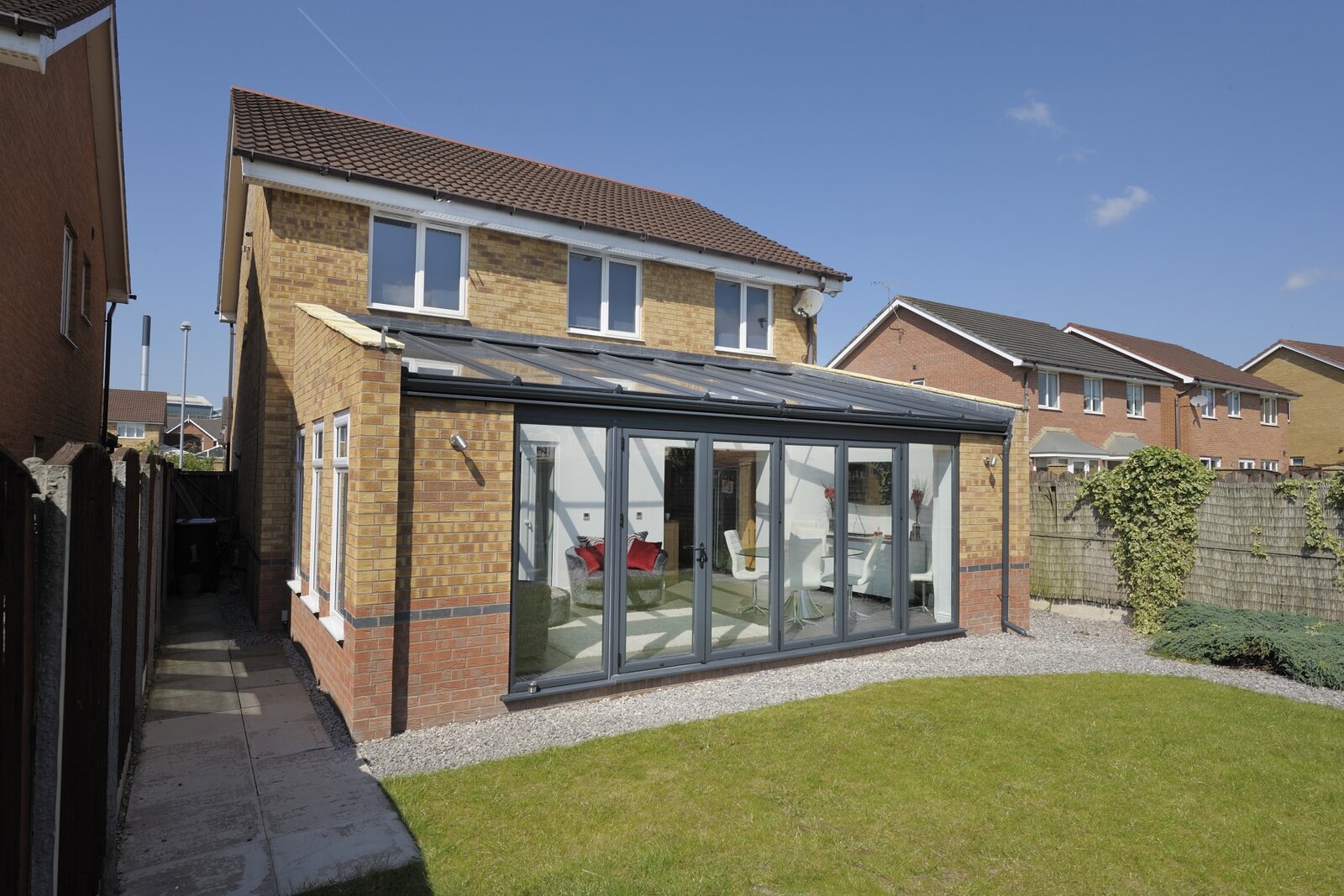

Thanks for all the advice. We’re gonna have a lean to glass roof so no guttering on the side see example photo attached (please ignore the flank windows on the side).
We’d be happy with 1mm like woody suggested so will chat to the builders about it.
Just on PWA, we just don’t want to spend the time and extra £3000 on it.
