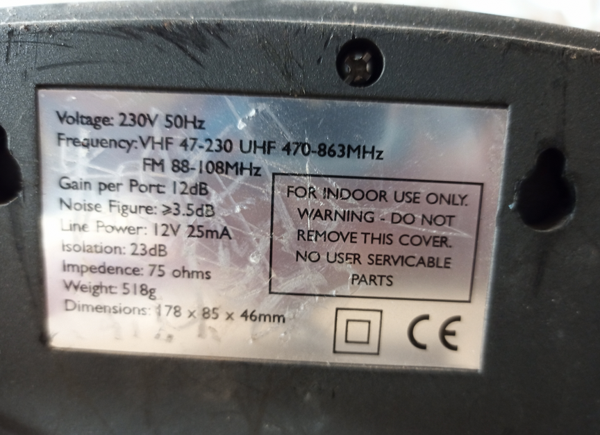

.... 12V 25 mA ....
Well, if that is remotely like a fair indication of how much power it actually 'draws' from the 230V supply, then that 0.3W (i.e. 3,333 hours for 1kWh) suggests that I probably wasn't far off when I suggested that the running costs would be "trivial" :)
Kind Regards, John
