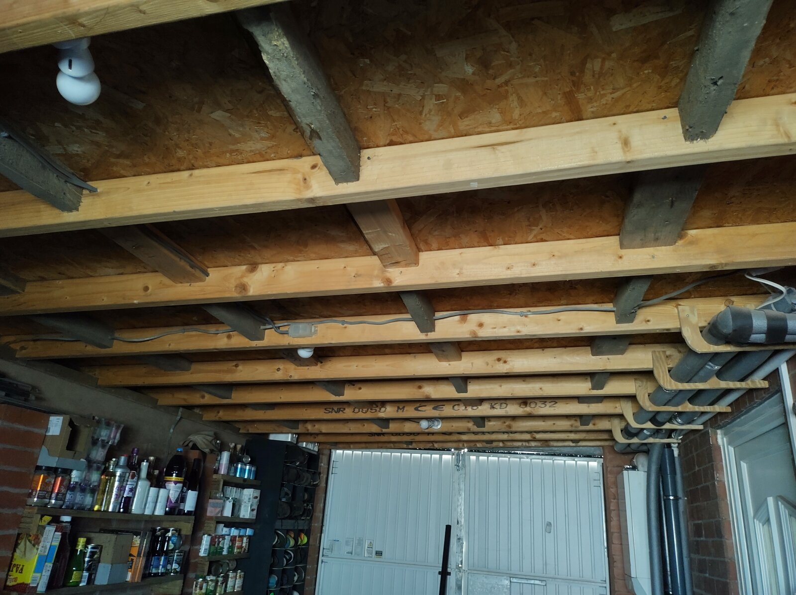

My garage roof span is 2.8m, joists are 4x2 @ 450mm centres. The deck is 9mm OSB with EPDM on top. I believe the joists are considerably overspanned on paper but in practice are fine. I (17 stone) can walk on it no problems.

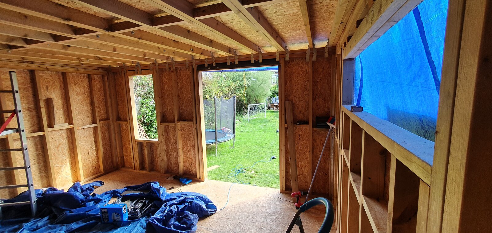

Thanks to everyone who has replied and offered advice, it is much appreciated. In the end I went for doubled up 4x2 - 5 coach bolts in each - at 400mm centres. When I was putting on the edpm roof membrane it felt sturdy up there and whilst I was up there a mate below saw very little bounce in the rafters. Photo of rafters attached but pleased to say the build had come on since then and is nicely watertight.
