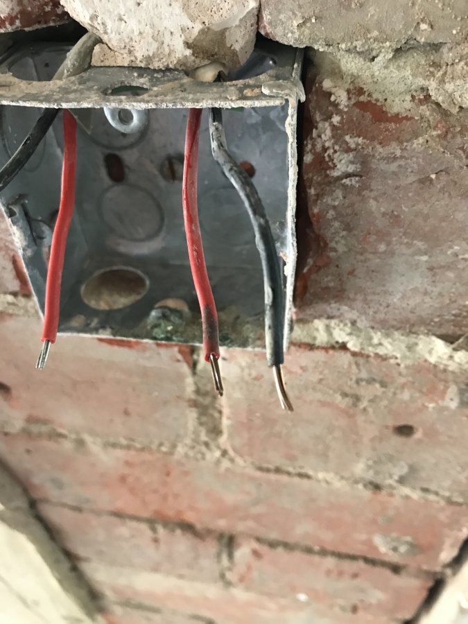

How old is this cable?
Surprised nobody mentioned the absence of grommets on the back box...
Mate look at the state of that backbox. It's like someone has battered it with a mallet.
It's all gonna be re-done properly. :)
No mate lead is definitely worth more now, at least at my local.
Just checked. £1.10 domestic cable, £1.10 lead. Even stevens currently. They seem to have swapped over month on month as to which is more valuable, on the off chance it's 10p more per kilo when I go for a weigh in, it's not worth keeping separate.
