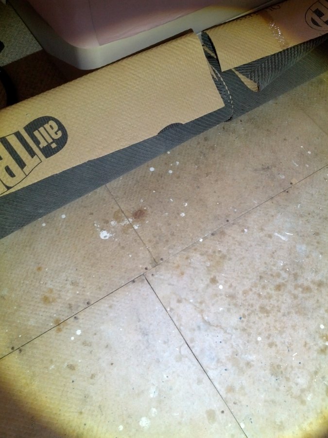

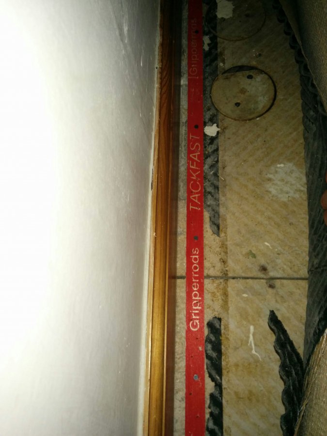

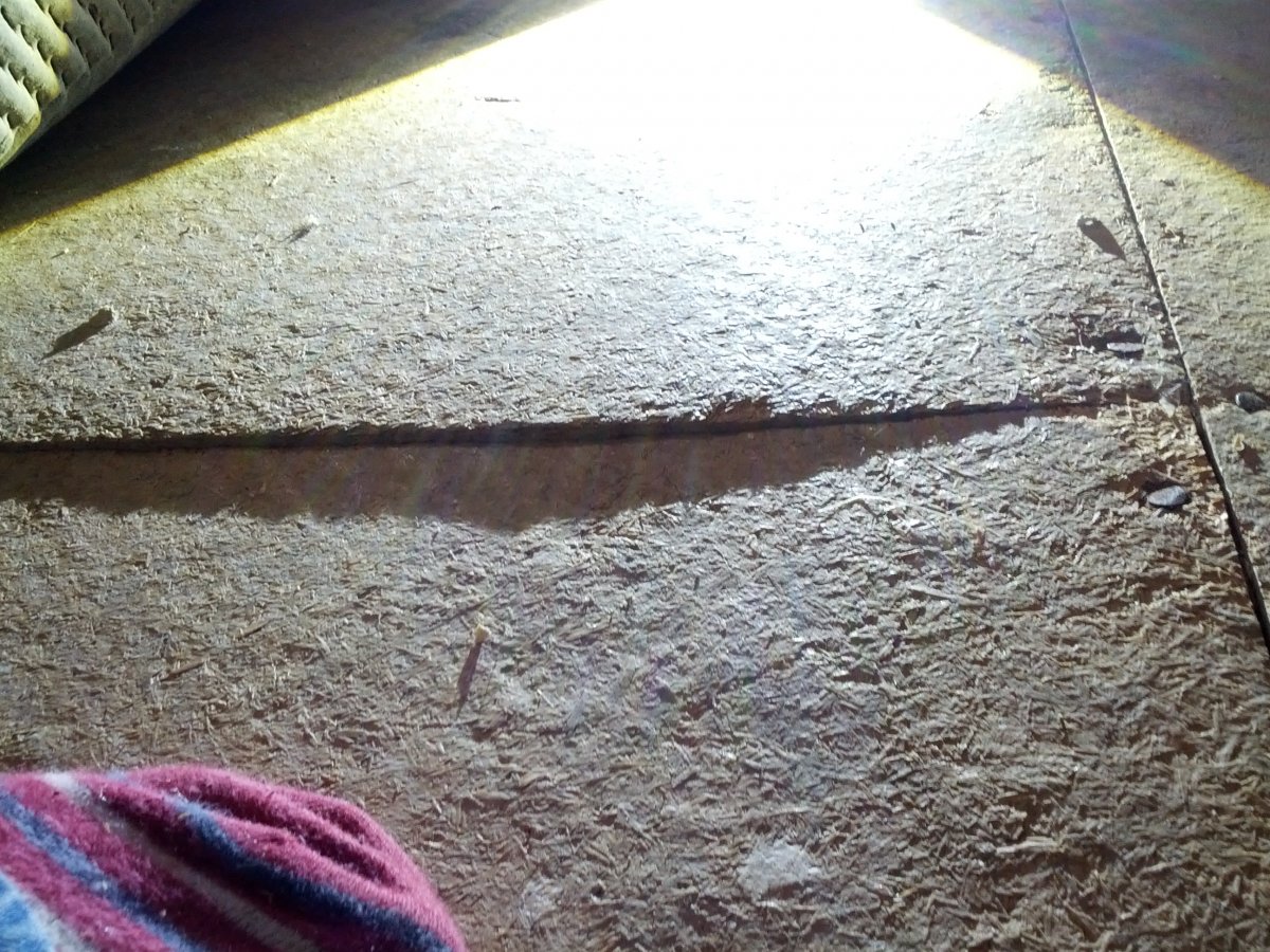

Finally had a chance to look under the carpet.
There is an awful lot of give in the boards which look to have had some damp problems.
My intention is to approach it in a similar way to this:
http://www.fitmywoodfloor.co.uk/bouncy-squeaky-chipboard-floor-replaced-with-structural-ply/

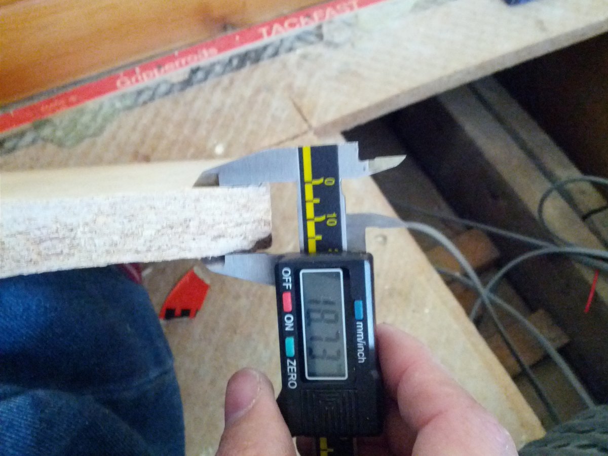

I found a couple of access panels for when the previous owners rewired the place. I found the average width of boards is just shy of 19mm, and the minimum width was about 18.5mm. So I have to imagine that the floor was originally 18mm, though 19mm might be a better fit.
I can't see any 19mm at Wickes so.
  • My plan is to get a bunch of 18mm Spruce plywood (unless you have a better suggestion).
  • Cut around about 40mm from the wall (like in the post linked above) and put joist hanger supports at the new joins (as above)
My questions are:
  • Will it being raised a couple of mm around the carpet gripper be a disaster?
  • Can you/Should I get 19mm boards?

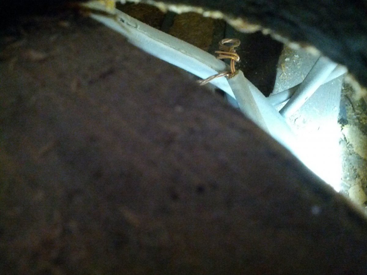

A couple of pics for your amusement - including a wire that scared me, but assume is nothing important...
Any replies appreciated!

The bare solid cable looks like a 10mm power cable. If its dead then terminate it in a box or at least wrap it in insulating tape: kill the consumer unit before doing anything with the cable. Dont attempt to pull it out unless its very loose.
A few mm's wont make much difference.
18mm is what you want.
