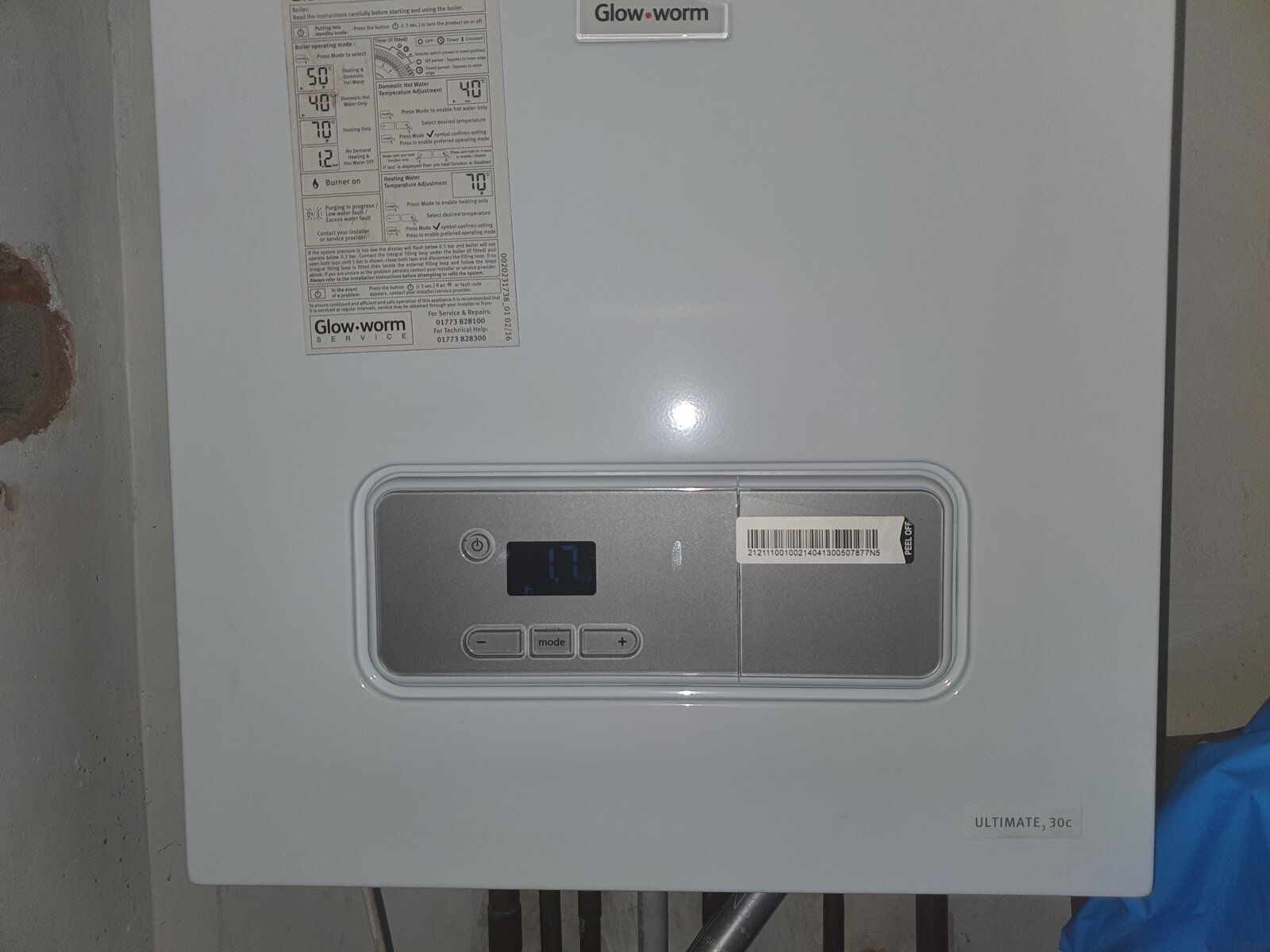

I have a boiler:
Glow Worm Ultimate 3 30c

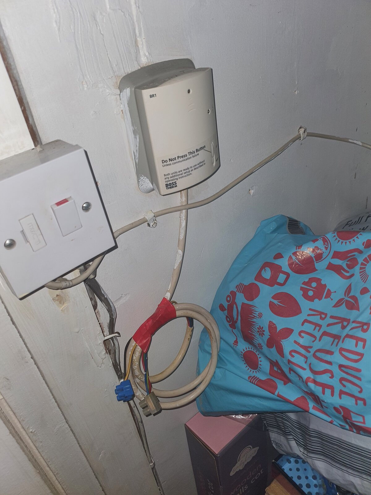

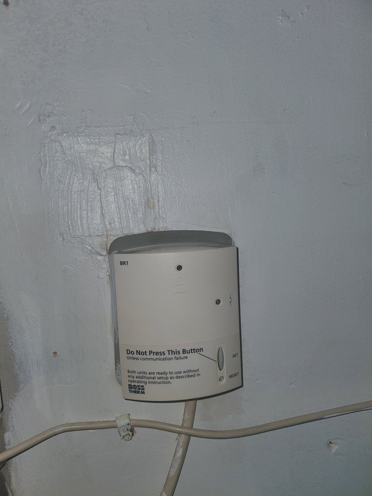

There's a thermostat that was clearly plugged into an old boiler:
Boss Therm BR1
And the remote that's compatible with the thermostat.
Is there anyway, either including this kit (or something else, Hive?) I can get this up and running?

The existing stat was probably disconnected due to not working
It's a re badged Siemens were known for failed receivers.
Looks like you have everything you need for replacement so Hive would work.
I would check with a multi meter but looks like earth live neutral the 2 wires on blue connector block stat switch wires.
Sorry, just to clarify:
That cable comes from the Boss therm device, not the boiler itself. I don't believe it's connected to the boiler in anyway at the moment.
How would I go about hooking up to the boiler?
Where does the cable that exits the boss therm terminate? Is it the connector blocks?

Anyway just buy a cheap timer and wire it in using the instructions. Ignore the receiver. Leave it where it is.
A std timer has power to it (L,N,E) and a switched (timed) live to the boiler live.
The thermostat just sits between the boiler and the timer.
You need to draw out the existing system and wiring, then look at the wiring diagrams for std timers etc and it's easy enough.

Yeah, so the cabling and block in the picture comes directly from the receiver. There's only one cable coming from the boiler itself (power).

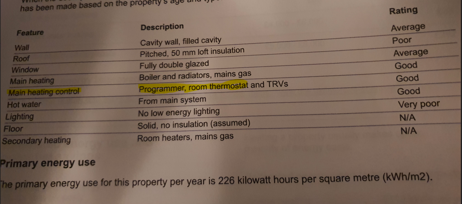

This got me thinking, so the boiler has a 2016 stamp on it - Building regs post 2018 should mean new boilers are fitted with a thermostat (or just TRV? not sure). Can I prove when the boiler was fitted? I have a gas safety cert but it just suggests a gas sleeve be fitted, doesn't mention install date.

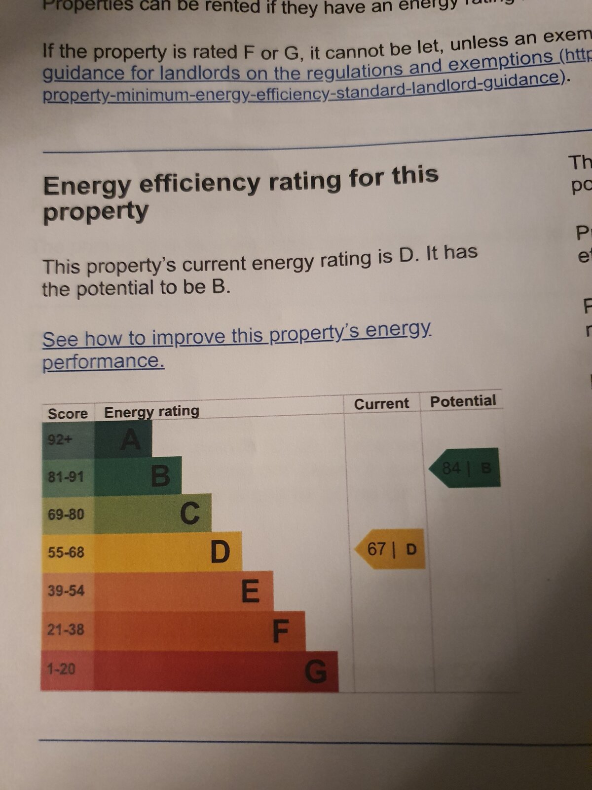

I've checked the Energy Efficiency Rating document I was given, the property is listed as having a programmer and room thermostat! .. I'm a little bit peeved off right now..
What should I do about this?

Go back to the landlord/letting agent and tell them that there’s documentation stating you have a thermostat installed, there’s one on the wall (you now have photographic evidence) and ask them to reconnect it.
Opening up certain boilers, may disturb what is part if the combustion circuit and isn’t your responsibility as a tenant.
