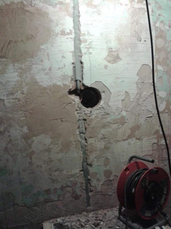

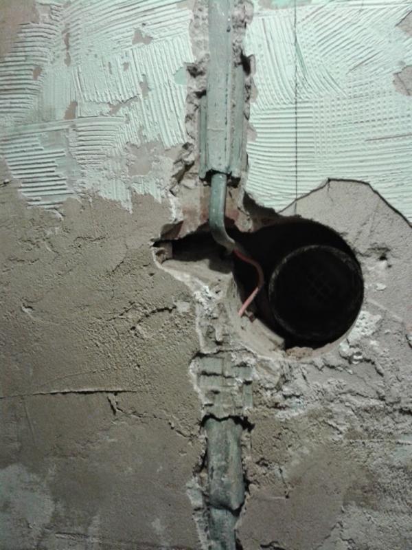

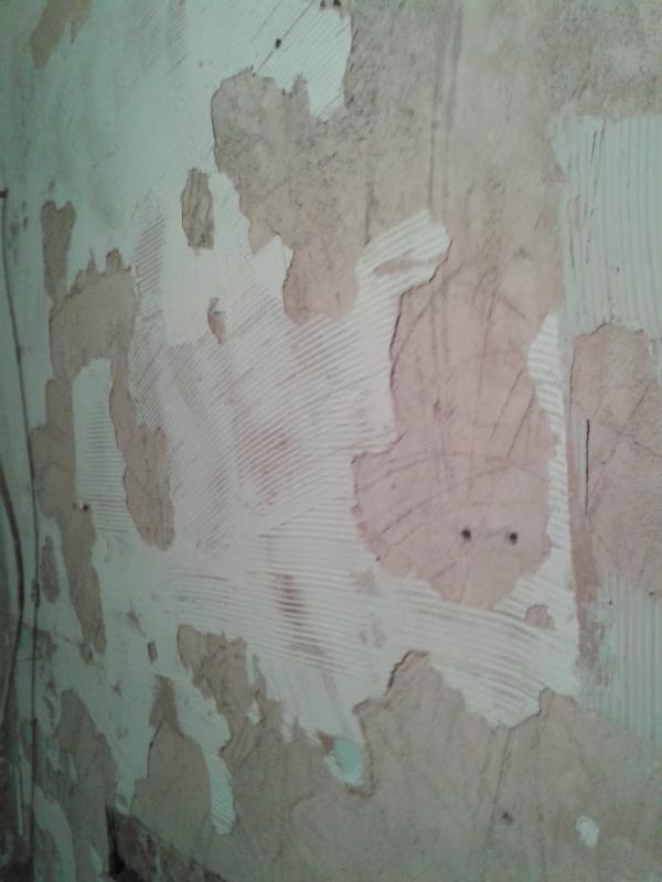

Hi
What would be the best way of filling in this cooker extraction fan hole so it makes it easier for the plasterer? Its single brick - cavity - single brick.
The cable you see is dead, which is just as well for the person who drilled it originally! I will be removing this as well.
The plasterer might want all adhesive scraped off, or even the plaster hacked off back to the bricks. Has the plasterer seen the kitchen?
A semi-dry mix of sand and cement 3:1 will dub out any significant "holes" etc. Apply it in layers if necessary. You can buy small bags of S&C at any plumbing suppliers.
Is the wall solid or cavity?
Remove the cable and capping top and bottom back to any connection device and/or CU. Dont leave wild bits of cable that could cause mischief later.
Thanks.
I haven't had any plasterers around at all yet and the walls are pretty much like this for the whole room (small kitchen). Is that a problem do you think? I was hoping the rough bits could be 'patched' (my word) over, then skimmed by a plasterer
As you can see yourself, the adhesive is brittle and the chance is that it will come away with any overskimming.
Typically, whats req'd for skimming is a clean and firm background.
Post pics of your kitchen - perhaps this difficulty is only at backsplash etc. areas?
These are the only photo's I have until I get back from work later.
All the walls are fairly solid except the bit around the extractor hole - this will be covered anyway with cooker splashback. There are some ropey area's but will take some pics later tonight

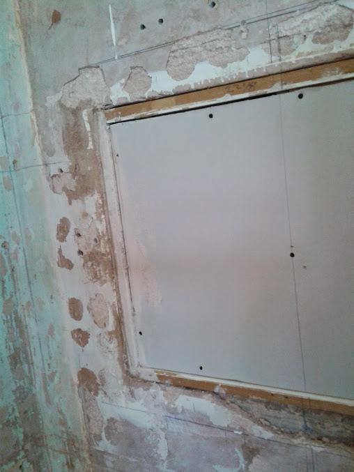

The old serving hatch - I have covered with plaster board
Regards

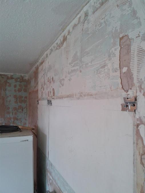

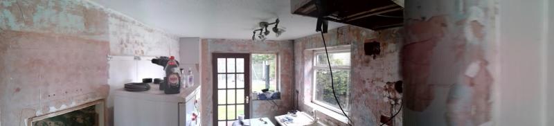

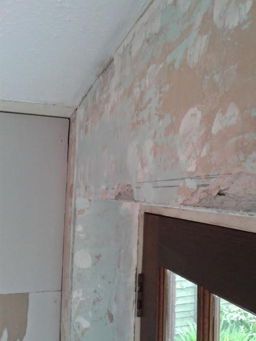

Ive upped a few more pics, if anyone could comment upon the general condition etc.
I was hoping that when I get a plasterer in, he could simply plaster over the rough bits, do a bit of tyding up & skim the whole room. Looking at the general condition, does this look ok?

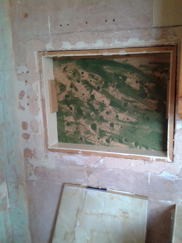

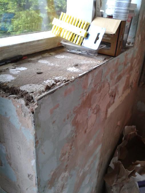

Looks like some wallpaper left on in the last pic. This must all be off before any plastering.
Also serving hatch may need some attention. Mixture of materials. May be ok with some EML fixed across the wood perimeter before skimming. See what the pros say. I've not tried this before and an educated guess!
Pic 3 with the broken edge will need reforming before skim.
Mixture of paint and fresh plaster with some broken areas may require a bonding agent (eg WBA) rather than just pva before plastering.
I'd get whichever pro you select to advise on any prep first. Otherwise may do it wrong.
Generally doesn't look too bad to me.
There is some old wallpaper that can come off no problem. The serving hatch is interesting - Ive put some plasterboard within the existing wood frame - assuming this can be plastered/scimmed. Dunno
Guess its time to get some quotes.

As DIYNewbee says,you need to check with whoever you get to plaster it.
The pics suggest it's not a quick run around patching before a skim, if you want quality.
Remember a skim is only designed for 2-3 mm although can be put on heavier.
Looks like it all needs at least a tight coat of bonding to get it ready to skim.
