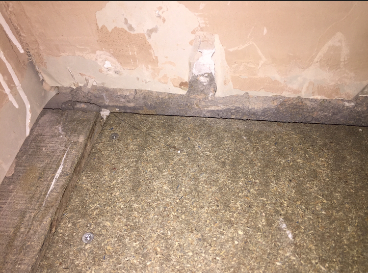

So I just had a new chipboard floor glued and screwed in after adding noggins and levelling the joists. There are gaps between the edge of the chipboard and the blockwork, up to 15mm. There is a gap between the dot and dab wall and the new floor of up to 40mm high amd 30mm deep and also the void underneath the dot and dab.
I want to seal the floor and walls to maximize sound insulation and draftproofing. I was going to use acoustic mastic for this but these gaps are too big at the base of three of the walls. What is the best practise to seal these gaps ? Thanks

For the linear gaps you could use Lots of tubes of cheap solvent free brandless 'no more nails'.
For the cheap stuff I suggest the Wickes version.

I think that might crack if I filled between wall and floor, not very flexible. What about expanding foam tape? Could that work to seal air gaps in the floor/wall?
Great. What should I be most concerned about? I have no idea what the relative risks of these materials is. I know expanding foam can emit isocyanates which sound worse than formaldehyde, but have no idea if a new chipboard floor itself is more hazardous than filling a gap with expanding foam around its perimeter...or what the time scales are for emission of their VOCs
