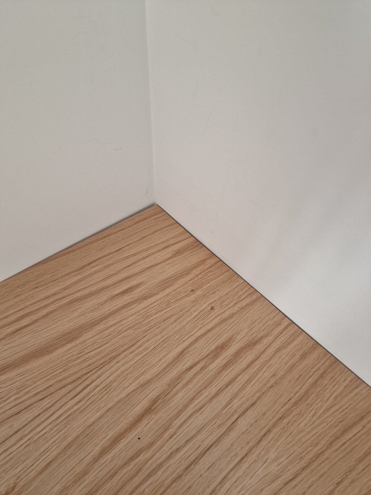

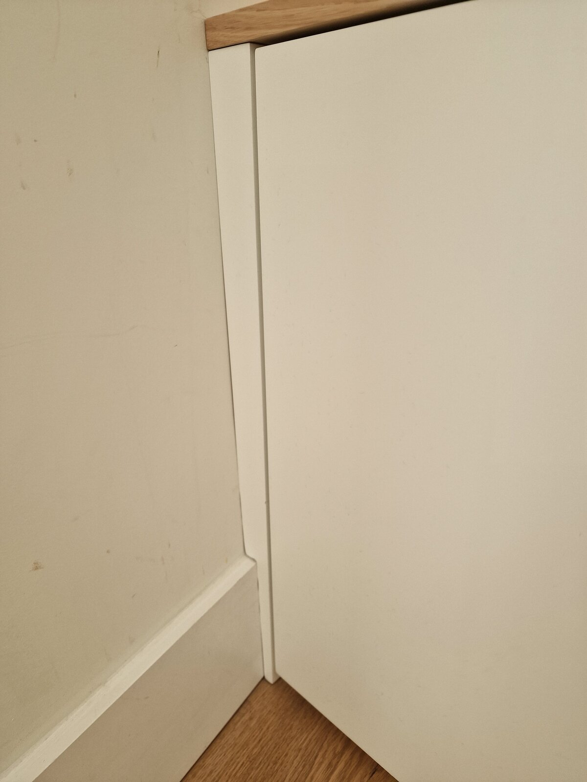

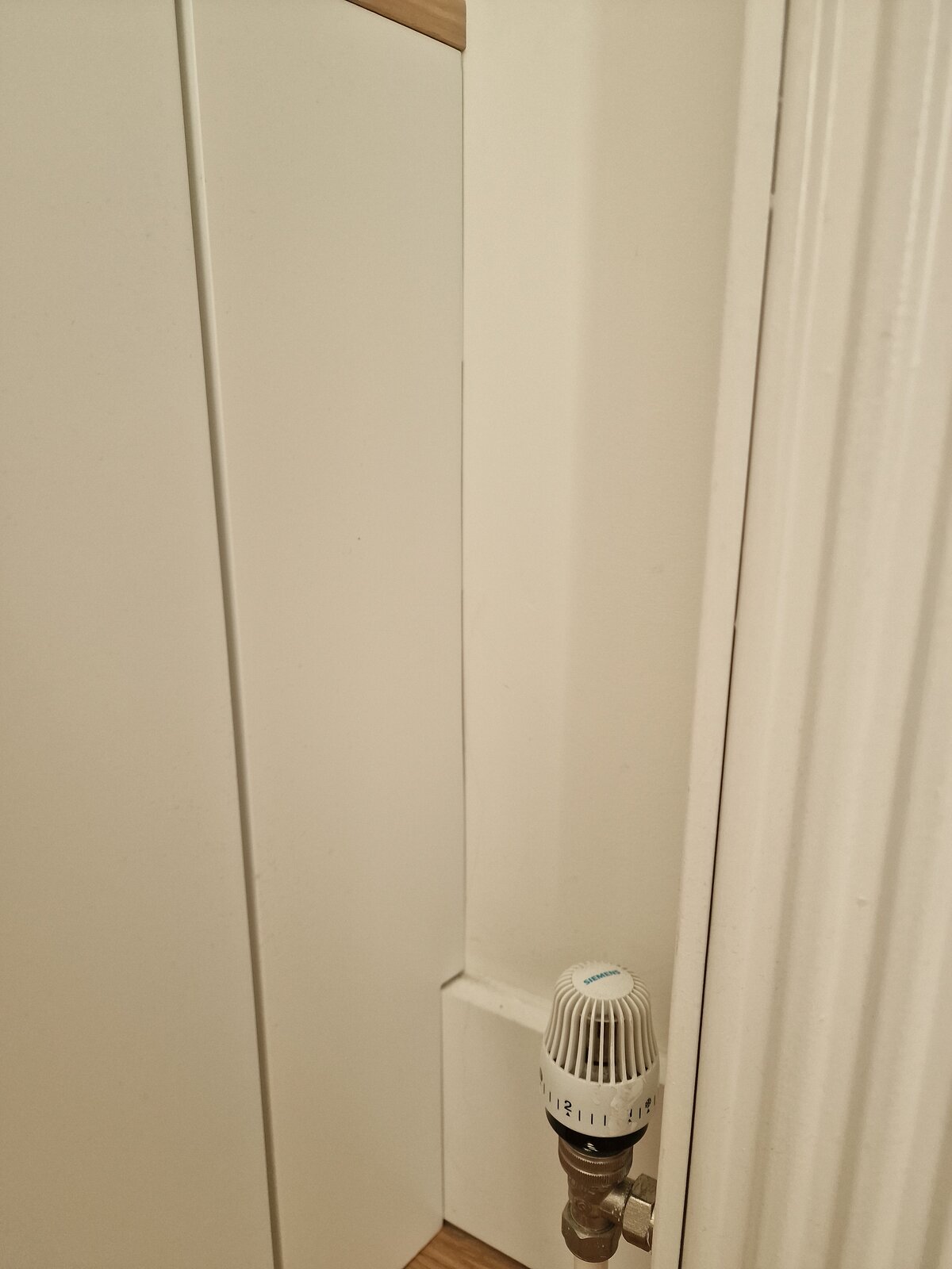

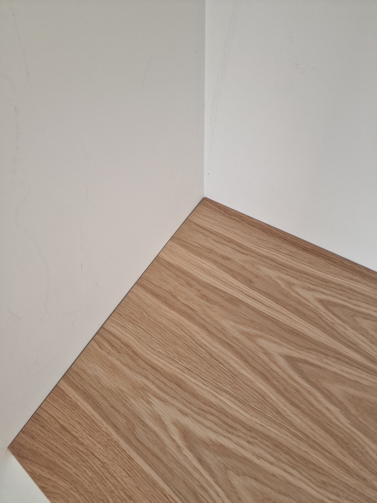

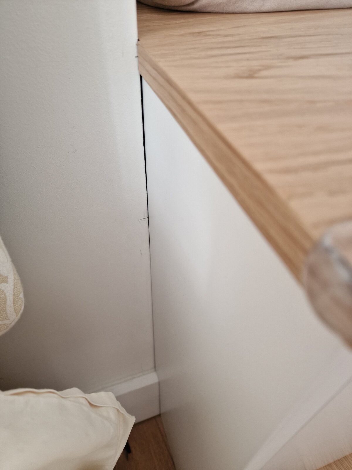

My joiner left a few unfinished gaps in my two bedsides.
Being a bit of a DYIer I asked him what should I fill it in, caulk or silicone, and he said either. I am thinking of silicone because of movement (building's 120 years old). Would that be the right choice?
Another question: material aside, white silicone on top of the shelves, transparent, or brown?

Silicone is going to be a mare if you plan to repaint in the future. The paint will not adhere to it.
I would go with caulk, but if you want something more flexible, look at a MS Polymer such as CT1.
