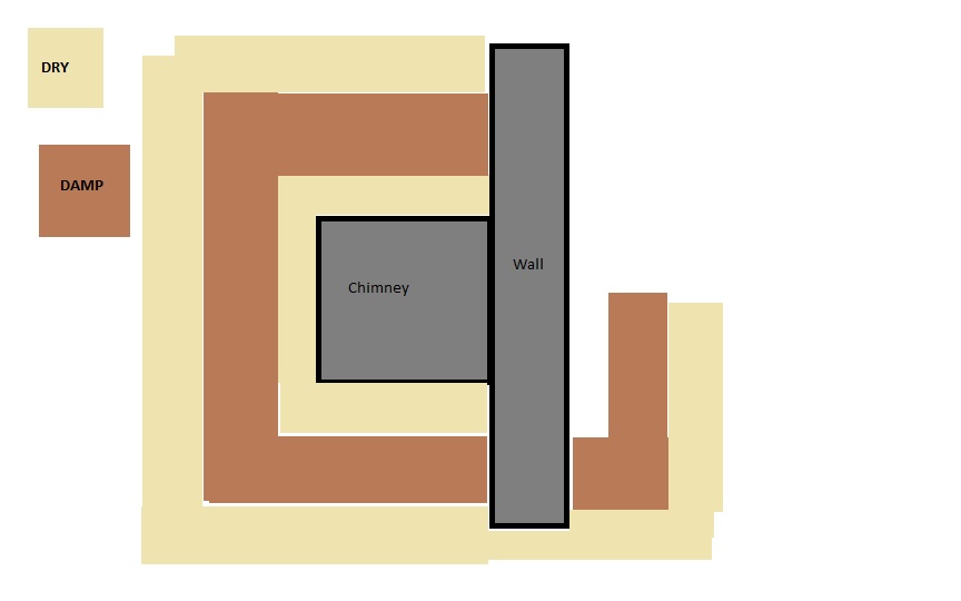

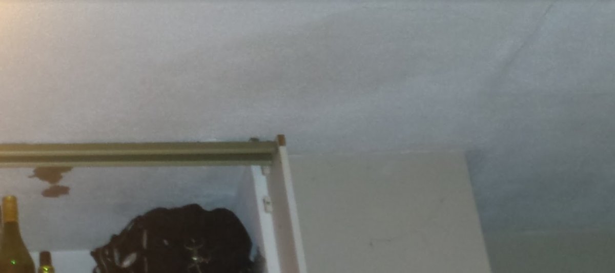

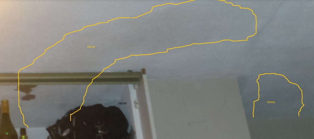

We moved into our house in March this year. Recently I noticed a shadow on our upstairs bedroom ceiling near to the chimney breast. I had thought it was a shadow from the lampshade but I inspected it a couple of days ago and found that it felt cold. I have a damp meter so I started to prod around and found that the meter goes off the scale (33%). I tried to find the outline of the damp area and it seems to surround the chimney breast like a halo/ring about 6-12 inches wide even going over the bedroom wall and into the landing area. I went up into the attic and found that the back of the plasterboard is damp and I can see a defined outline of the dampness. The area that is damp seems to be pretty well defined. Within the area sends the meter off the scale but move it about half an inch outside the region and it goes down to below 10%, which seems to be the standard when I check areas I am confident are dry, nowhere near the ceiling.
However, what confuses me is what is not damp. The area of ceiling directly around the chimney of about 3-6 inches is not damp at all. The chimney breast itself is not damp above, nor below the ceiling. The walls that contact damp parts of the ceiling are not damp.

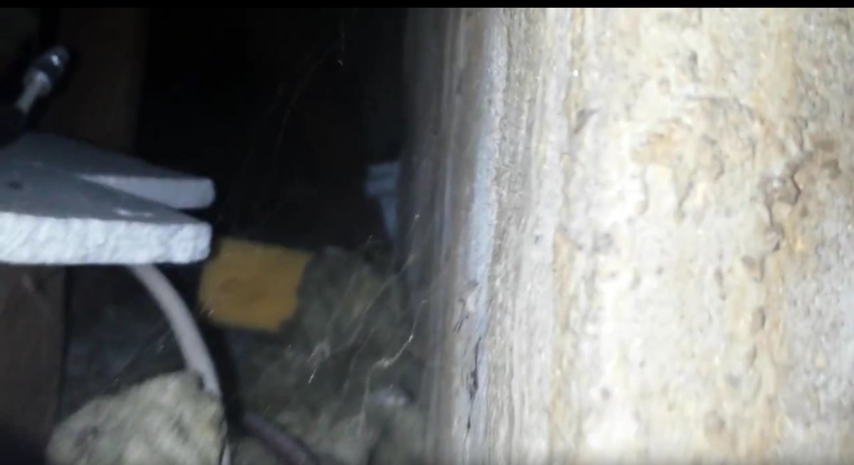

I went into the attic to investigate and I cannot work out where the source of the water is. I haven't yet been able to get around to the front of the chimney but I have been able to get to some of the damp areas and inspect them. All wood I can see in the roof looks fine. My damp meter registered the plasterboard as being damp but the wood next to the damp spots was very dry (I did notice that it does seem to have about a mm gap though so not sure if that is why). The insulation material also felt dry. The chimney breast was dry although there were a couple of dry brown water trails on one side but they may have been there for a long time. There are no pipes at all that I can see above the plasterboard.

I don't have any photos as yet but I've attached a sketched image to hopefully help.

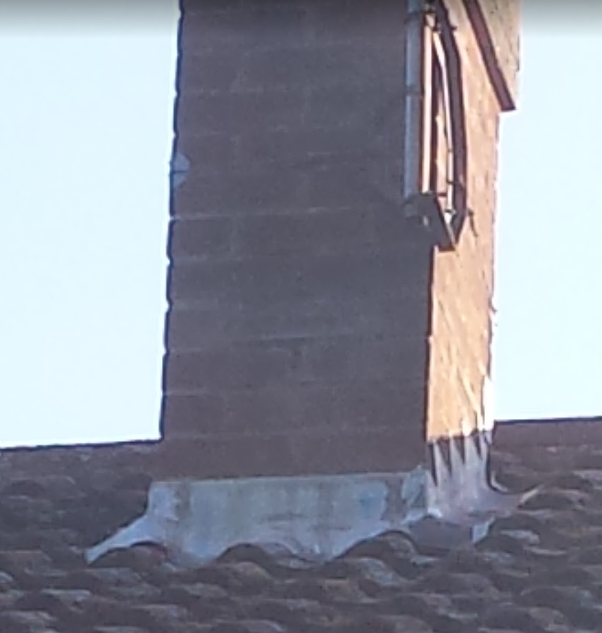

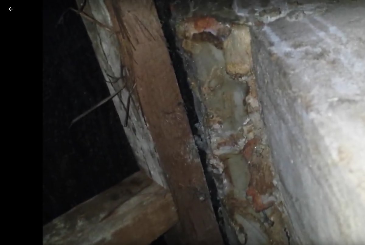

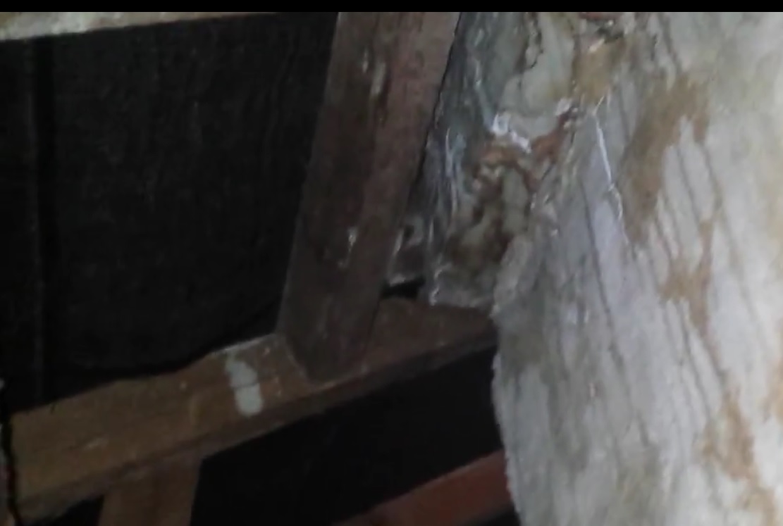

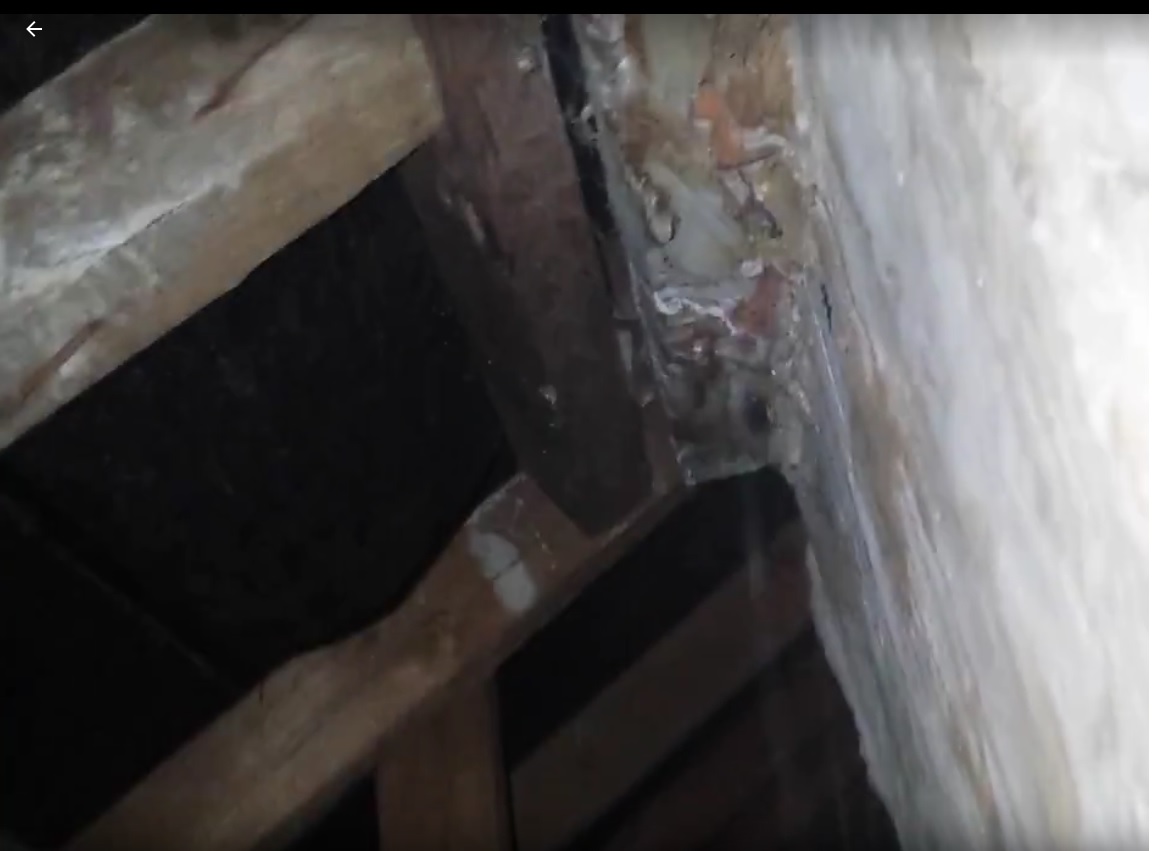

I think I've found a leak. It's not raining so I can't be certain but I managed to get my camera around the front of the chimney, where I can't reach, and some of the wood in that area is a white in places and the front of the chimney looks like water has been coming down it at some point. I guess this looks like the flashing has failed?
I also did some more checks around the ceiling and although I though the damp surrounded the chimney I've found that the damp area seems to be focussed near the front of the chimney and then spread out to the sides. There then seems to be a gap and another smaller damp patch towards the back. I'm not yet sure what causes the one to the back. I'm hoping it's the same cause and that getting the flashing fixes should sort it out.

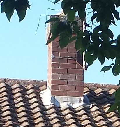

Why not post pics of the loft chimney (you already have these pics), the lower chimney breast damp areas, and the chimney stack from the ground?
Determine if you have a flue liner?
Does the chimney accommodate more than one fireplace opening? ie. how many terminals are on the stack?

The ceiling picture actually stands out more than it looks in person.
The pictures from the ground are from the summer. I can take new ones tomorrow but I'm not sure anything has changed and believe this to be a long term problem anyway.
How do I know if I have a liner? I know there is a metal cowl on top like a GC1. There is only one fireplace and terminal.

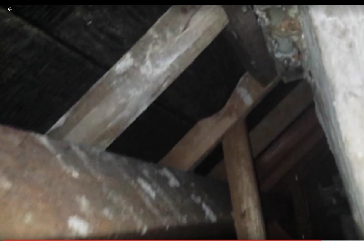

I'm still a bit unsure what is happening. The white on the wood seems to mainly be on the short joist (is that right?) directly in front of the stack and on the front surface of the piece perpendicular to it near the stack but only on one side. Also, the ceiling marks are not just below that area but spread around most of the stack through the plasterboard. I still don't understand how I have damp plaster at the back of the stack, dry areas of plaster next to the stack and no water leaks down the breast walls.
I can also see a bit of felt in topfront.jpg that seems to hang down a little bit near a small white patch. I don't think the main leak is there but could be another one.
I'm starting to worry now that this is a major problem due to the rot and I'll need extensive, costly repairs. Once the leak is fixed, how do I get that wood replaced? Is it half the roof off?

Based on the pics i would say that you have a minor problem with water entering thro the flashings or by by-passing them.
There's no evidence of rot.
The chimney construction seems to be of concrete blockwork up to the roofline, and then in brick. Why you have the curious brick projection clearly seen in pic 73.8KB i dont know - its obviously heavily water stained. Does this brick projection return on all four sides of the chimney?
A GC1 terminal often connects to a flue liner.
But you need someone on the roof examining the flashings and flaunching. Perhaps the stack needs re-pointing but its difficult to tell.
The projection is on the front and backs but not the sides. I really don't understand. From the roofline our chimney is identical to all the others in the terrace so I don't think it's a custom thing but no idea what it is. I have contacted a roofer/builder who has worked for me before so hopefully he'll get back to me soon. He had previously advised getting the flashing done but I didn't do it at the time. I'll probably get the flaunching flashing and repointing done just to be sure.
Does the small piece of white in the beam near the slightly lower felt look like a separate leak or just another exit from a flashing /flaunching leak?

I can see how the back of the chimney as an original source makes sense because there seems to be a smaller patch of damp at the back of the chimney and then a larger arc around the front of the chimney. To have any damp at the back I'd have thought that it must at least come in higher up the roof because water doesn't normally flow up hill :) (I am prepared for someone to tell me that this is not the case with roofs). I guess some comes out at the back of the chimney breast and the majority migrates around the breast to the front where most evidence of a leak is. Or there are two.
