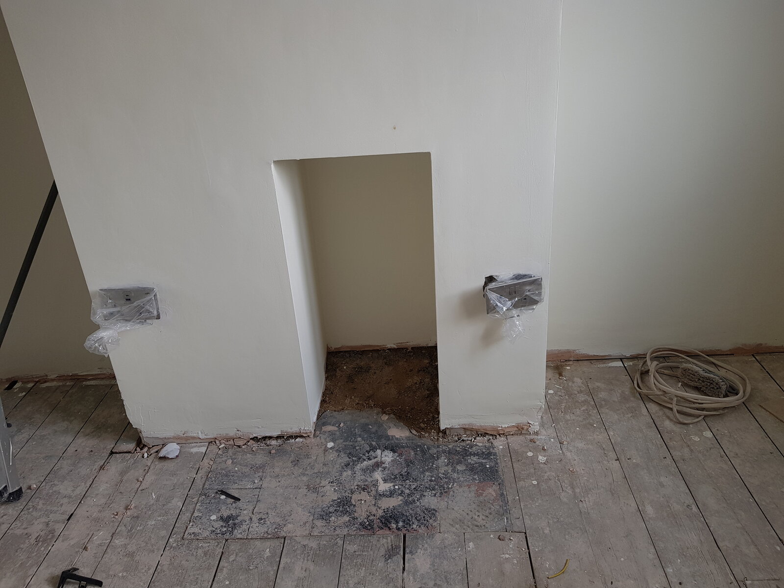

Please find the attached images -
Have to finish this before flooring starts in a week's time. I am a DIY'er and need suggestions to finish this please ? Note that the place is bit uneven (higher height on the inner side close to the wall.

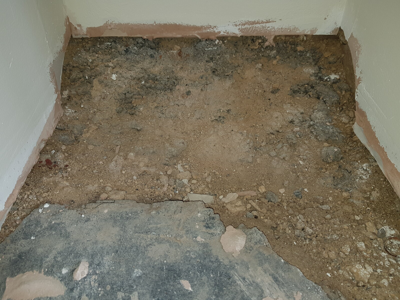

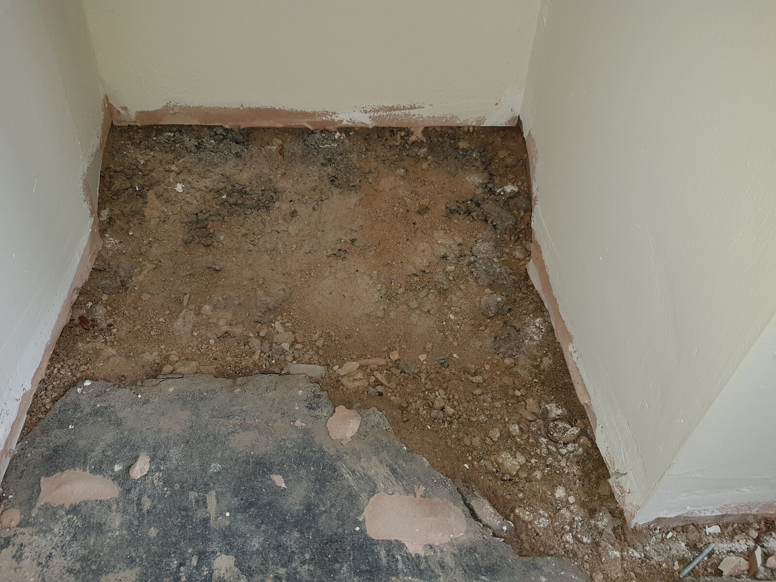

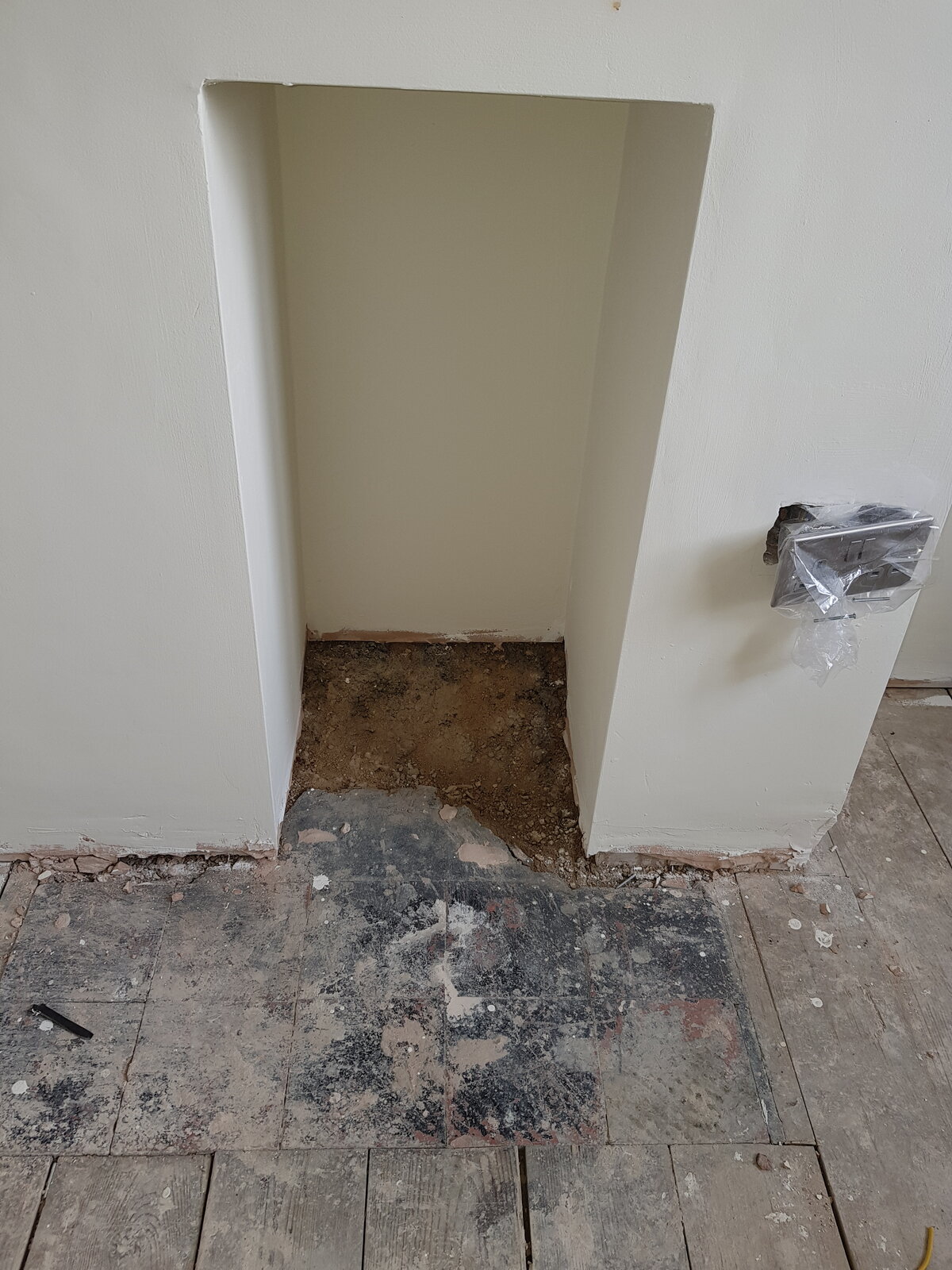

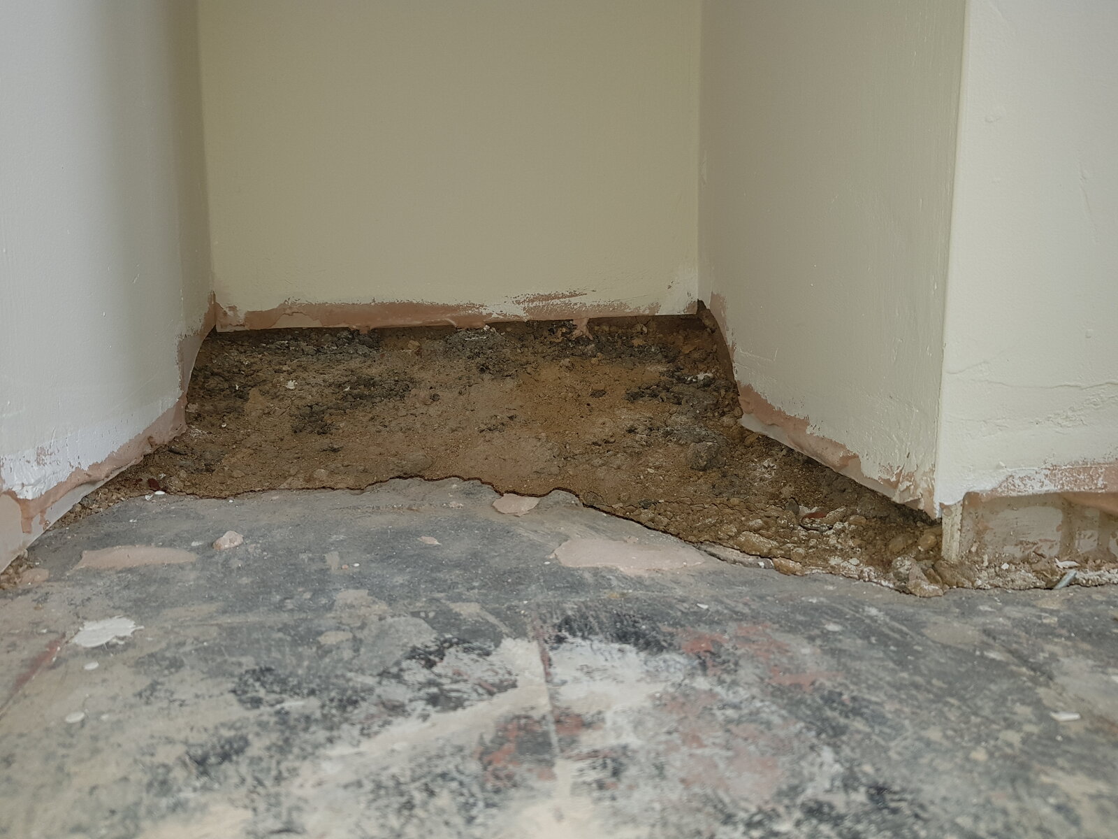

The pictures are from single fire place. I would like to flat them out using concrete mixture or something like that and use the space as small storage. I am not sure how to do it though.... Suggestions and advise please ?
So just the floor then? Sweep the loose stuff off then either cement screed or self levelling compound (best bet prob SLC, looks fairly shallow).
IMO you'd have been better off blanking it completely rather than leaving that tiny off-centre gap, not going to store much in there.
As above, you must provide a vent for the flue; all redundant flues must have through ventilation from fireplace to stack terminal.
If this chimney breast & fireplace are on the ground floor there's the risk of damp coming through the infill material below the hearth and fireplace. Use the search facility (top right) to investigate fender walls and hearths etc.
Would be much better if you knocked out the section on the left to even up the hole, if possible..
