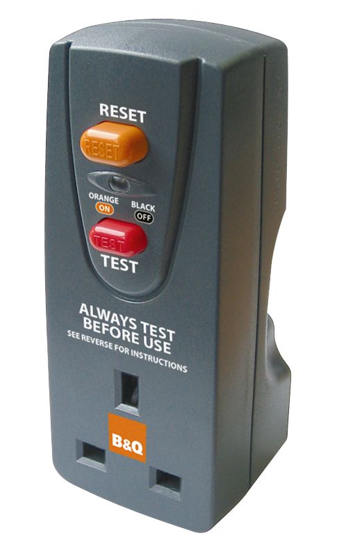

And please check if the sockets that YOU will be using are protected by an RCD.
If not, go to B&Q and buy a plug in one. You are an accident waiting to happen given the story you have told us. It would be a good idea if you kept a plug-in RCD in you pocket and used it whenever you plug anything into mains voltage.
Might be worth getting one of these too;
0000003611302_001c_v001_zp
You know, just in case you do it a third time... :eek:
