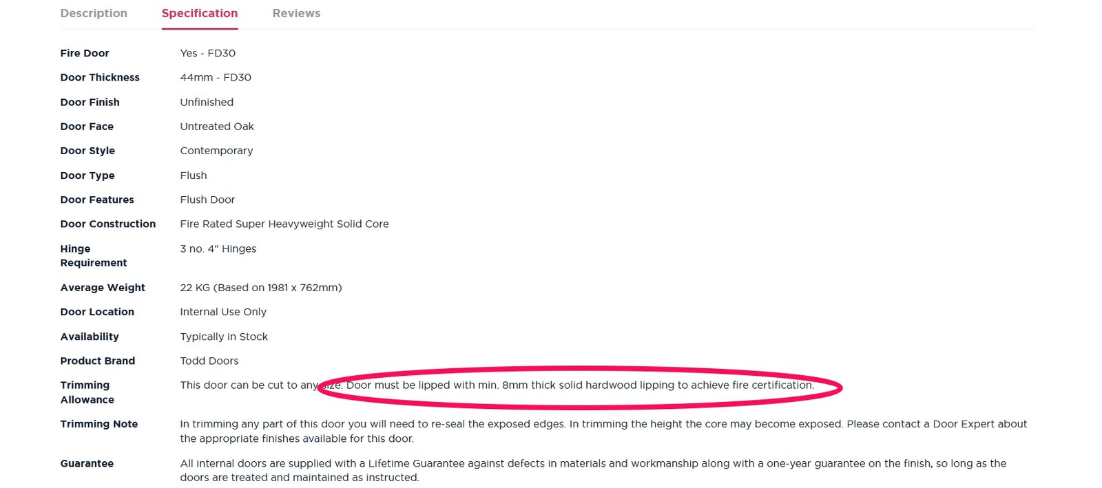

Many fire door blanks can be cut down to suit a non standard sized opening, the door will need to be lipped with a hardwood bead on any cut edges, it will likely tell you what is required in the specifications or data sheet.

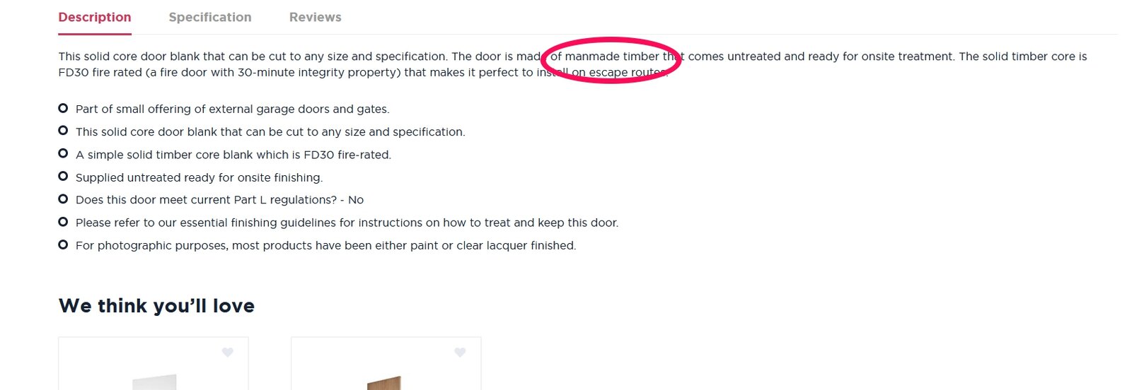

The door blanks sold by Todd doors seems to solid timber. Why would a hardwood edging be required?
When they say solid, they mean a chipboard core, if you scroll down, you will see they describe the door as being made from manmade timber.
Are we looking at a different product? The link says
  • A simple solid timber core blank which is FD30 fire-rated.
It doesn't say that it is chipboard.
I guess we need Todd Doors to reply directly, or via me.
You can't adapt a fire door or a blank or adapt a frame or lining unless you are working to the explicit guidance provided by the fire door manufacturer. Otherwise, it's not a fire door set.
