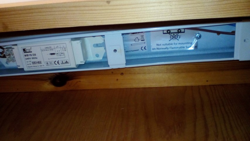

I have changed a fluoro T8 tube bulb to LED.
As first it did not work (flickering), but I removed the starter and it is now stable.
I wonder if I should also remove the magnetic ballast?
I guess this will use less power and increase longevity?
If so, to bypass the ballast am I right in thinking that I simply unscrew the two brown wires from the terminal block, then connect them together using a new terminal block? (see photo)
Thanks, can anyone advise if the rewiring I suggested is correct or will cause a problem?
Yes, remove the ballast and connect the wires together. Also remove the wiring to the socket for the starter, to stop anyone putting a starter back in.
OK... so its not going to blow the bulb or fitting if I put those two brown wires (in the photo) together, right?
The diagram on the ballast (see photo) suggests the top wire is live and the bottom one is neutral, so by connecting these wires I will be connecting L to N, not L to L, is this OK?

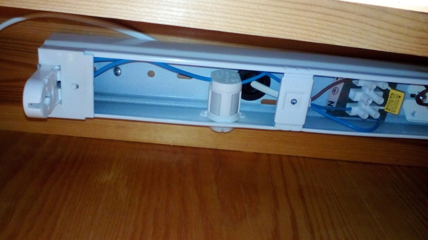

I've added two more photos.
I can see the incoming wires (white sleeve) coming in from the power supply.
These go into terminal block and then onto the starter/ballast.
I guess I have to rewire that bit so it goes to the two ends of the fitting somehow.
I'm getting lost thinking about doing it that way.
I was hoping I could just bypass the ballast by connecting the two brown wires that go in/out of it, I reckon either this will work it or will blow it up.

How hard can this be.
You have two wires coming in (live and neutral) and you have only two wires to connect to the LED lamp- also live and neutral.
Everything else can be removed.
OK having looked again at the photos, I think the blue wires are all already wired up correctly.
I just need to put the two brown wires together, this bypasses the ballast.
I just wanted to get a 'yep sounds right' before I go ahead.

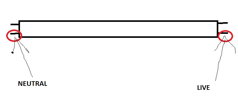

Understood, but the circuit diagrams still remain the same. Line to one side and Neutral to the other as long as both ends have the pins facing one side of the tube it would work either way around.
Not all tubes are like that though. Some have L & N at one end and disconnected pins at the other. So you may need to check if there is a diagram on the tube itself.
