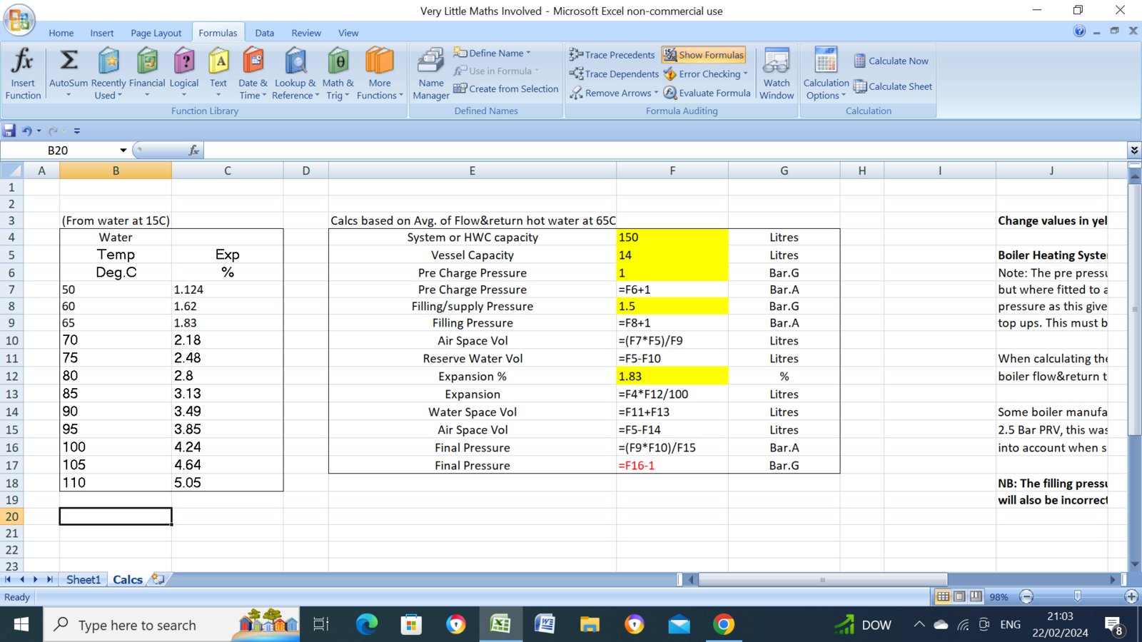

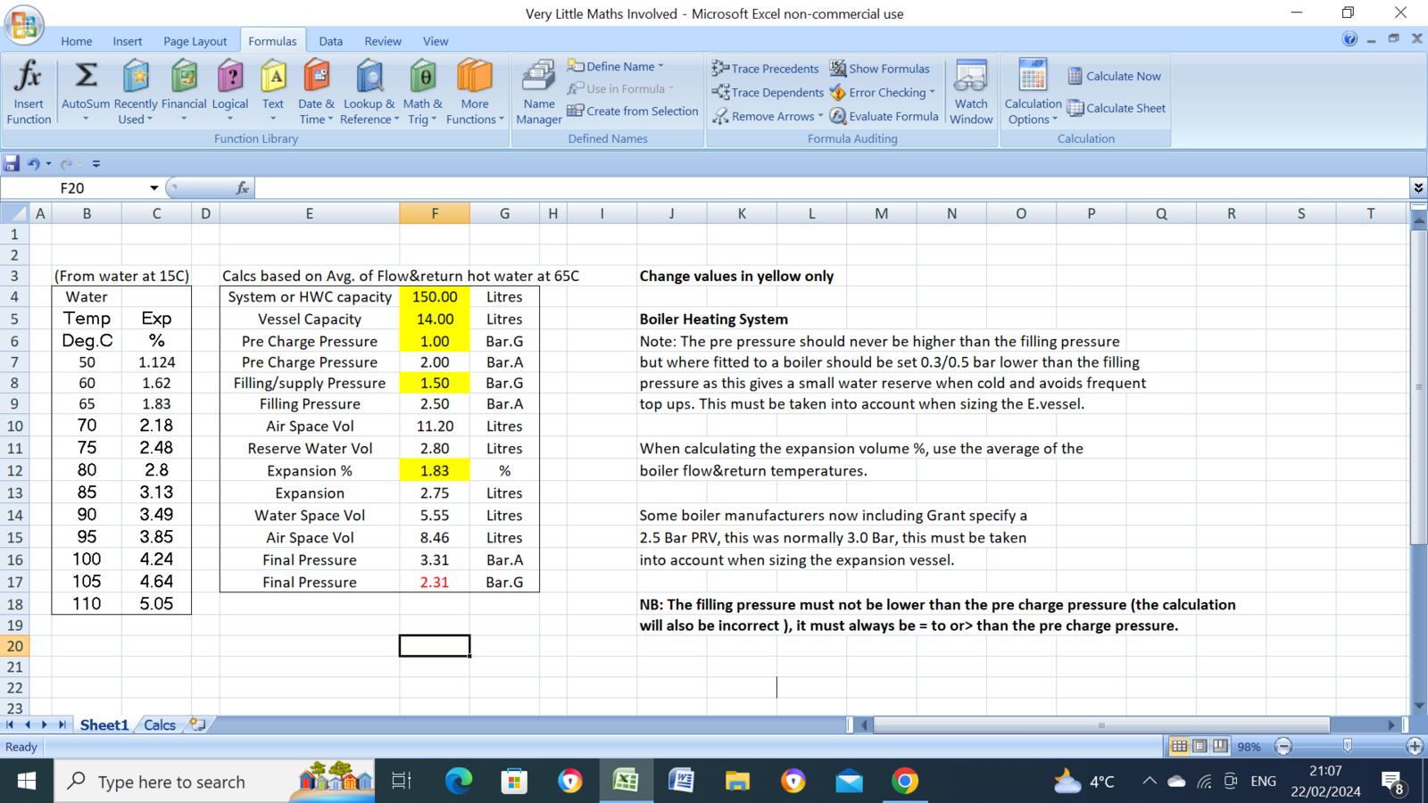

Not much maths involved here in my decades old calculations but might be useful for someone(s). Can't post the actual spreadsheet.
Have attached it .zip form.
  • Very Little Maths Involved Rev1.zip
