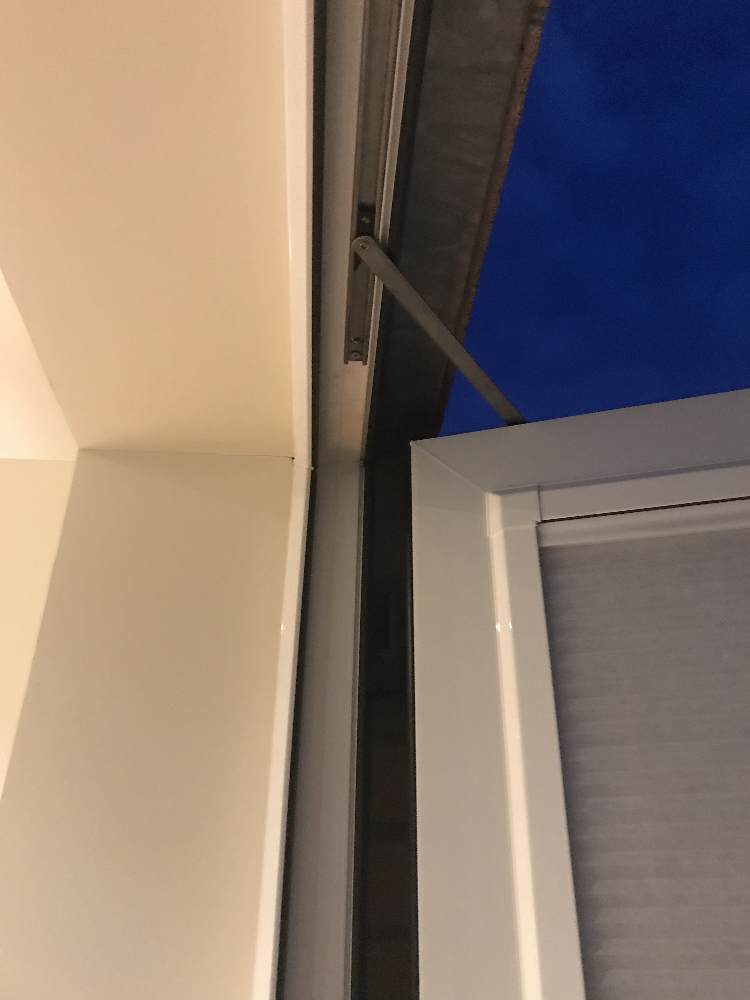

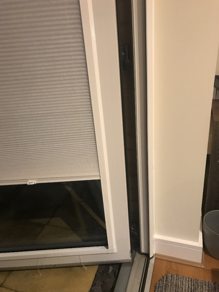

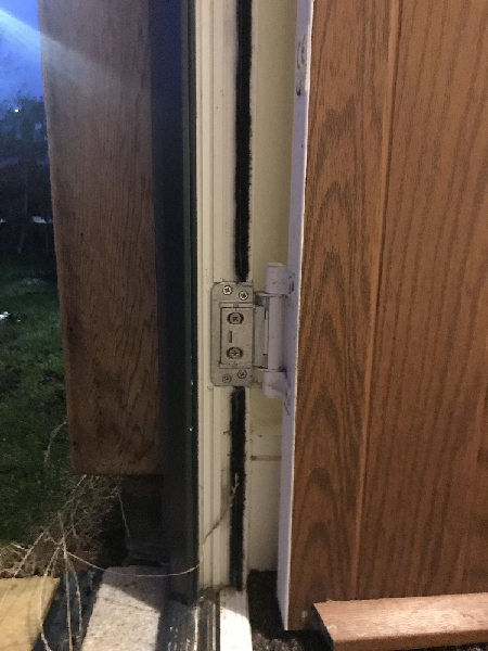

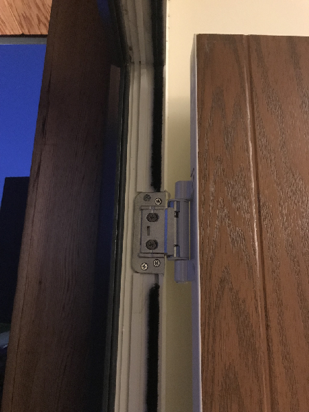

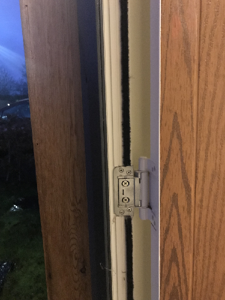

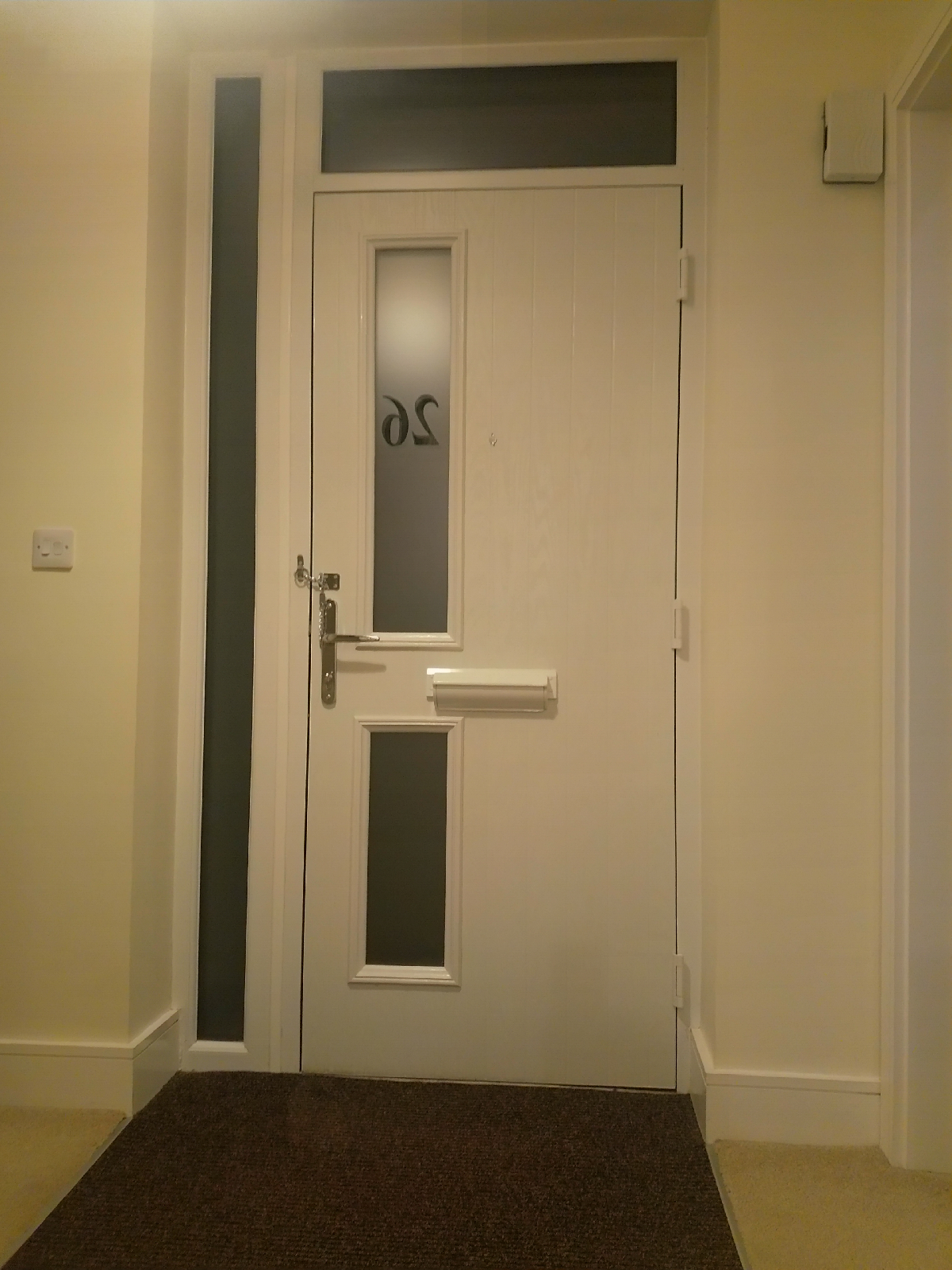

I can't see any screws in the frame unless they are hidden behind the hinges. Here's some images
Top Hinge
Middle Hinge
Bottom Hinge
Door From Inside

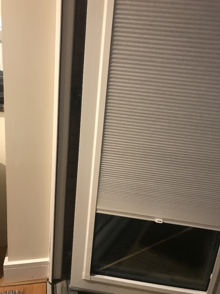

In this image you can clearly see that the door is not square in the frame. There is a big gap top right, thin gap bottom right. I noticed that the two adjusting screws in the top hinge were loose so when the door is jolted when open the hinge moves.
But back to the frame issue. Do I need to take the hinges off to see if there are screws underneath them? And how to I check if the side light is secure?

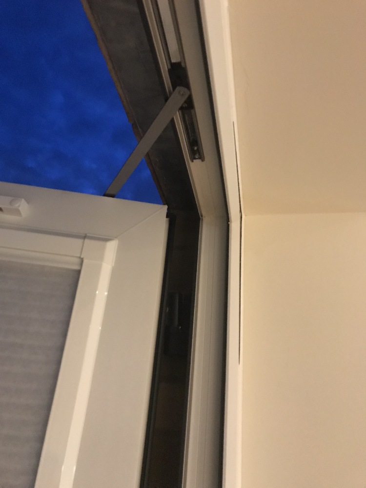

Even more worrying is that the larger, double patio doors do not have any visible screws. Maybe this door frame has capping to hide the screws? Is there any way to check this?
Left / Bottom Left
Top Left
Top Right
Right / Bottom Right
None of the windows have visible screws either. All of the upstairs ones are 6ft from floor level up.

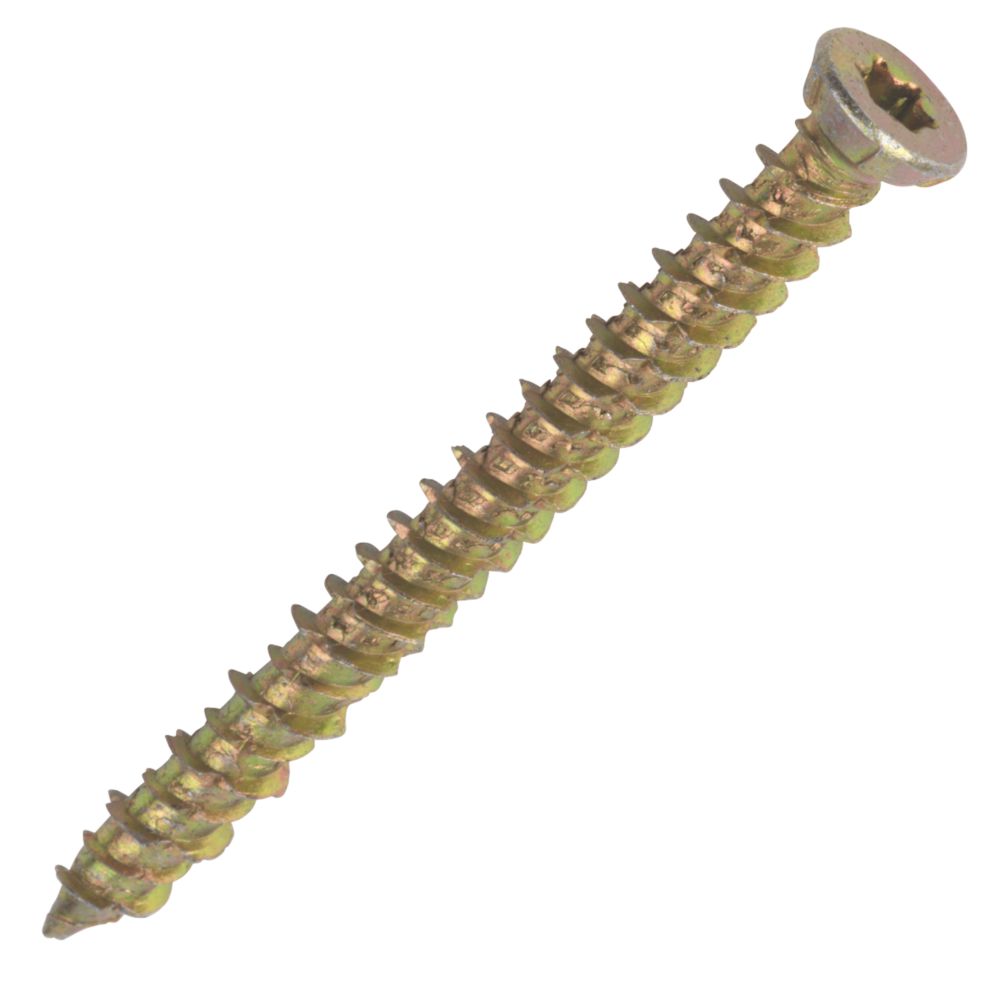

You generally don't hide screws like those under hinges.

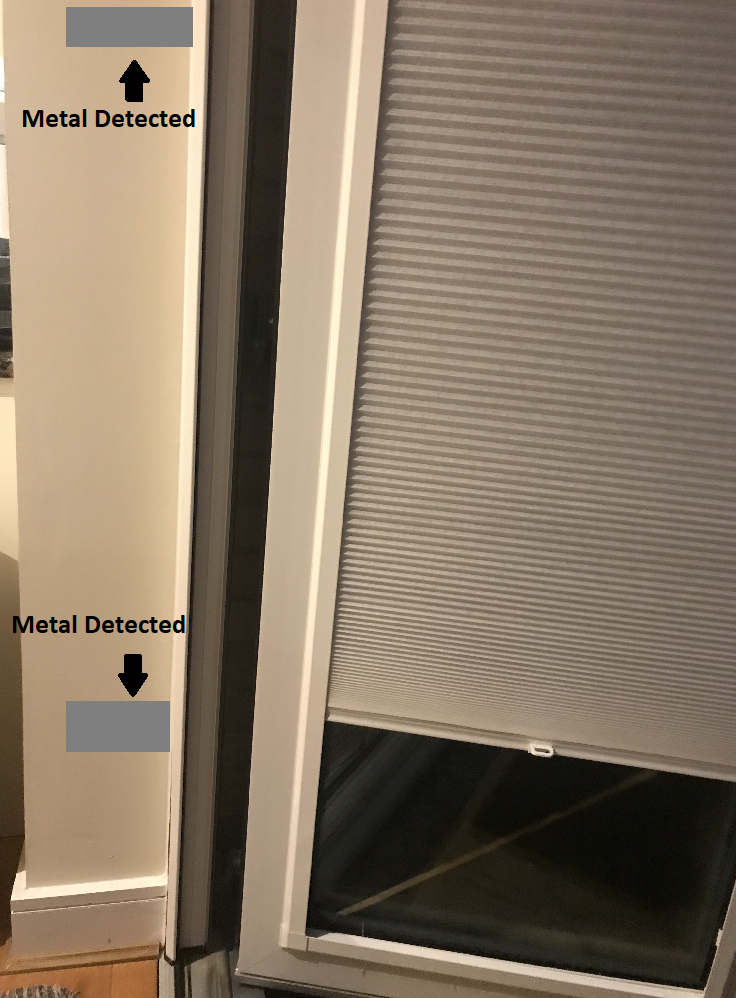

Ok, that makes sense @crank39 I just ran a detector over the area and all doors and windows that I sampled had sections of 3" to 5" wide medal near the top, middle and bottom zones.
So that sort of proves they used a cleat fixing system but it does not prove that the frames are correctly connected to the cleats.
The only way you can use those is to fix them to the outsides of the frame first, position the frame, then fix to the masonry, so if they are there it's been fixed
There were some I saw once that were a spring loaded affair that retracted as you pushed the frame into the apature, teeth on the clip bit into the cavity closer, done for speed when fitting on new builds, think they were from eurocell
