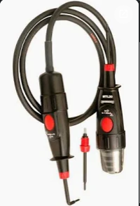

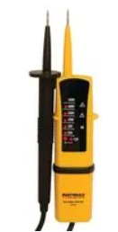

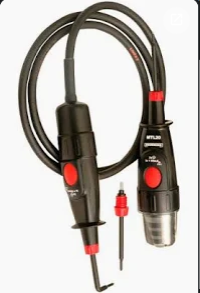

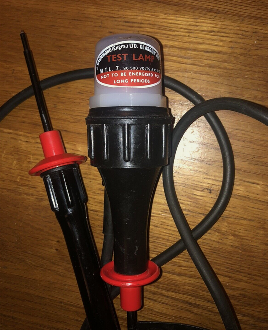

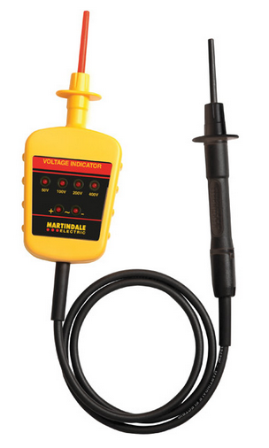

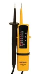

The testing for dead uses a two pole tester with no selection switch and no battery, the idea is you can't in error select wrong range or have discharged batteries. It also should have a tester for the tester called a proving unit that will show the tester will detect low voltage, so should use 50 volt AC to show tester is working, it may also use higher voltages, but must show if any low voltage is present, and low voltage AC starts at 50 volt and goes to 1000 volt.

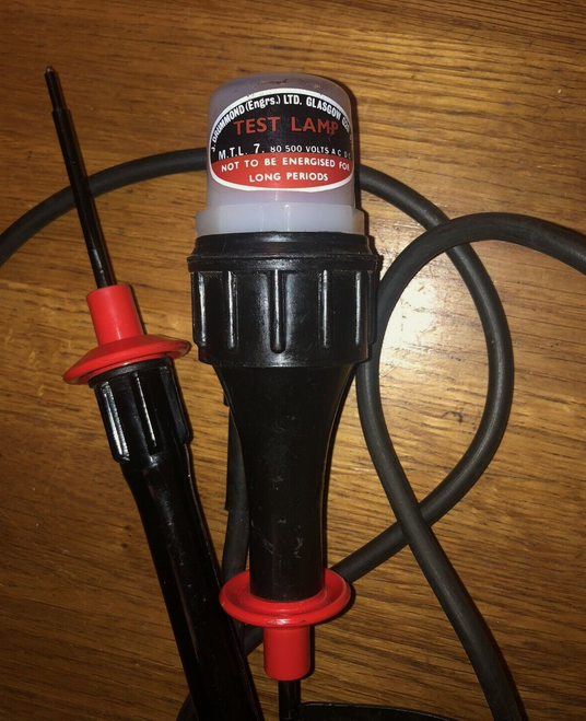

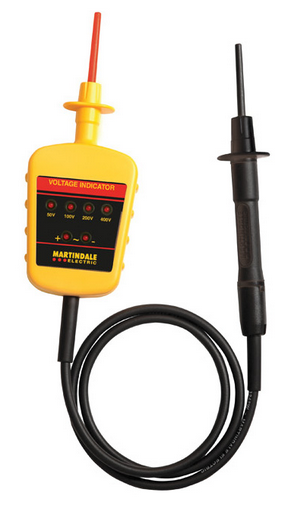

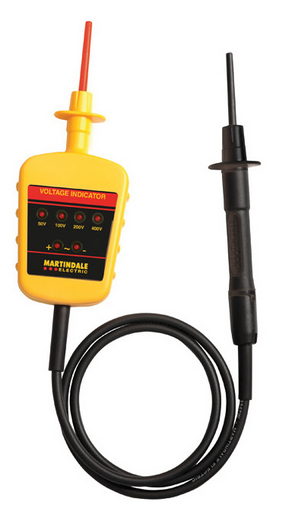

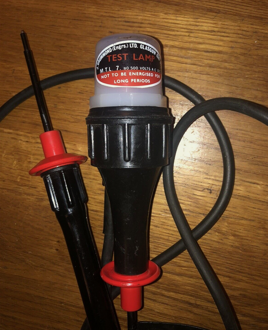

These 1705743468448.png 1705743261158.png1705743586745.png1705743724464.pngwere used for years, the early versions had a bulb in them, later versions used another device less likely to fail. The problem was large lumps to carry around, and all they tested was voltage, so we started to use units which could test more, the multi-meter, however I did an 'A' level physics in latter life, and could not believe how many fellow students could not grasp the idea that a meter had to be put into the correct range, and how many ended up blowing the fuse in the meter.

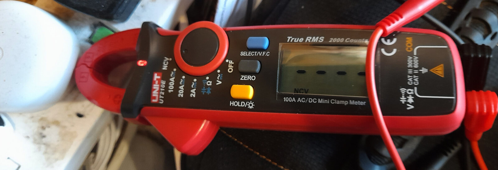

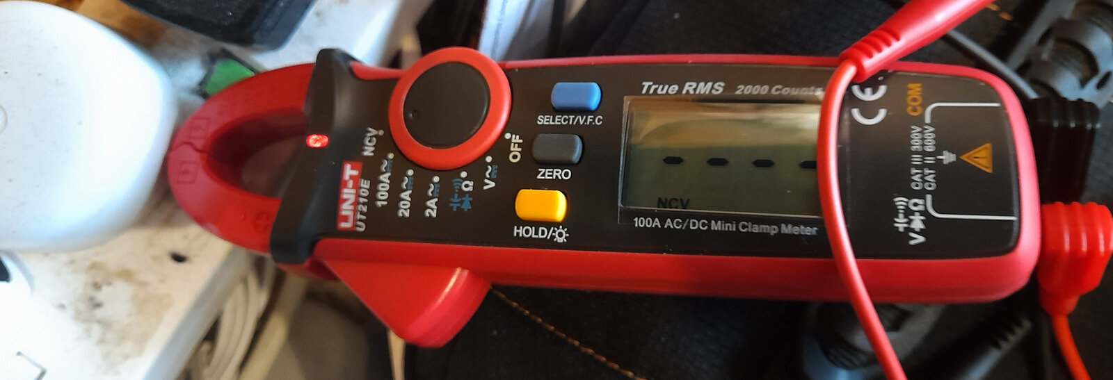

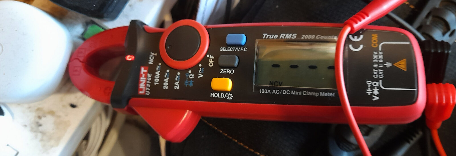

A meter like this Testing for live.jpg has both two probes and non contact testing, so it does not have a probe current range so one can't blow fuses or create a danger by selecting wrong ranges. It also allows one to test to see if likely live before removing screws in sockets or FCU's.
So all testers I have shown are unlikely to cause a danger for the user. But the last one, you can select the wrong range. But all are two prong testers.

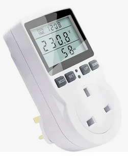

Most of the time, mine does nothing, it just sits in my tool bag. I do use it to prove dead from time to time, and use my jump start unit as a proving unit. But in the main easier to use a plug in unit. The plug in energy monitor 1705770154617.pngdoes so much more and so easy to use, the multi-meter is not used much. But as

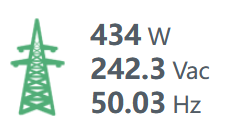

I can see mains voltage at a glance from my PC 1705770473980.pngso no reason to get off my backside to measure it. It also shows as seen how much I am using, and mains frequency, why I don't know, not really anything I could do about it.

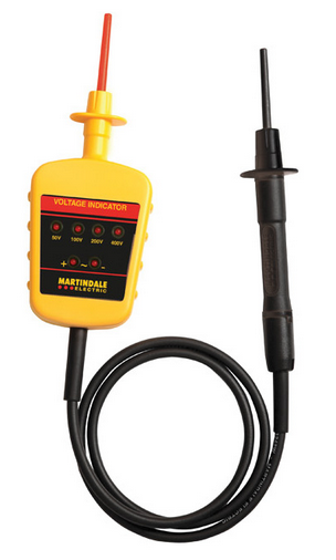

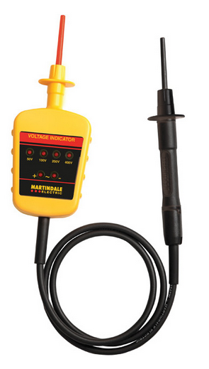

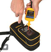

I carried a tester on one job with proving unit, like this 1705771454943.pngon one job because it was a requirement we carried them, were sacked if found without one, but it was a rather silly rule, as the proving unit 1705771629417.pngonly gave out the top voltage (690 volt), so one had no idea if the tester would work with 50 volt, so rather pointless, just some safety officer flexing his muscles.
