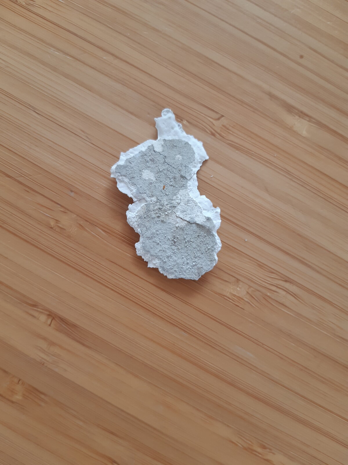

I am a bit worried that the water tightness of the house will then rely only on paint that is applied directly to the concrete walls. Although as you see below it wasn't much better before. I did a small patch that I could get to (first picture) and I sealed the wall then used some universal render and I will paint it. I had expected something like this.

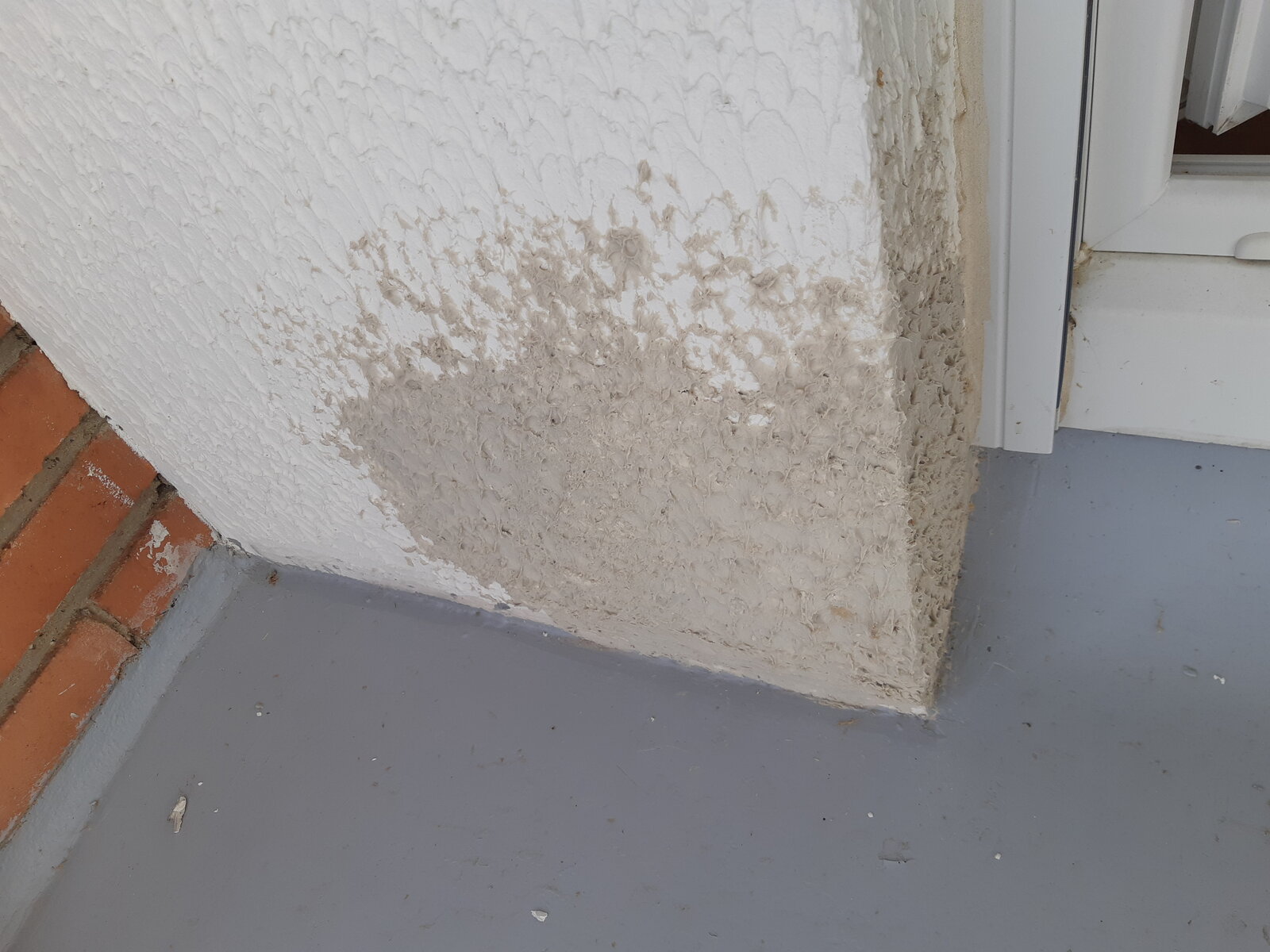

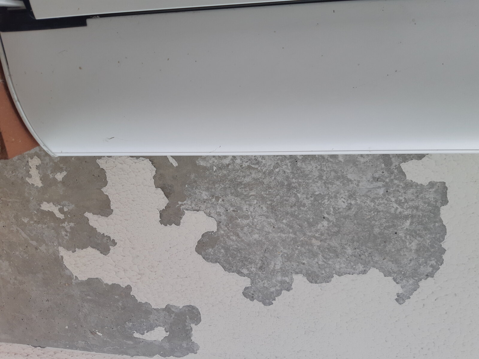

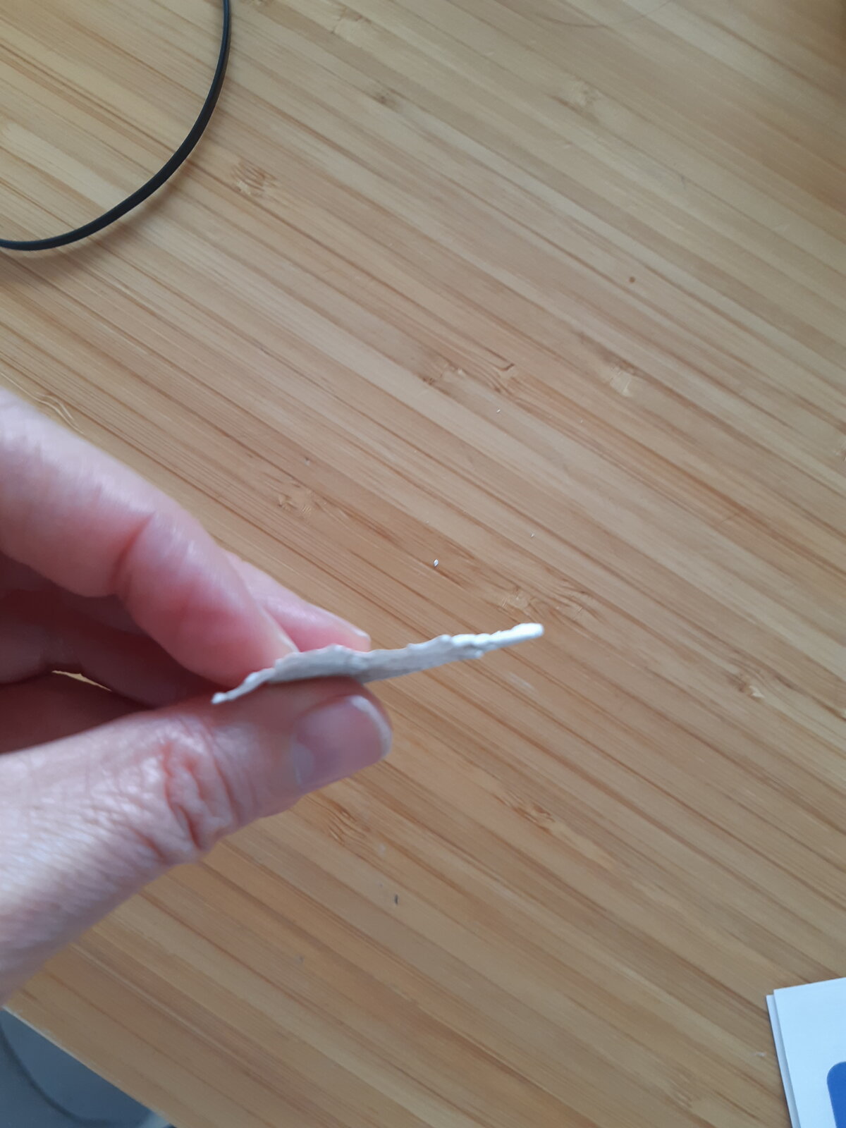

I put some pictures below, showing the large patch where it is down to the original concrete (pic 3) and two of the original covering so you can see how thin it was and how little there is to build up (pics 2 and 4). Should I insist that they still do all three stages as it seems a bit pointless given the thickness? I would happily pay them more because they had to do a lot more work on the gable end than they thought.
