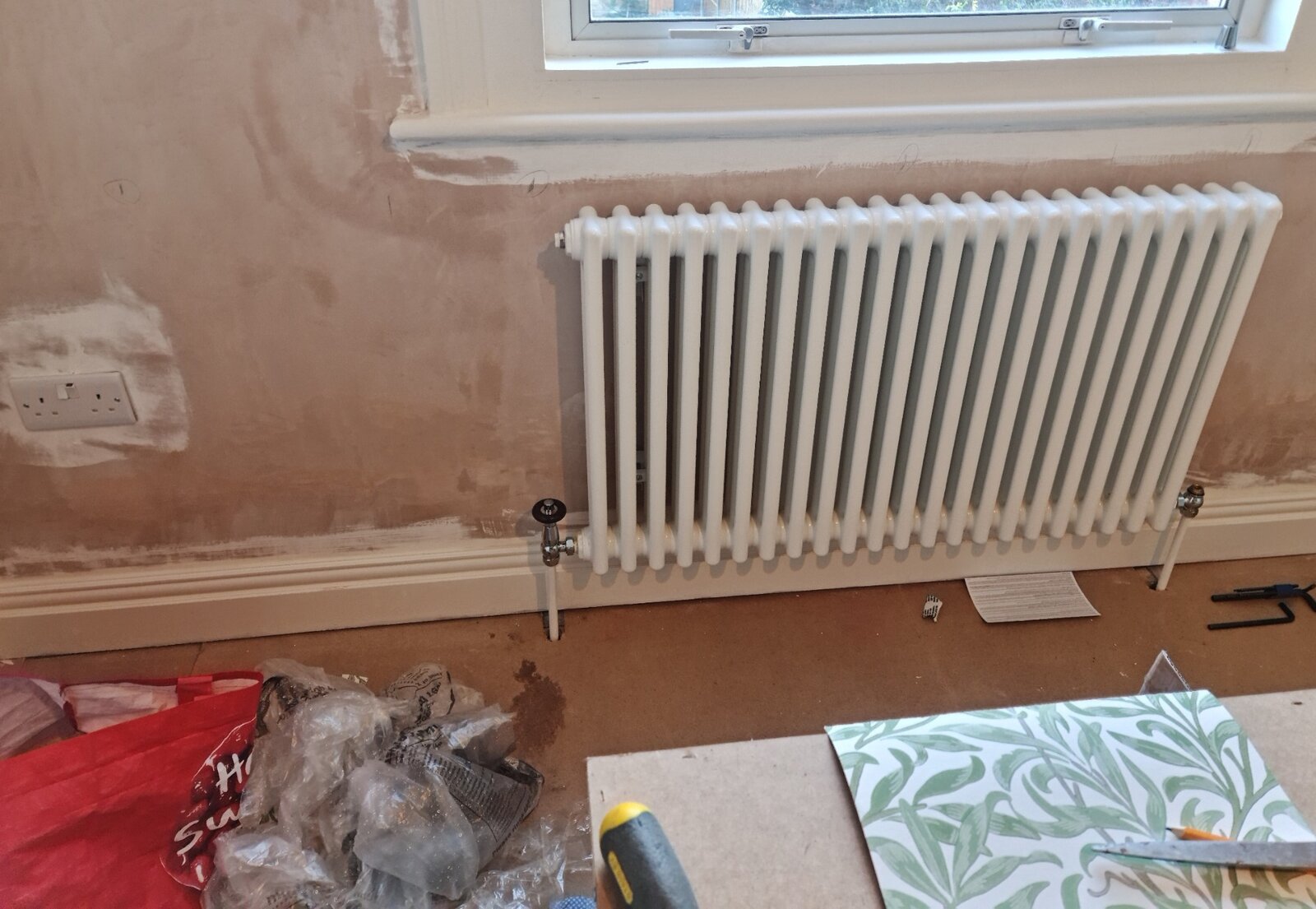

This morning I planned to remove a rad so that I could paper behind it.
The lockshield valve needed an allen key. I turned it clockwise, turned the wooden rimmed thermostatic crown clockwise, and then opened the bleed valve to let the pressure out.
The pressure would not drop. After having let out about 1L of water, I turned the lockshield valve the other way. The water was still pressurised.
I eventually asked the customer to call the plumber that fitted all of the rads the other week. He explained that the thermostatic valves do not shut completely and that I would need to drain down the whole system...
The valves were purchased from Victoria Plumb. I did look at the product description
Are they just rubbish quality?
Over the years I have encountered TRVs that weep slightly, but not ones that won't shut.

AFAIK they aren't supplied with a decorator's cap. I am not even sure that you can remove the crown. I did open the TRV fully and try to twist the smooth shroud under it but it didn't seem to want to unscrew.
But yeah, when working with "normal" TRVs, I use an female cap with a washer in it and a decorator's cap.

I get what you are saying, but nah. I still wouldn't be able to reach the top of the skirting board to cut a straight line.

They are column rads...
Indeed; hence why I wondered if they would or wouldn't accept a different colour/texture look behind.. if they want same paper behind I guess you might be looking at installing with the rad in (or nearly in) situ..
The visible area behind the rad is bare plaster, and nah, they wouldn't want the silver bubble wrap. Even then, to hang that, I would need to remove the rad.

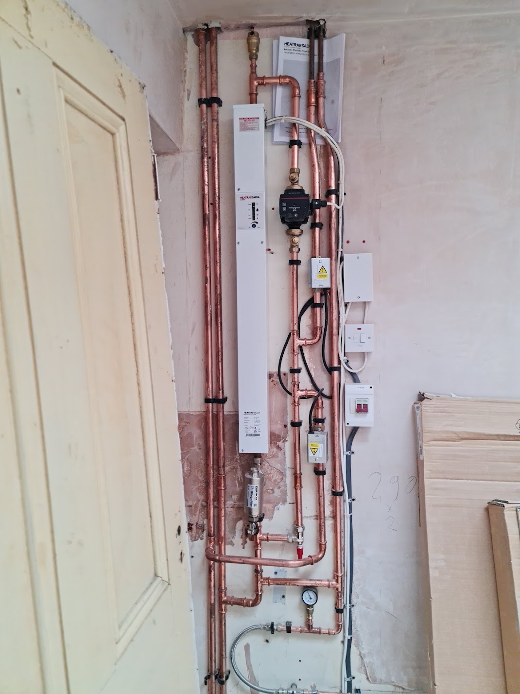

Anywho, I drained it down today.
I only drained the rads on the the first floor. In part because the only drain off point is about 3ft off the ground. It is the underside of the Fernox filter. The only lower possible drain off point is the filling loop. No idea why the plumber didn't fit a lower drain off point.
The rad was re-hung and I have recharged the system and bled the 4 first floor rads.
