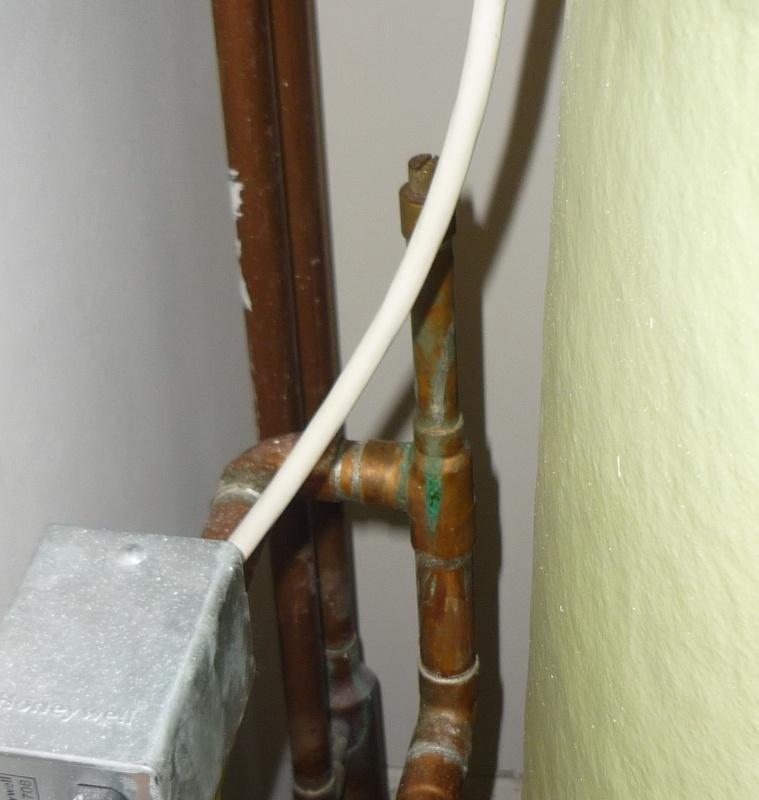

I would think that cheapest and easiest solution to curing the air in your system (which does not do it any good for obvious reasons ) is to fit a automatic air vent instead of the R3 (manual air vent) that is situated between the 3 port valve and the flow inlet to the cylinder. This will entail a bit of draining down and there for would suggest that you remove the sludge in the header tank before hand.
Thanks once again spraggo :cool:
The current vent is a Delcop 854-15, I believe it is fitted to a 15mm tail (is that the correct terminology?).
Here's the best picture I took of it:
Is it simply a case of de-soldering the vent and soldering a new auto-vent on top of the pipe?
Would this type be suitable?:
Altecnic 15mm robocal auto air vent
Do you think the pipe is tall enough or will it need to be replaced with a longer one?
Paul
Yes, that one is OK, you could get a 15mm compression X 1/2 female iron to save you soldering, I don`t see that you would gain a lot by extending the pipe tail but there is nothing stopping you from doing so, using a 15mm comp straight.
