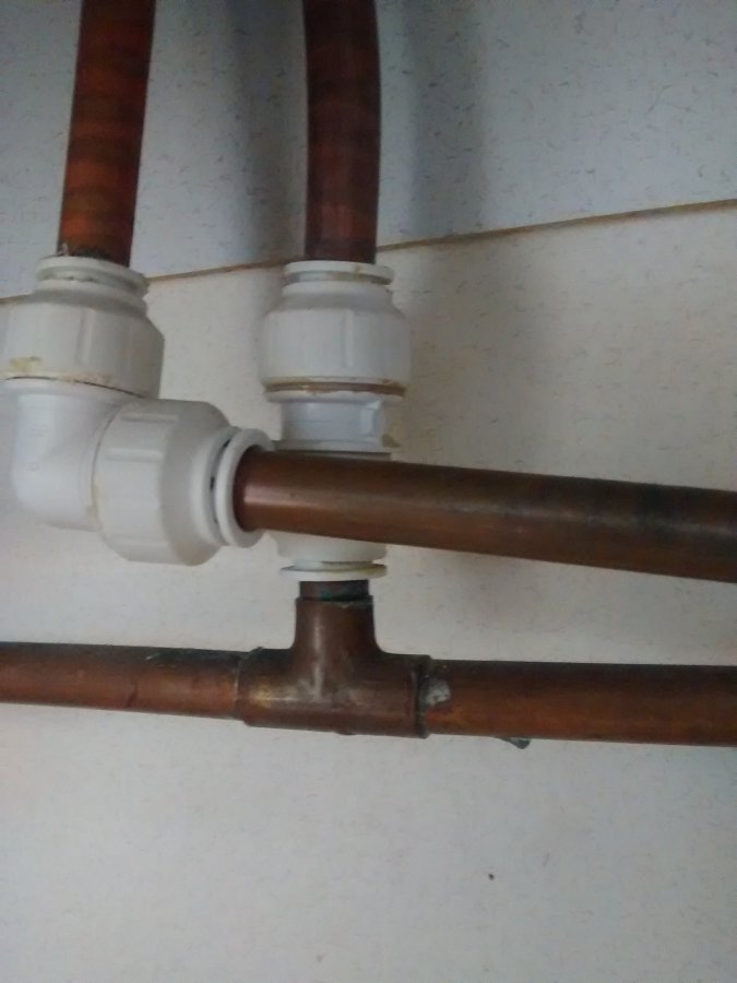

I have a leak under my sink and have identified it is coming from a join. In the photo it is the section at the back.
Can anyone point me in the right direction to a part name, number and best place to purchase.
I am hoping I can fit this myself so any fitting tips are very welcome,

It's not been installed correctly so it may be that the pipe has slipped out of the fitting a bit, in which case you just need to push it back in and do the nuts up
+1 you just need to remake the joint unlikely you will need a new fitting, it just needs pushing back in and a quick turn to lock the fitting
