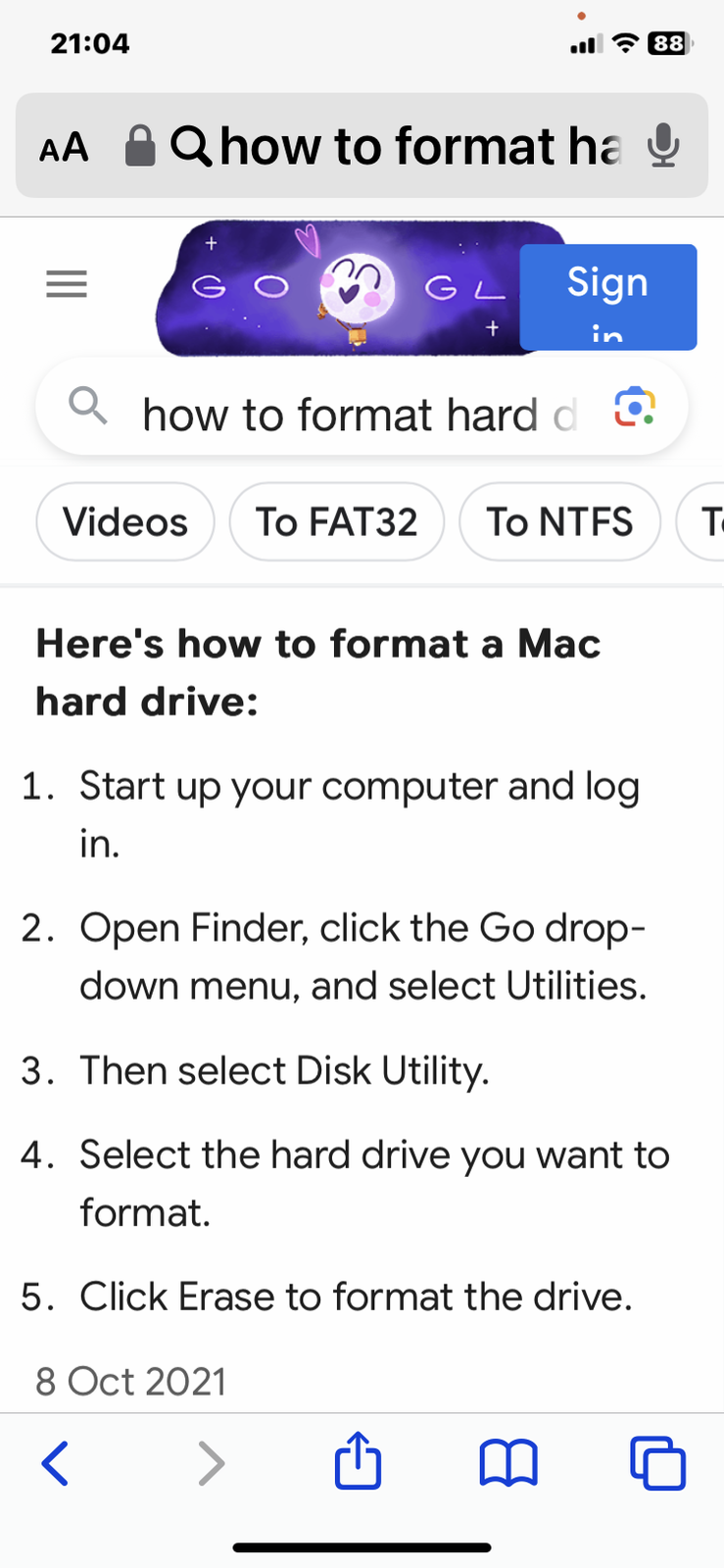

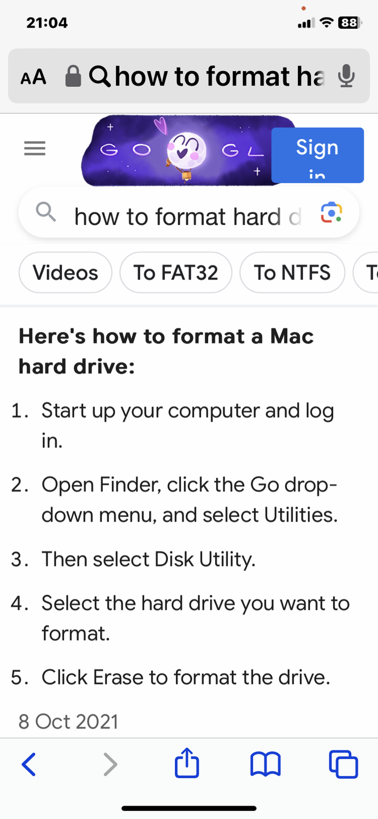

You needed to format the Ssd for use on Time Machine or it just sees the Ssd as a big usb hard drive as it will be sold formatted for pc.
I think Foxhole is absolutely correct. That is what I had to do in the same situation and time machine works fine.
I Formatted my SSD with Format Mac OS Extended(Journaled) and retried a back up with Time Machine without success. So reformatted SSD with Format Mac OS Extended (Case-Sensitive, Journaled) and retried a Time Machine Back Up. All looked to be progressing well, albeit very slowly (9GB of 78GB in 5 Hours) It then appeared to stop at that back up volume and no 'Back up time remaining' calculated of 9.24GB of 77.92GB
