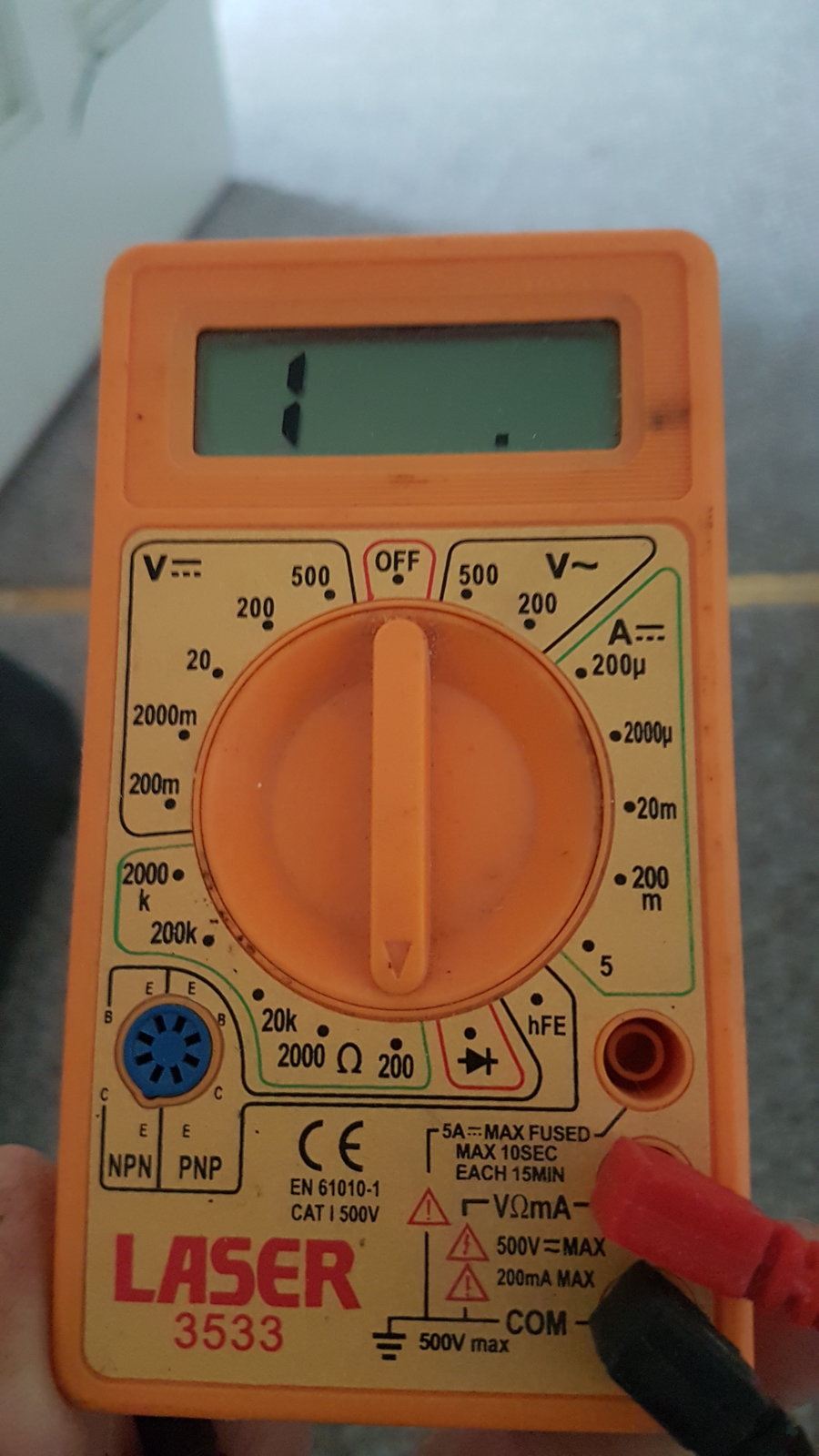

Immersion heater appears to have packed up, no hot water last night or today. The light on the timer switch comes on when the timer kicks in or when you manually boost it, but no hot water.
Either the element has packed up or possible just the thermostat has failed? Is there a way of testing the thermostat to find out if it's a faulty stat or a faulty element? Its a much easier job putting a new stat in, rather than replacing whole unit.
Visual inspection first- isolate supply, remove cap on back of heater, look for charred or failed cables or connectors.
Then Multimeter. Isolate supply, remove cap on back of immersion heater. You'll see the live wire (red or brown) and a tail from the heater going into the back of the thermostat. Set meter to impedance Ω low range, check it is working (short probes, reading should go to zero), apply probes to those bare conductors. 0 reading is good, ∞ is bad.
Next test- probes onto each tail of the heater, again ∞ bad, 20 ish good.
Thanks very much. Will do this when I get home in a couple of days.
Just to clarify, correct setting for my multimeter?

I checked voltage between L and N 230Vac (used my 2 pole voltage tester).
Ok.
[ Checked the resistance and it displayed OL (which I know is open loop/line).
If you mean the resistance across the thermostat contacts then it is open.
If it is set to high then it is not working.
Checked the resistance between elements and got approx 21.3. I also checked for the reset.
If you mean between the ends of the element then it would seem to be alright.
Slightly higher than would be expected; did you deduct the resistance of the leads?
My question is (and relevant to OP): Can any make of thermostat be fitted providing it’s the same length, or does it have to be brand specific?
They are all the same.
I also checked voltage between L and thermostat tail and got 230vac?
Indicates again that thermostat is open and element is alright.

Didn't deduct lead resistance, but when I checked again it came in slightly lower approx 19.3? Maybe because it's auto ranging or dirty contacts? Yes I checked across thermostat contacts. Need to get a new one. Thanks.
Got my wife to check the stat last night, she said reset button had popped up, so pressed it in and it started working again. However this morning no hot water again and reset hasn't tripped this time. Not home for a little while yet so not yet tested with a meter.
