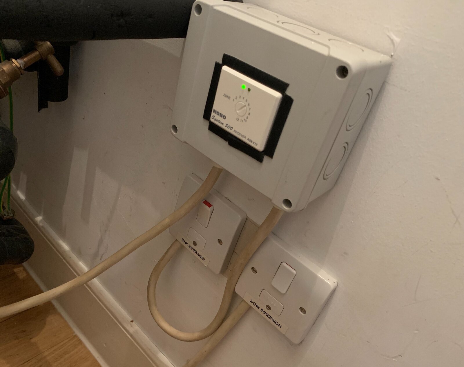

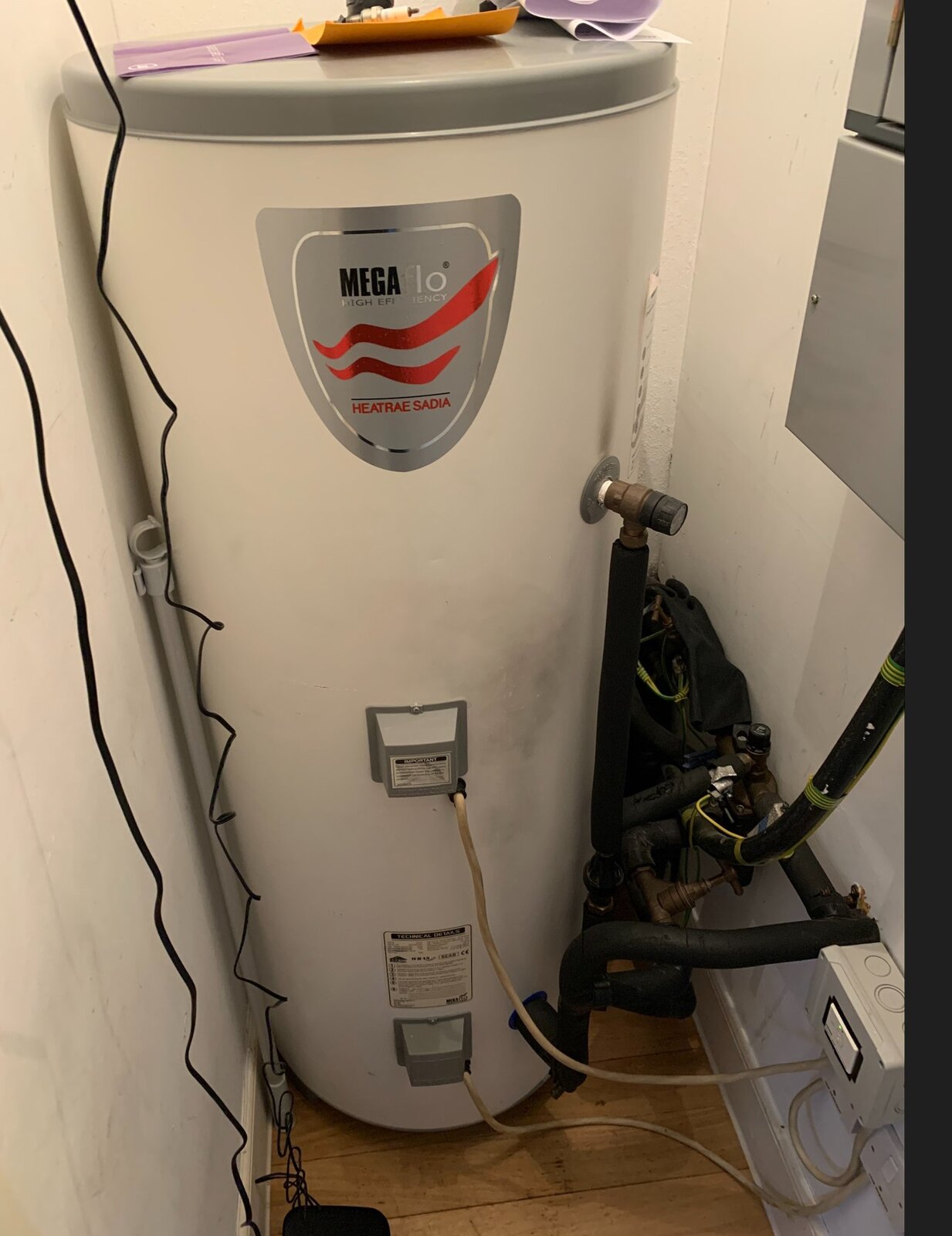

I have just moved in to a new rental accomodation in the UK. The accomodation has no gas and is purely run on electricity. I think all of my hot water is heated through an immersion heater (a 'Heatrae Sadia Megaflo DD210' pictured below).
I am trying to reduce my electricity useage as I had a rather nasty shock last month. I've been advised that it is could be due to the immersion heater as I think it had been set so that it was running 24/7.
The immersion heater has two connections to the mains. Both of these connections have been switched on.
I think 1 is linked to a control panel. Since the nasty shock, I played around with the control panel so that the immersion heater is programmed to be on for 6 hours a day (3 hours in the morning and 3 in the evening). This switch is labelled '12HR IMMERSION'. I have no idea whether this programming has had any effect.
There is a second switch labelled '24HR IMMERSION'. I am not sure what this switch does. I am worried that if this is needlesly switched on then I will get another huge electricity bill.
I have played around with the two swithces:
When I switch off 'Switch 2' (24HR), there is an immediate difference in the sound of the Immersion heater.
When I swtich off 'Switch 1' (12HR) there is no difference in the sound of the immersion heater. There is also no audible difference when the heater programmer switches from 'off to on' or vice-versa.
I am worried that my Immersion Heater might continue to be heating up water 24/7 (and therefore incurring huge quantities of electricity).
Would anyone be so kind to advise? Unfortunately I am clueless with this stuff but really want to avoid another nasty shock next month.

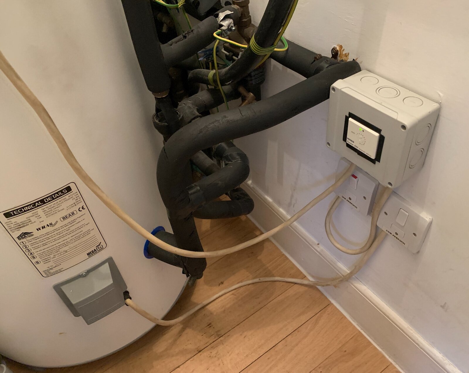

you have 2 immersion heater elements within the tank
Both are wired up - one to the Box marked 12 hours and one direct to the 24hour switch
turn the 24hr one off
now it should only heat up to the timings you mentioned.
the immersion heaters on the TANK are factory set to 60C - so once the tank reaches 60C they should turn off - or NOT switch on
Unless someone has changed those temperature settings
thats my DIY take on your setup - sure more professional members will be along
you should be able to also see on the electric meter - when they are drawing current - some will flash a light faster - not sure what meter you have

The Nobo System 500 RX512 wireless receiver is wired to the upper immersion and on the "12 hour" immersions switch...
Google tells me that the Nobo System 500 is no longer made.
That upper immersion is intended for a 'topup' and is usually manually operated when on an economy 7 installation.
Looks to me like the numbers assign an RF ID to that switch to permit the wireless control-timer to operate it. (I have a similar set of wireless 13A sockets and remote control, a predecessor of 'smart switches').
OP should look for other Nobo-branded items and time controllers for that. For example https://www.upperplumbers.co.uk/PDF/Manuals/Controls/Orion512 manual.pdf is a link to the manual for a Nobo Orion 512 that mentions this controllable switch and that the device permits wireless multi-zone timer control of panel heaters and similar.
Then there's the lower element fed from the 24 hour switch... To heat a full tank of water - typically via an economy 7 switched supply circuit. Which the OP doesn't seem to have.
To make use of 'off peak' or variable time of use tariffs the 24 hour immersion would need a timer-switch (capable of the high current) inserted into the circuit (a bit like the one in the upper immersion circuit.

The 210DD electric spec states a heat up time of 102 minutes with both elements - that's 6 kW - in use to 60C. That'd need 3 hours for the bottom only, and a full tank of hot drawn off.}

I'd expect the green led light on that element switch shows 'mains on' and the adjacent led will light red when it is actually heating the water... The controller probably has a manual advance or boost switch to force it to go on. Check that operates as expected.
