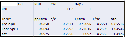

I have a very old but reliable Gas boiler. Let's just say it's efficiency is perhaps around the 50% mark.
Now, I was pondering if it was worth switching to an immersion for summer hot water only heating.
But from what I can see, even at 50% efficiency, it is still cheaper than electric.
Gas cost for 1 m3 unit:
Electric cost. 50% of the gas use in kwh:
What surprises me is that, that would mean that current gas tariff, taking into account a 50% efficiency penalty is still cheaper (just) than my pre-april tariff from last year.
I think I have all the tariff prices correct, but I have not included VAT etc. Just raw tariff prices.
Am I correct? Or are my calculations off.
I guess I have to balance against this the extra inefficiency of indirect heating of the tank vs a direct immersion which may heat 50% of a 100l tank. So perhaps a real world test is the best attempt to see what is potentially cheaper.

Your boiler will be a lot more than 50% efficient, if you say what you have I will tell you its efficiency, Gas will be cheaper than using electric

your boiler is 65% efficiency but that does not take into account pipework losses and as the HW cylinder is directly above the boiler , yes good chance you have Gravity HW, so minimal pipework will still be cheaper than electric

Ahh, yeh, It's certainly G rated. It's actually a Spacesaver 45-60, non-fan assisted. I was getting mixed up with something else.
But I think the G rating classification is 65% "and below". I think they give up trying to give you specifics at that point. But based on anecdotal comparisons and years of monitoring. I'm pretty sure it is less than 60%.
However, back to the question at hand, it seems, based on current tariffs, even if it was as low as 50% efficient, it would still be much cheaper per kwh compared to electric based on current tariffs. What surprises me is that it is still just about as cheap (give or take a few pence) as electric based on pre april electric tariffs from last year.
I may try and run an experiment, see how much the immersion costs to heat 1/4 of the tank from cold. (I think it is only an 11" immersion).

Using the rule of thumb that gas is a third the price of electric, a 50% efficient boiler setup (taking into account transfer losses) is still cheaper than an immersion. At 33% efficiency they're on par

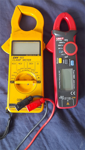

I can measure the current, but not time switched on.
You can measure the temp rise of the tank and assume the current flow is constant? You can buy a better power meter that tracks the consumtpion over time rather than just an instant reading?

Electric clamp on energy meters are readily available and you have the skills to fit one temporarily (or in the CU on the immersion circuit)... can even get multiple clamp units to measure many circuits - e.g. oven, hob, immersion, hot tub, EV point) ;)

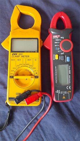

Yes I have a clamp on Clamp-meter-small.jpg but they don't measure time, I also have plug in energy meters which do measure time, so anything on a plug is easy. I am sure if I wanted I could connect an old electric clock to the immersion heater to measure how long the built in thermostat has turned it on for, or simply measure size of tank, and use the on line calculators to see how many kWh it requires to heat the water, as loses not that much.
However to measure the oil or gas used not so easy, could connect an old electric clock to boiler, to record running time, but know it runs for approx 20 minutes as it is 19 kW so weekly power = 19/60x80 = 25 kWh per week. For electric that is around £8 per week, but less losses with electric, so less than that, and for oil/gas looking at around £3 a week. So the difference between them is something like £2 a week, is it really worth the effort to work out which is cheaper?
