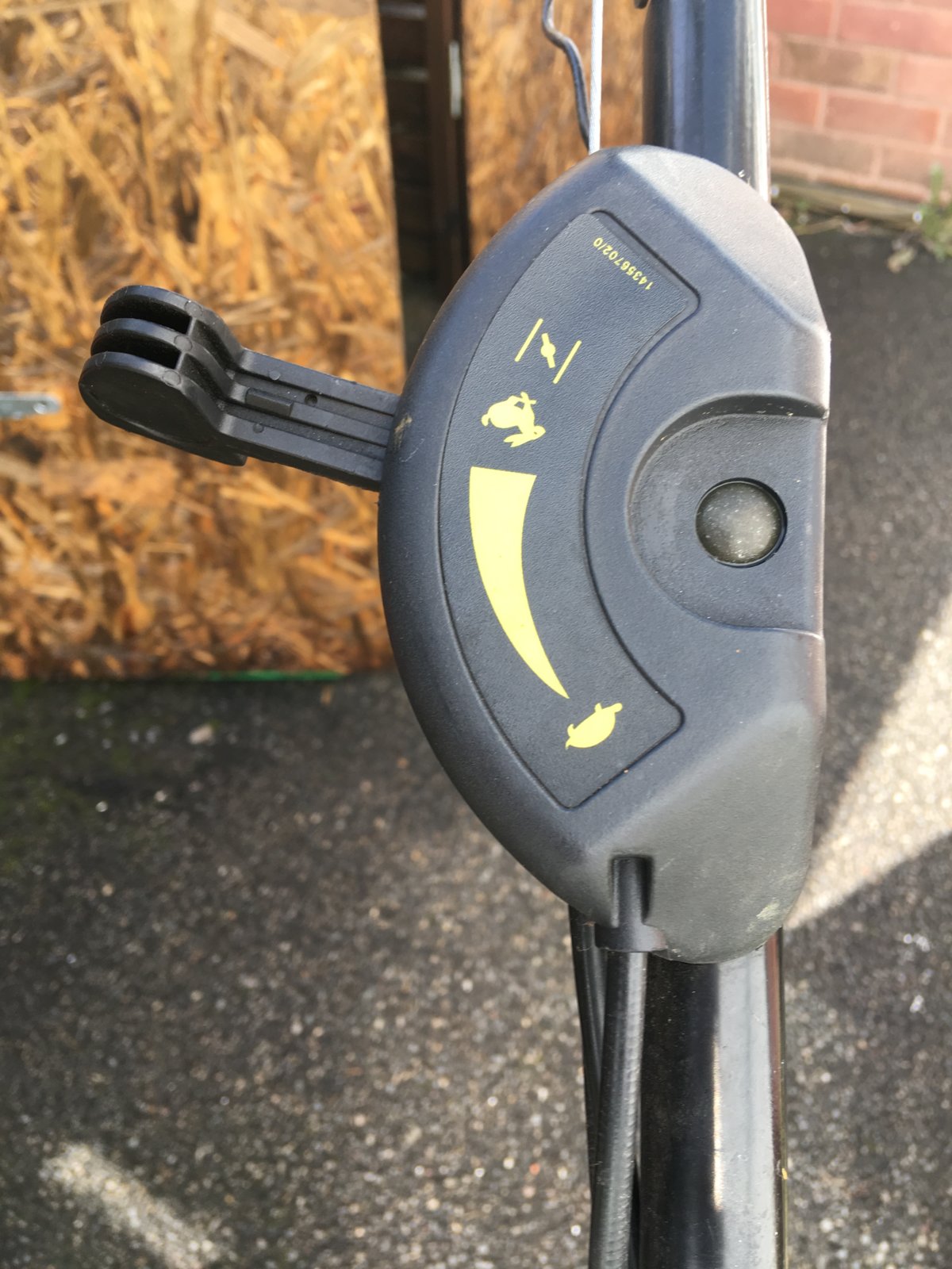

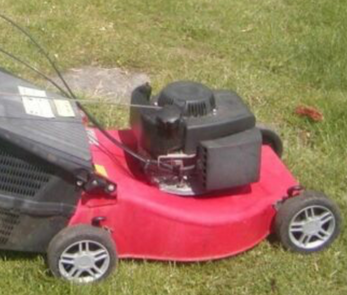

ive bought a champion R484 self propelled mower. It’s the same style as in supplied photo.
Today I cut 7 lawns but I feel that I could of pushed it quicker.
Not sure if it was because of the damp grass but it wasn’t due to its length as I cut these 7 lawns every other week.
How can I adjust the rpm to help assist the speed.

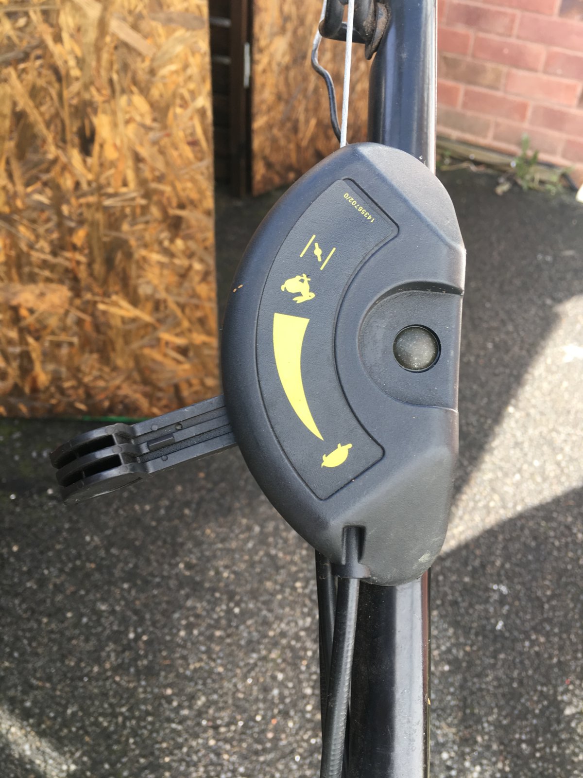

There is a throttle lever on the left hand side which has the tortoise/ hair & choke symbol.
Not sure it there is an adjuster on the cable or you need to start cutting governor spring / bending brackets ?
I remember on a label I had seen SV150

You’ll appreciate that the maximum RPM of these engines is governor maintained, and this can be increased somewhat by careful bending of the linkages.
However becore jumping in there, make sure that the throttle cable is pulling the linkage as far as it can when the handlebar lever is in the full throttle position......it may need to be pulled back at the engine end.

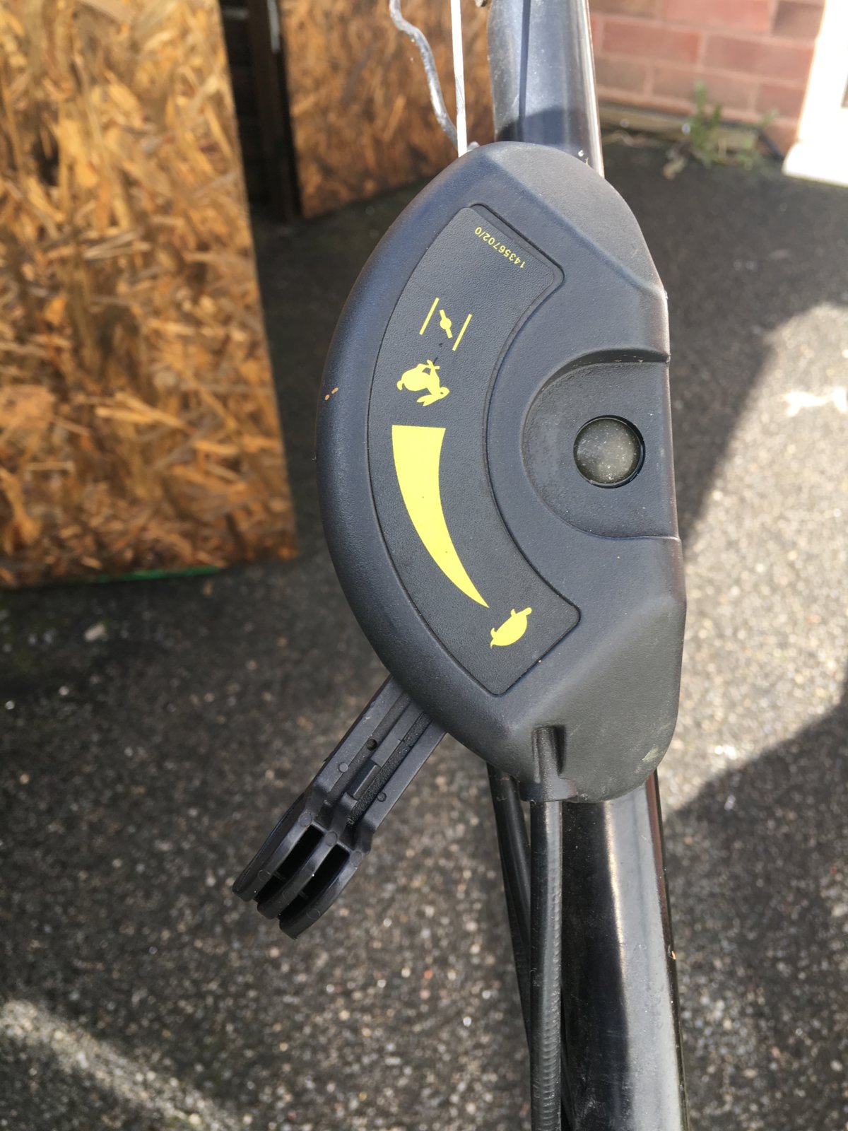

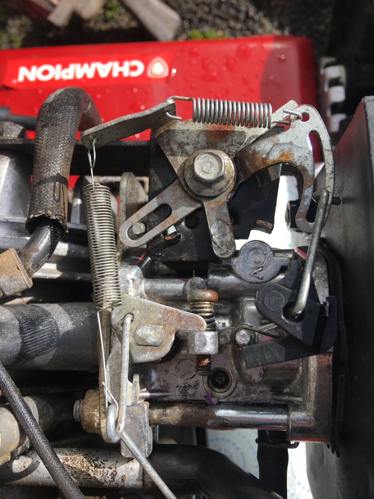

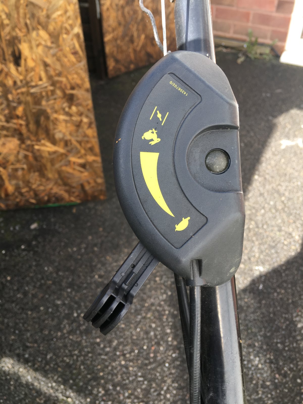

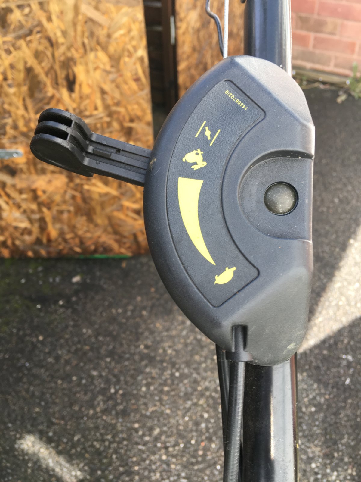

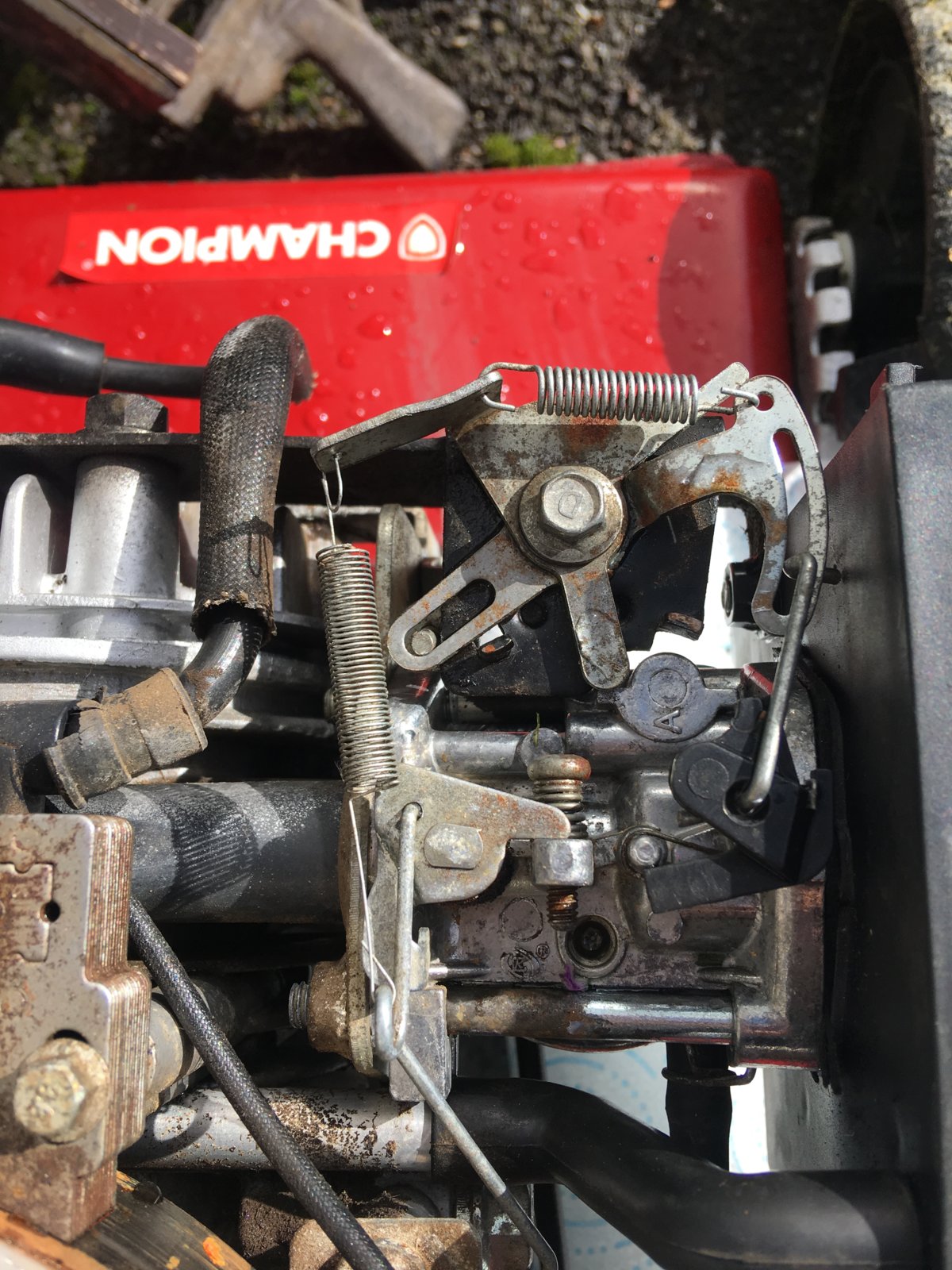

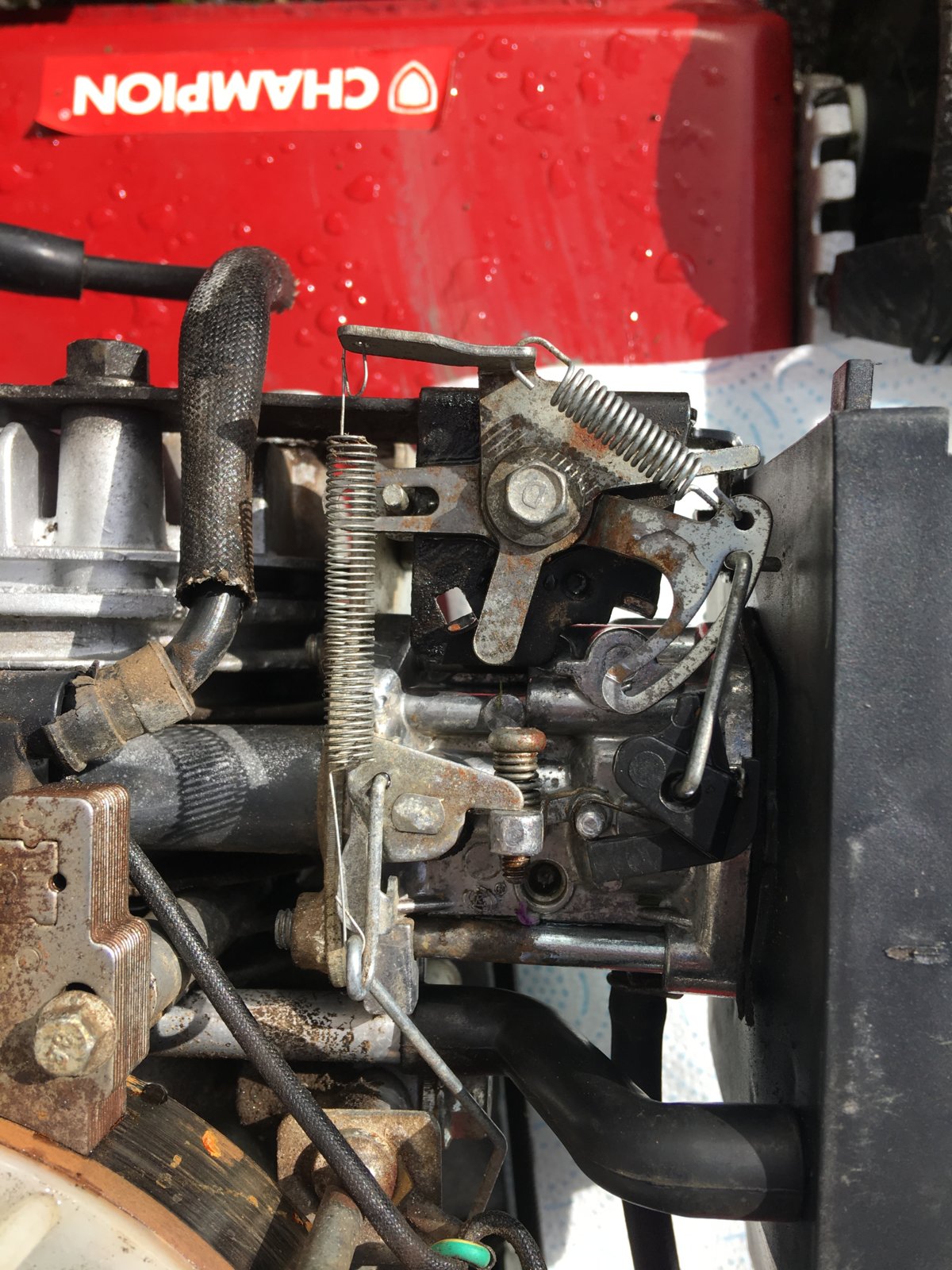

I’ve popped the cover off to show the movement of the throttle lever & it’s carb linkage.
I will show this in 3 stages.
Position of throttle in the off position & this reflects in carb linkage position.
Position of throttle just when carb linkage starts to move.
This is throttle position just before choke engages on carb linkage.
What do you think ?
Excellent pictures!

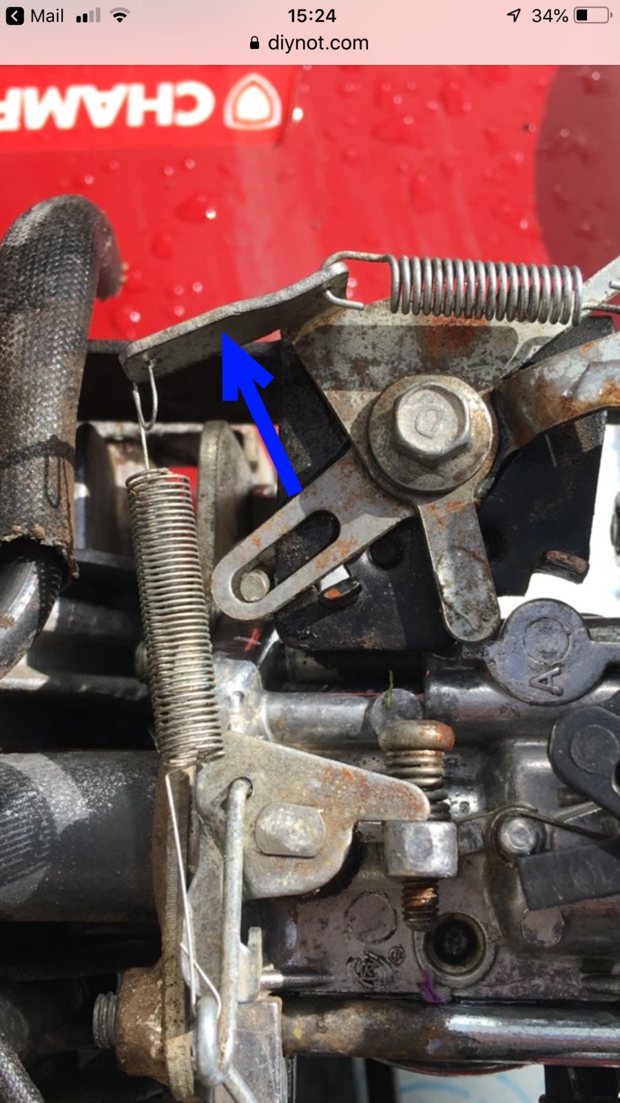

The carb is shown on the full throttle position, as I would expect with the engine stopped.
I think the only thing you can do is to gently twist the bracket that the longer, thinner spring is attached to just to allow the spring to get slightly more tension.
I cant guarantee anything here, of course but the bracket can be bent back again.
John :)

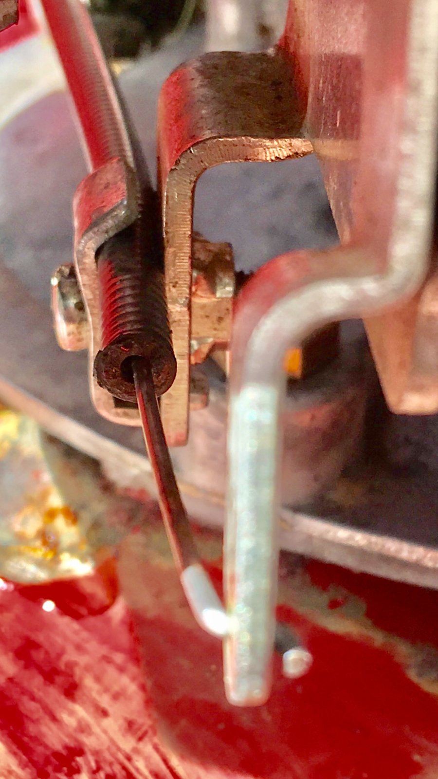

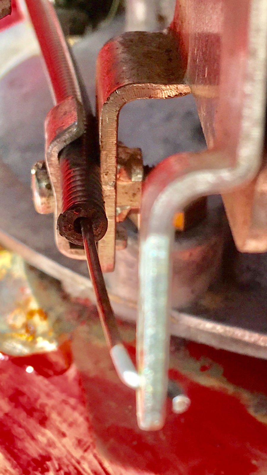

Looking below the air filter I have found the throttle cable adjustment.
It’s just a simple bracket where the cable passes through it and held down but a piece of metal / screw.
Where it is clamp there is say 1 1/2 inches of
I assume you mean this bracket ?
If so also bend it in same direction as arrow.
Or do we adjust the cable as per my last post ?
Slacken the cable clamp bolt and pull the cable back and resecure.....see what happens.
Yes to the second question - just trial and error but Id resist the temptation to alter the springs like most folks do.....they dont go back to original again.
John :)

I think I will look at cable clamp.
Looking at the throttle lever end there is only one mount hole so basically I’m now going to achieve the same but the other end.

I have moved the cable in the clamp a small amount and the revs have come up.
