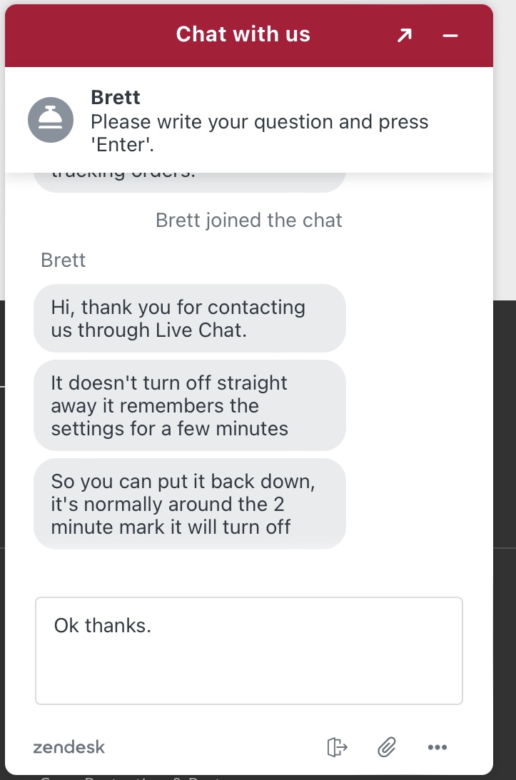

We're having one in our new kitchen (wife's choice, influenced by her brother who has one). When we stayed at his house I had 2 issues - firstly, when trying to fry an egg it switched off every time I lifted the pan to baste it - maybe my technique! Secondly, on his version (can't remember which make), I found cycling through 18 different temperature settings seriously annoying (bit like my TV remote control volume goes from 1-100 when I just need 1-10).

And yes, as soon as you lift off the hob, it turns off.
Andy
Just spoke to a Neff tech and they say you get a bit of time to put it back down so maybe they’ve changed things lately?
