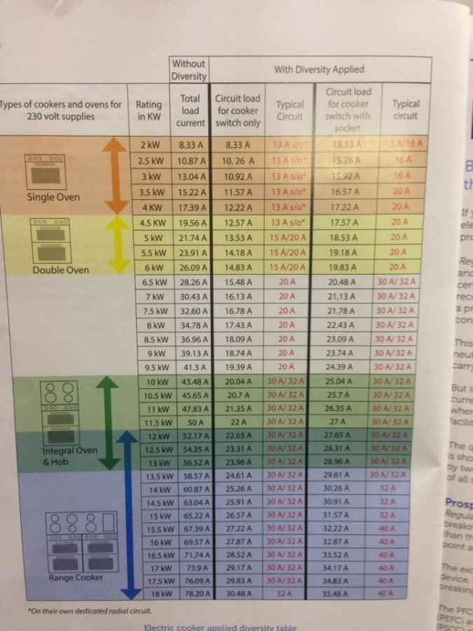

Thanks for the quick reply. So the "relevant" load is not the maximum load? Say we put on a 7.4kW induction hob and a 2.9 kW oven, that is a combined load of 44.8A at 230V. But you think that is find as one hardly ever uses all plates on the hob and the oven on max at the same time?
How about when installing a oven with self-cleaning function that might have an even higher load?
That is correct.
For cooking appliances, you may count the first 10A plus 30% of the remainder.
I expect the ratings are given at 240V so a bit less than your figure and then even less at 230V.
Not sure what they use when self-cleaning but the hob is a much greater load than the oven.
Great, thanks. So I take it's the first 10A of the hob and oven taken together (10A of (7.4kW+2.9kW)/240V=42.9) and then 30% of the rest (0.3*((7.4kW+2.9kW)/240V-10A)=9.9A), right?
That is the basis of diversity. As EFLI says, with 32A on that circuit you will be fine.

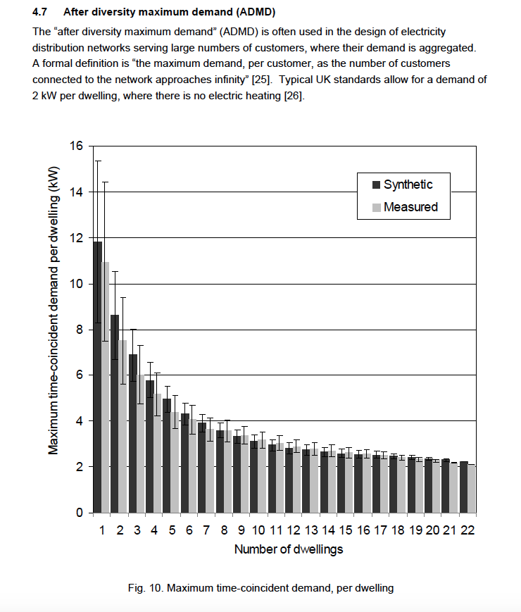

Just have a look at your consumer unit, add up the trip values of all of the MCBs/fuses. Mine adds up to nearly 200 amps. The fuse from the electricity supplier is only 100amps.
When the electricity supplier calculates the ACTUAL MEAN demand for a new housing estate, they budget on as little as 2KW (thats about 10 amps) per dwelling. If they didn't we would be over-run with power stations.
Interesting graph taken from Loughborough Uni's study on domestic energy use
https://dspace.lboro.ac.uk/dspace-jspui/bitstream/2134/6997/1/Domestic electricity demand model paper _2 00_ A.pdf
Anyways, you'll be fine, even on Christmas Day, or when on self clean, or induction hob boost mode.!
