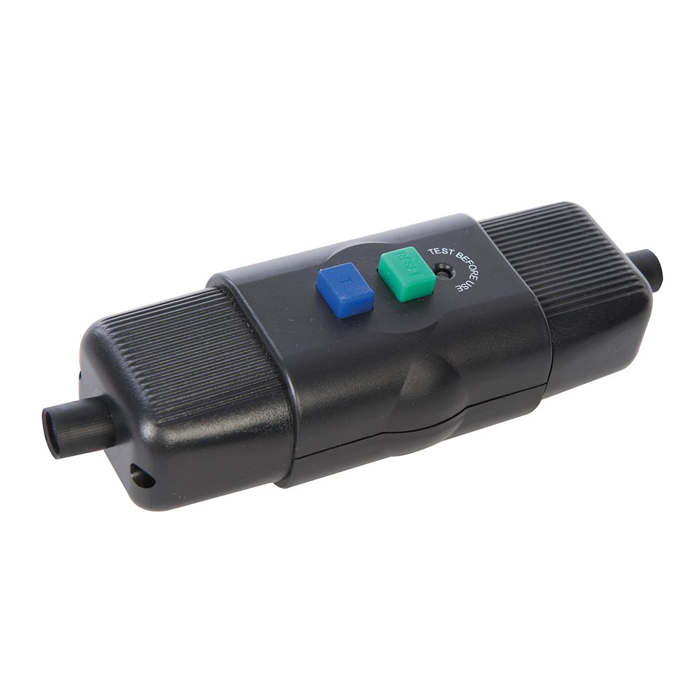

You can get in line fuses and fuse boxes, but most are designed for extra low voltage not 230 volt, there are rules on clipping cables and ensuring cables can't be pulled out of the box so be it a stuffing gland or a clamp you need some thing to secure the cable, so a Fuse connection unit in a back box could in theory be left free but I would always fix it to some thing. Odd there are loads of in-line RCD's
But you can't seem to get a MCB or fuse to use in line which is 230 volt rated.
Yes, isn't that what the OP must have seen, and had in mind, when repeatedly talking about a "standard fused switch-box", thinking they were one piece?
