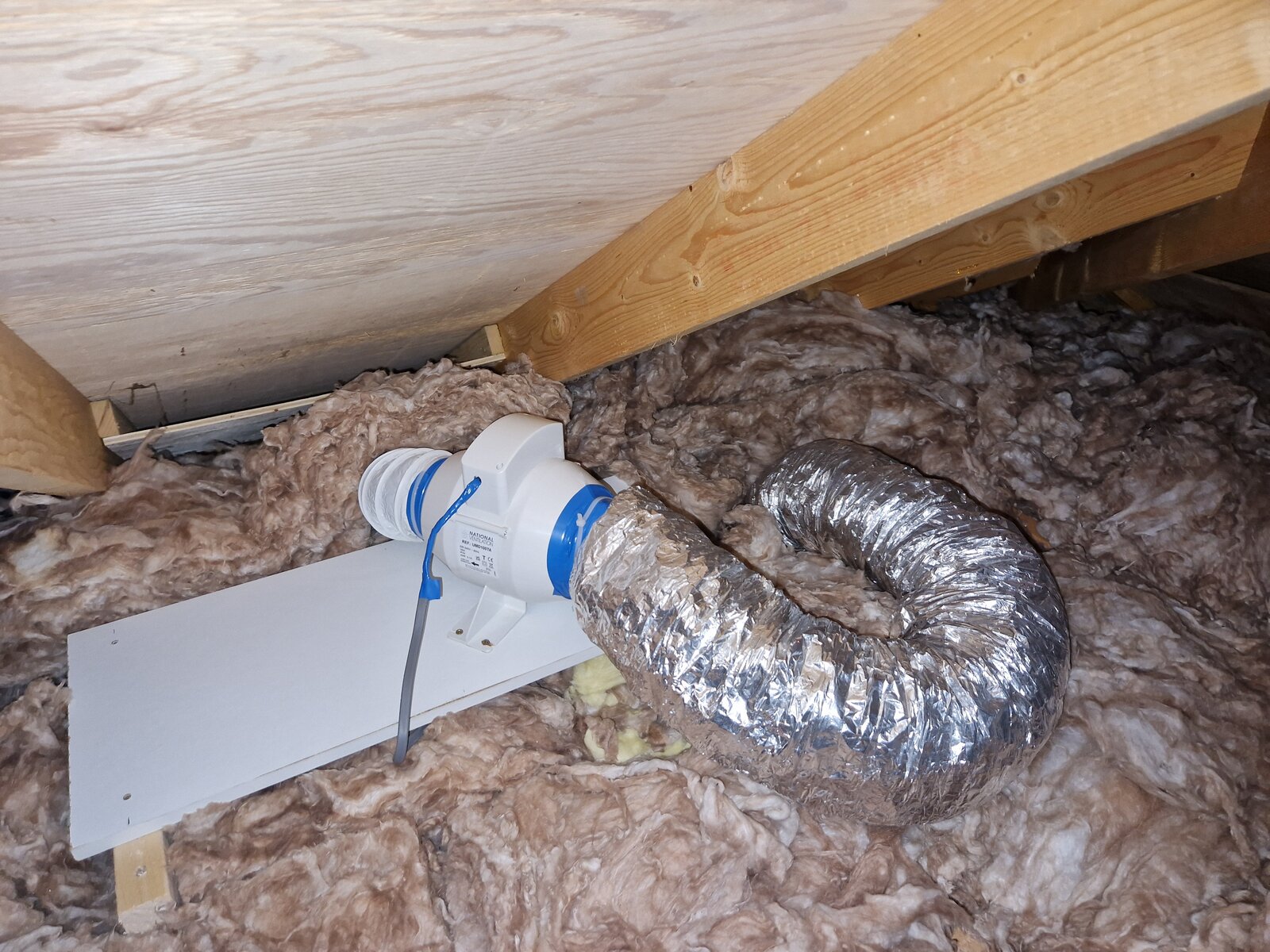

Has anyone had any issues with an inline fan leaking? I have a National Ventilation Monsoon UMD100T in my loft on a plinth. I was in the loft yesterday and noticed a pool of water beside it. The ducting connections to the fan are secure so I thought maybe there was water sitting in it. I opened it up and there was a small amount at the bottom but nothing to write home about so I screwed it back together and noticed slight drips at the 2 joins of the body casing. Not sure how long it has been going on for (i usually check it every few months). I switched the fan on & there was slow continous drips. The fan's only a year old. Just a short run of ducting at either end (insulated flexi ducting from the shower room to fan & flexi ducting out to the soffit on a slight sloping angle). I got in touch with an electrician and he said it sounds like it's not strong enough to push the water through and suggested replacing with a stronger fan that he uses (Airvent 100mm mixed flow inline fan) so he's coming out next week. It's the 1st inline fan I've had but quite surprised it's not lasted
No fault with fan just not installed with enough fall to prevent condensation run back.Run on timer needs at least 15mins?, this helps reduce condensation as more damp air is shifted after shower/bath use.
Insulating all the ducting also helps.
Yes the timer runs for an extra 15 mins after shower. Insulated ducting goes to the fan and I've covered the flexi ducting with loft insulation until it slopes to soffit but it's just a very short run. The fan sits horizontal on the plinth. Are you saying it should be at angle? Just a bit concerned that I get a new one installed and same happens

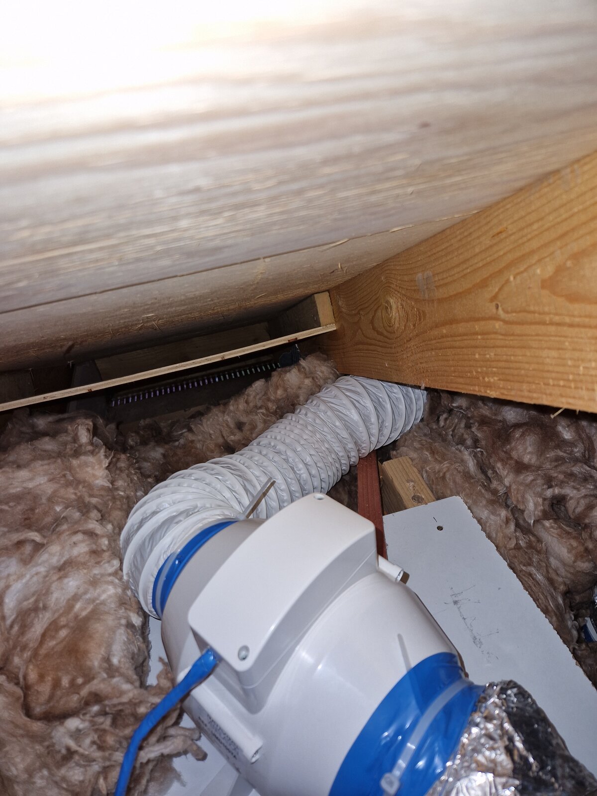

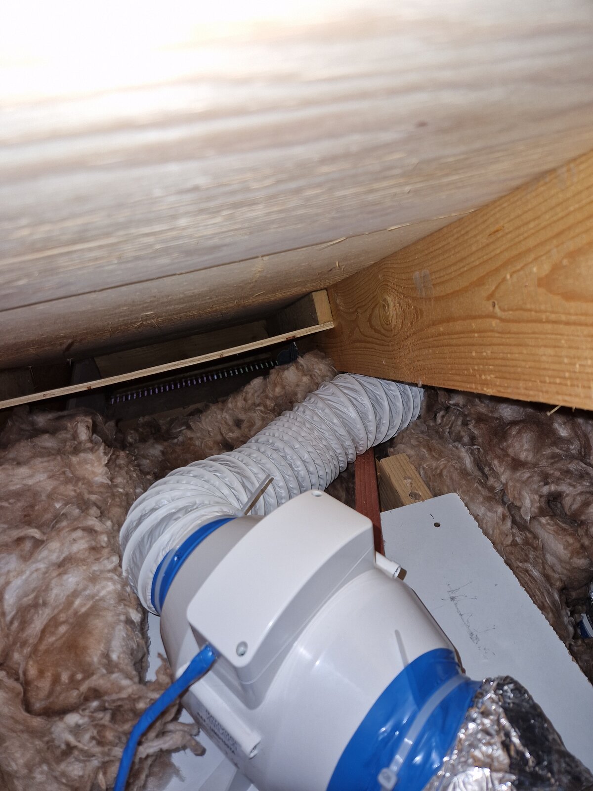

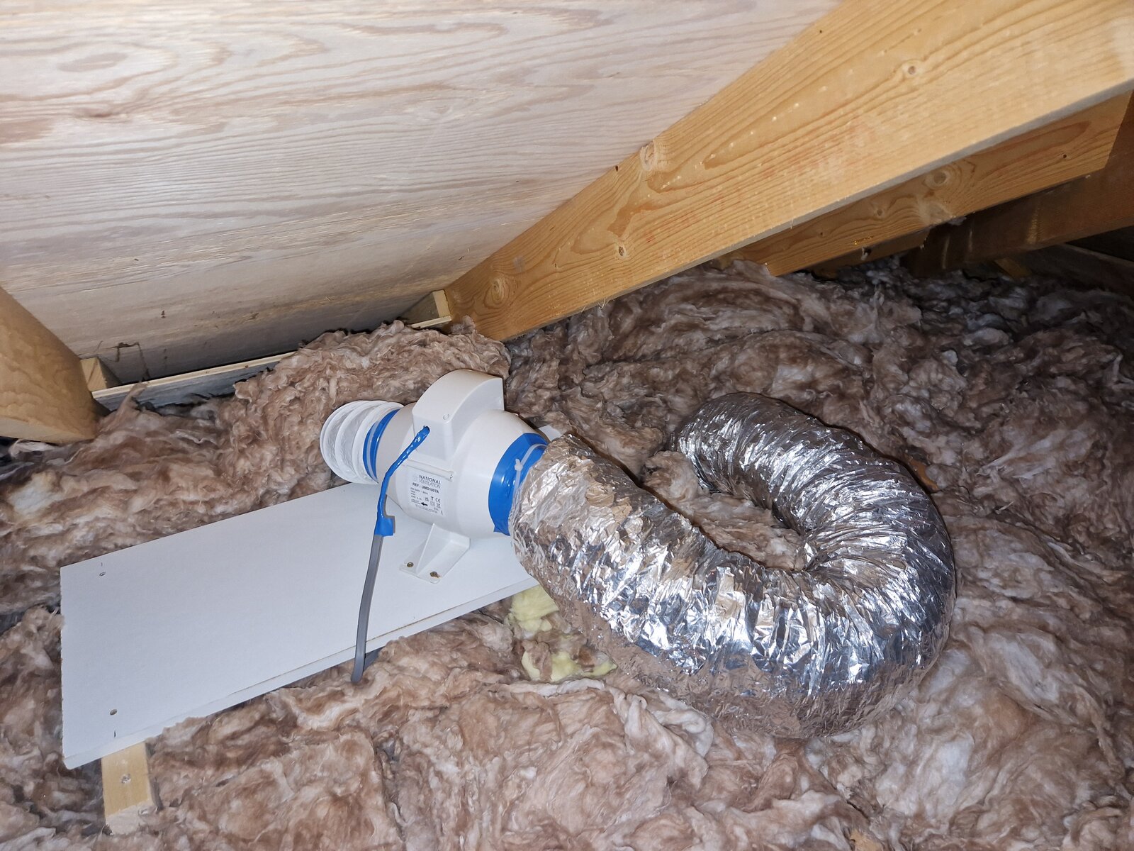

This is the existing set up. Not sure if the insulated ducting should be shorter/more direct to the fan? Note the flexi duct snakes off to a grille in soffit on the right hand side - not sure if it would be better to put another grille in to the left so it just slopes directly down from the fan?

I would put a thin layer of loft insulation over the ducting - and see how it goes. Changing the fan isn't likely to improve matters
Sorry, should have said the flexi hose usually does have the rock wool over it (as in 1st photo) - I just pulled it back for the photo. Not sure what to do now as don't want to use the fan with it leaking.
So put some insulation over the first part of the ducting - it may say its insulating - but in my experience in winter its not enough
AND increase the time the fan runs for
