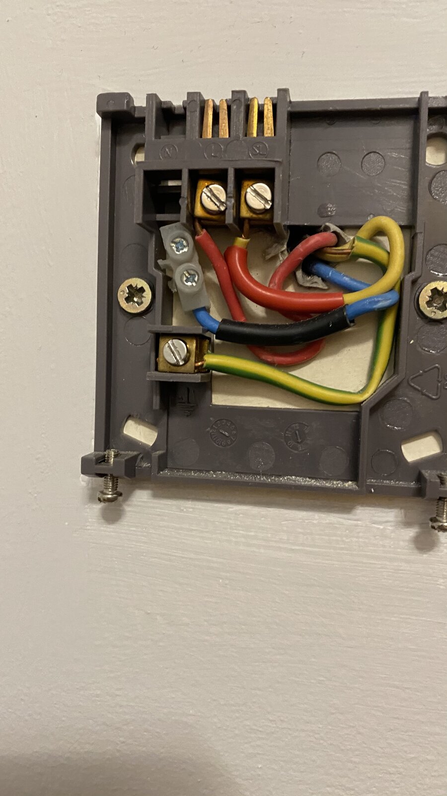

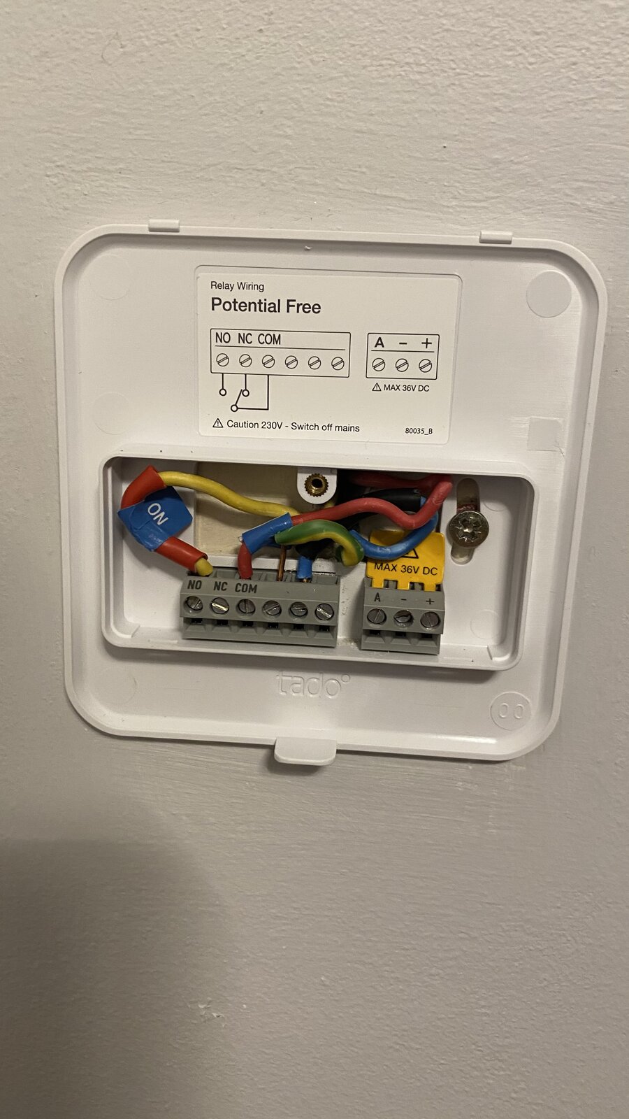

I have replaced my salus rt300 with a wired tado thermostats which I can control with my phone
I have wired as it said but when you turn the heat up the thermostat clicks but the boiler doesn’t fire up
see the attached images
hopefully someone can help

Looks ok wiring wise. What boiler is it? Have you tested the wiring? Also did it work beforehand?
It worked before hand no issues tado confirmed the wiring looked ok but just wouldn’t work so I re-wired the old thermostat and now that isn’t working either one minute it’s firing up the next it’s not
we have a baxi 100he combi boiler
we do have a little bit of a strange setup as we also have a gledhill system mate up stairs which provides all the hot water but from what I have been told the boiler is what does the heating only
I replaced the mechanical thermostat a few years ago without issues for the salus rt300 and that has worked perfectly up until this point

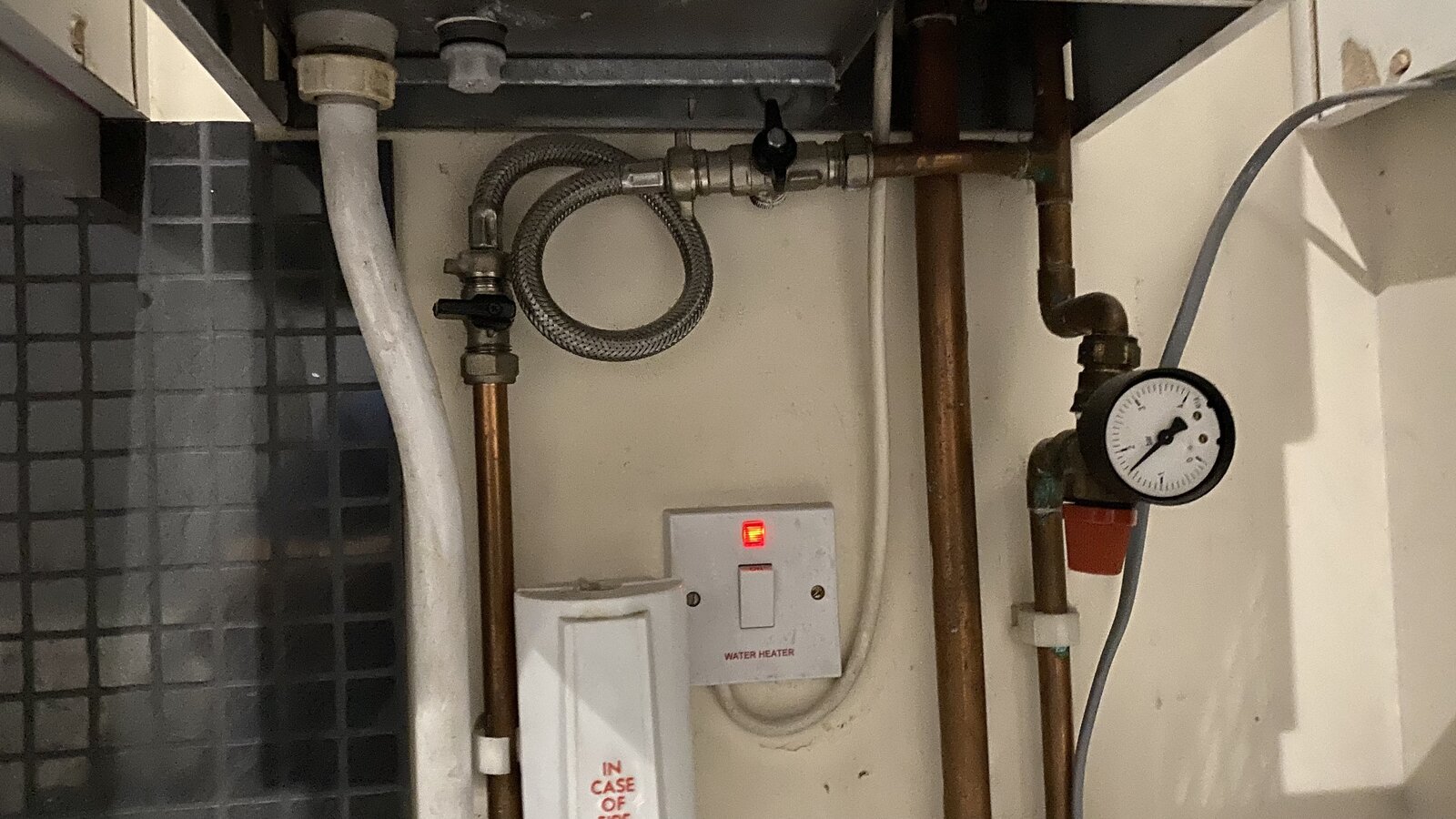

I must admit after moving the box we have around the boiler I can hear a running water sound but everything is dry

don’t think it has one the boiler is very basic
It should still have one,might be worth a check, although doubt it’s going to be that. I’d check your motorised valve.
Thanks again for your help I will find some diagrams on line and see what I can find tomorrow
it’s such a complicated system with the gledhill system for the water we have had 6 plumbers here before scratching there heads looking at each other before but the heating is the basic side of it as it’s really only a combi
thanks again
It’s not a combi - it’s a sealed heating only boiler. The other issue could be the Gledhill - but I’ve not dealt with these before.
