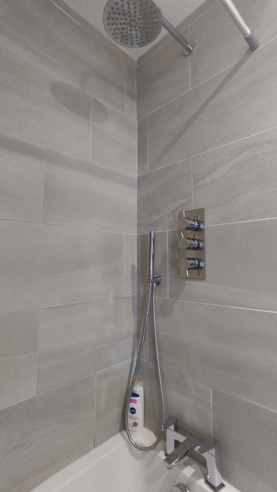

I currently have a concealed thermostatic shower (one handle to regulate flow, one handle to regulate hot/cold).

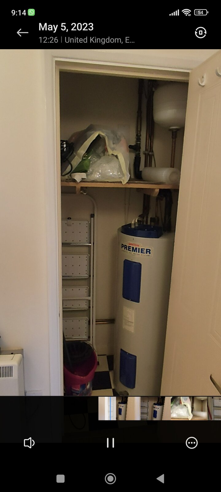

post pics of your existing HW cylinder and pipework so we can see what your existing set up is
Thanks @oldbutnotdead . @ianmcd attached is my setup. I have a loft above, that's where the pipes run. Thank you

OK so you have an unvented HW cylinder , so a unvented water heater as you suggest will work, but with that rainhead shower that you have you will be extremely dissapointed with the outcome, the flow rate will be extremely poor, I wouldnt advise doing it to be honest, you say you are having problems with the existing cylinder, what exactly is the problem with it ? they are usually pretty reliable and a far better set up than what you are planning to replace it with
Thanks, I would easily replace that showerhead with one that would improve the flow - assuming these exist.

The current tank doesn't really work (bad insulation) but most of all I want to get rid of it to create space. Also I like to have hot water on demand rather than heating it and storing it as I may not use all that much.
You'd have to ditch that rainhead showerhead, max flow from a 12kw flash heater will just sort of dribble out of it. The handheld head on the flexi- yes you could swap that easily enough.

Don't do it, as suggested you will extremely disappointed with the outcome, you really will be dancing about the shower trying to get wet. Also the thermovalve will struggle with dealing with such a low inlet temp on the hot side, they really are designed to work properly when mixing reasonable volumes on hot and cold, you couldn't be sure how it would behave. Thermovalves can be tempramental when not working the way they're designed. Not to mention how restrictive that concealed shower may be to flow.

The cylinder you have isn't that bad TBH, the Santons are an ok bit of kit, even the old ones.
