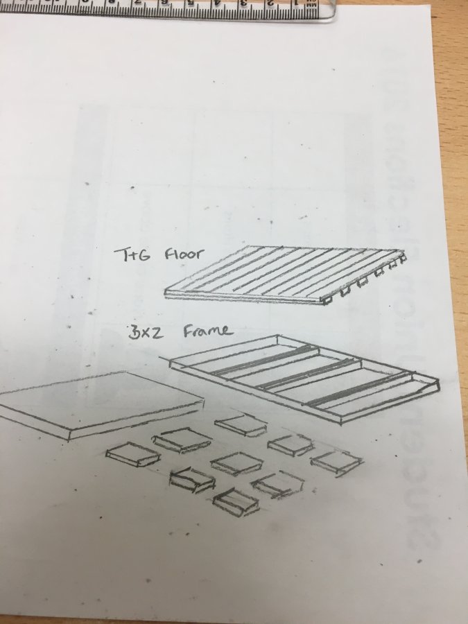

Hi,
I have had a little snoop around the web but haven't found what I am after.
I have a 8x12 shed on order which has a T+G floor.
I have made a timber frame for it to sit on out of 3x2 which is sitting on concrete piers and over the old small concrete slab.
The shed will be mostly to store tools and be used as a little workshop, so I would like to future proof it buy insulating the floor when I install it. Then likely insulate and heat the inside in the future. I don't really want to take away headroom with a floating floor inside. The way I see it I have the following options / problems:
Flip the T+G floor over and insulate between the joists (will likely be thin) or pin bubble wrap etc over the joists. Both would leave the ends open? would these need to be closed to create a sealed air gap?
Put insulation between the timber frame joists sitting it on batons. Again when the pre fab floor sits on top it will leave a gap and the edges are exposed surely this would reduce its effectiveness. Also do you need to board out / membrane the underside of the joists to stop, bugs / animals using the insulation? The videos I have seen seemed to leave polystyrene underneath open and board on top for the floor?
any help advice would be appreciated.

Its hard to envisage the exact setup you have regarding your 3x2 and piers but the general principle is you want the insulation absolutely tight against the underside of the flooring. The underside of the insulation can be left open. Its essential not to leave a void between the insulation and the floor or you will create the possibility of condensation in this gap.
You could raise your 3x2 and put 100mm insulation onto the concrete so to fill in the void under the shed.
Excuse the bad sketch but this roughly shows:
Piers added to existing concrete slab.
3x2 frame sitting on top of those
T+G prefab shed floor on top of that
So the only way to have it tight to the shed floor would be to insulate between the t+g floor battons.

If I use Celotex I would still have an air gap when the T+G sits on top? that's what I cant get my head around, Unless I celotex between the T+G floor joists as well as between the 3X2?
Why dont you put it between the T&G floor joists first before you put it down on the 3x2 if you cut it so its a tight fit it should stay there till you put the floor down, i,ve just been using recticel in studing if you put it in tight you cant get it back out without damage.
