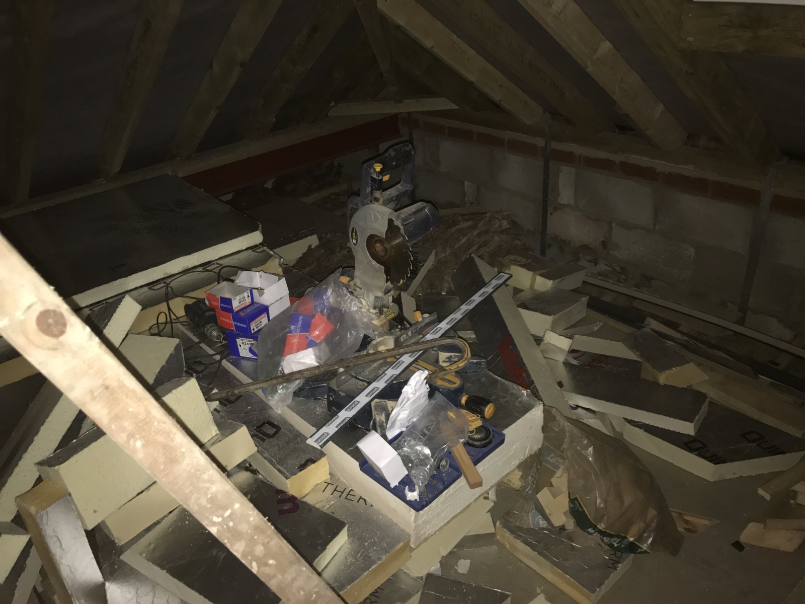

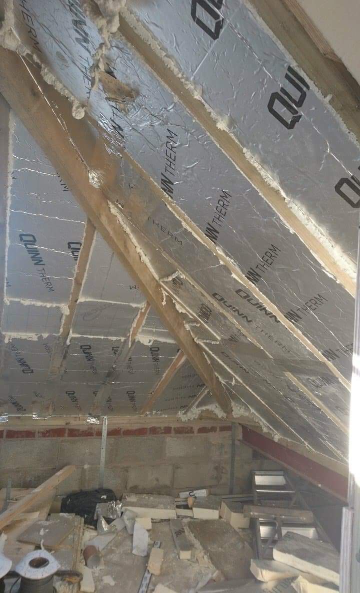

if I overboard the rafters with 50mm PIR my hips will stick out into the room.
How would you do it?
The op could calculate the u value at that crisp junction and see if it's safe to board directly.
Also, I think your current approach is working well : cover the floor with so much cr*p that no one notices that the hip is sticking out!
No idea where crisp came from! I meant critical.He isn't that clever It's got 75mm between the rafters which I cut with (I think they call it) a 'compound mitre plumb cut' so it fitted tight and parallel with the hip, then I foamed it.
I'll see what thinkness I need to cover it and see how that affects the room. I dealt I want as thin as possible insulation on the right because that affects the door too.
