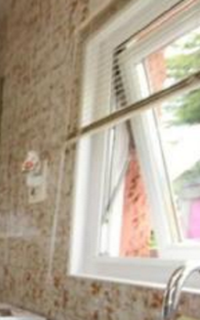

How thick is the single block?
Does this photo help?
