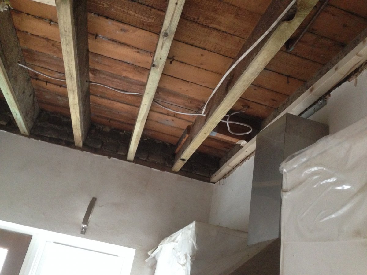

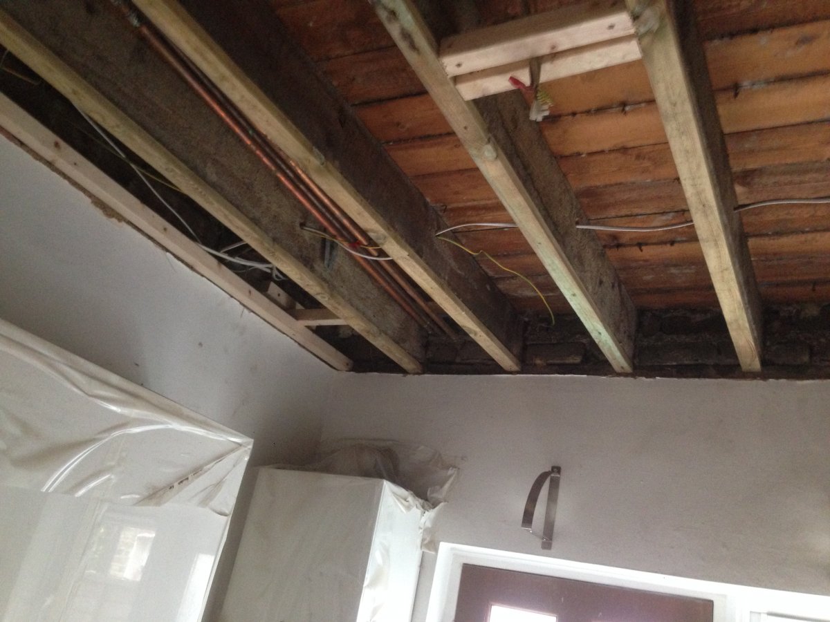

Insulation around pipes and electrical cables in ceiling cavity

Apply rockwool from below, don't wrap any power cables.Leaving air gap above rockwool.
