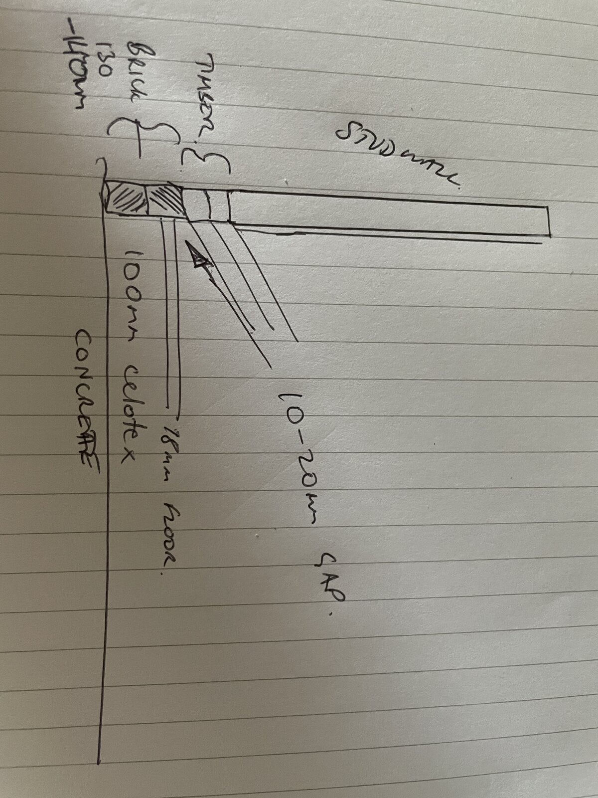

I’m building a garden room and have got my levels a bit off.
The wall is two courses brickwork (around 140mm) then wall plate stud etc
I’m planning 100mm insulation and 18mm flooring on top of the concrete base as a floating floor. this leaves me 10-20mm short of the timber wall plate. Hence I’ll be mounting the skirting 10-20mm over the brick.
I’m concerned this will create a draught with no means to insulate. Apart from raising the insulation up (can’t due to doorway). Any ideas?
I’ve done a basic diagram but hopefully you get the idea.

Why not put 25mm Kingspan internally to floor level before applying finishes?
Ideally you’d have the insulation meet the floor insulation to stop the cold bridge at the slab edge.
10mm UFH insulation below wall finishes (or to match thickness of wall finishes), hidden by skirting?
Yep might work, so stop the plasterboard say 10mm under the skirting and then use 140mm of 12.5mm celotex in place of plasterboard to floor. (Assuming 150mm skirting).
