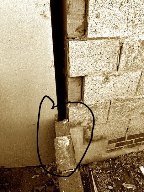

One more question/concern, In the front of the house, the gap between my wall and their new wall is blocked by the existing driveway separation brick wall( as seen in the attached picture. So if the rainwater goes in between these 2 walls, how the collected/stagnated water would go out? Do I need to speak with them to vent this water. ?

It's not a waterproof tank, water does not collect or stagnate.
meant like 'If there is no actual out for water, would it not get into my house's wall over time'. Asking this with a bit of worry and limited knowledge of buildings
What happened to your wall before the neighbour's wall was built in front of it? If it didn't have a damp problem then, it won't now.
They had their garage and my wall was built very adjacent to that with no gap. Now, they are extending their garage with gap.
