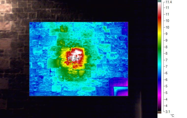

Hi,
I have been looking to create a solution to this exact problem. We are still in testing phase however I have managed to reduce the thermal bridge by 50% and the composite panel I have made is only 13mm thick. I will share more info as and when I am able. Also looking at slightly thicker options in order to provide various routed patterns in the panel that will mimic stone or brick. The problem is definitely real as my wall shows!
Hi Paris,
That's very similar to what I see on the outside, although I dont have a thermal image I used an IR thermometer last winter and and the full section of wall behind the fireplace was a good few degrees higher than the rest of the wall.
