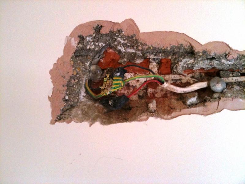

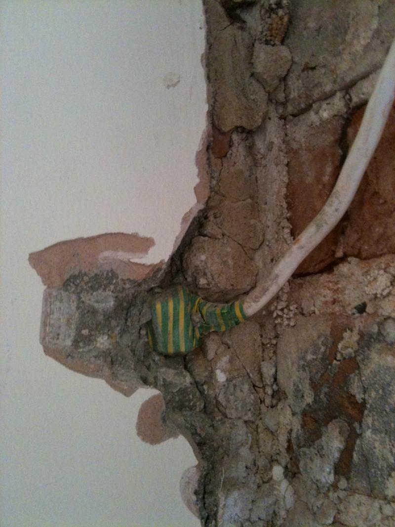

Fault finding is a combination of Sherlock Holmes detective work and (often) luck.
The issue is that electrical circuits may have been installed and tested to be 100%. But subsequent work by sundry trades can add some very confusing items to a circuit.
Typical examples. Splitting a circuit often doesn’t butter any parsnips. As above, there’s no template, it’s all down to experience.
The process that you have outlined isn’t wrong. It might work. The only way to find out us to try it yourself.
